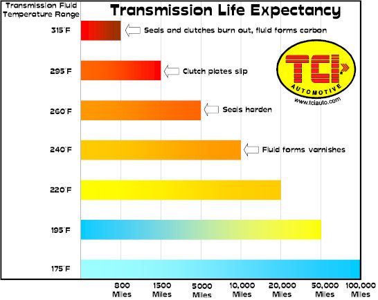

I am running hard lines for transmission cooling to the radiator. It appears that the connections on my radiator are set up for 3/16 line. The 700R4 appears to be set up the same. Anybody running 3/16 size line for transmission cooling to the radiator?
If you use a separate cooler, the lines will be much shorter and easier to fabricate. It
also has the added bonus of reducing the load on the radiator allowing the engine to
run cooler. I'm running 1/2" or -8 AN lines to my cooler. Ideally you want the
transmission fluid to run about 175° F.
TCI Transmission Life Expectancy
