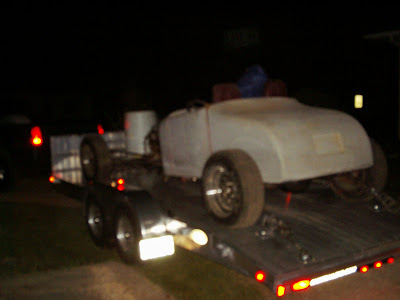

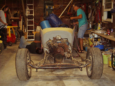

Its Here!!
Let me give you a hand. Using HTML won't work.

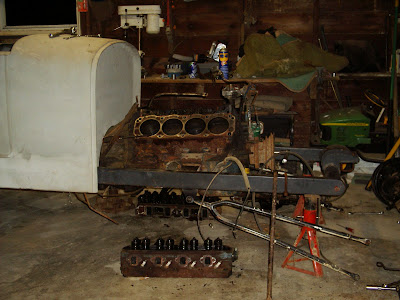

I tore down the engine and front suspension the next day. The first day was looking through all the boxes of parts!!
Looks and sounds like Christmas in August! Let the fun begin! That's a great start.

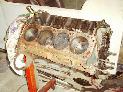

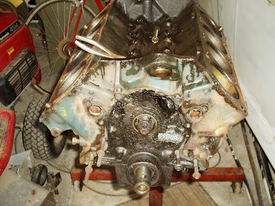

Here's an update: I have the motor tore down and it looks great! Now its time for paint prep.
First problem found...
A crack in the bottom of the trans!
Here's an update:
I decided to tear down the motor completly and have it hot tanked, and bored so off to the machine shop it goes.
Sorry fuzzy pic.

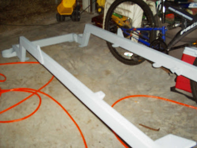

The frame has been sanded and is ready for the first coat!

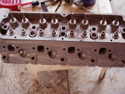

I spent alot of time on the heads, cant afford a new set so Im going to rebuild this set.
Won't be long now!
