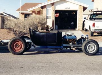

We used the paralell springs off an old Toyota on John Jr's car. It has a long bed with the gas tank behind the rear end
this is an early pic whithout the bed bits:D
so far it seems to work:eek:

jmr, yours would look just to cool if you put a turtle deck on it too. i have always liked the turtle decks on the '23 t's but, i don't think they look as good when the rear end is to far up to the body, as if it had a pickup box instead. to explain that better, like an altered '23 T drag car. as you know, the body gets cut out for the narrowed rear end tires.
