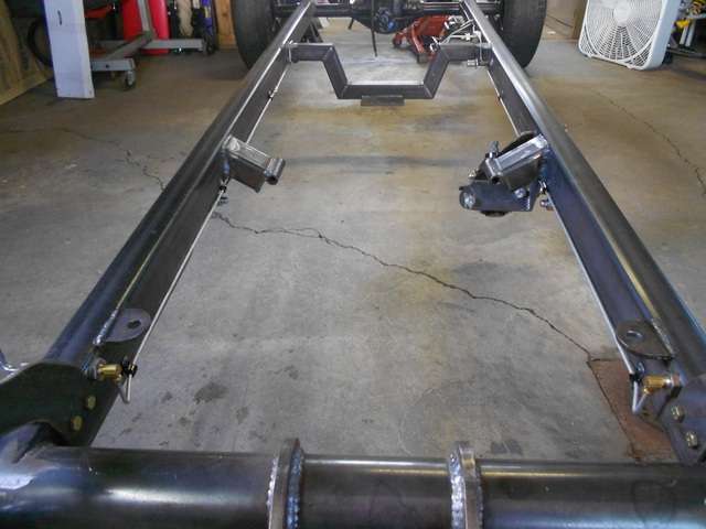

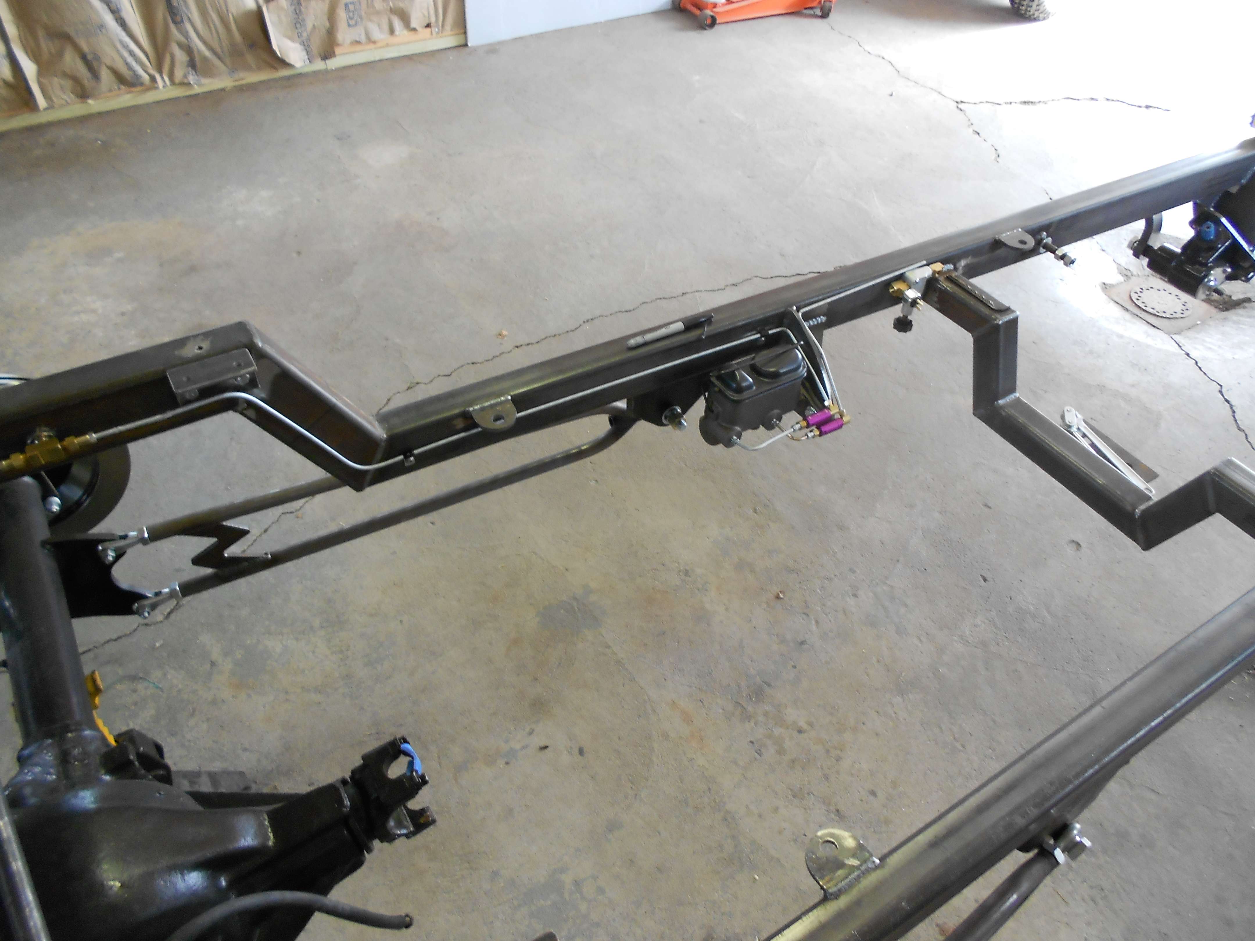

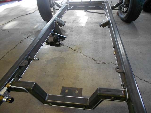

So he can have them chromed, and use some stainless button head bolts. They could also be welded on.Mike, I'm curious why you wouldn't weld those shock mounts?
I wasn't questioning your engineering or the strength, I just think it would look cleaner welded. But not having a welder is reason enough for me!I don't have a welder is one reason plus they can be easily removed if needed. Others with this same setup have them bolted on also with no issues. With 4 grade 8 bolts holding each mount on I think it should be plenty strong enough.
You mean like this?So he can have them chromed, and use some stainless button head bolts. They could also be welded on.
I wasn't questioning your engineering or the strength, I just think it would look cleaner welded. But not having a welder is reason enough for me!![]()
Mike, you did tap and use fine threaded bolts right?

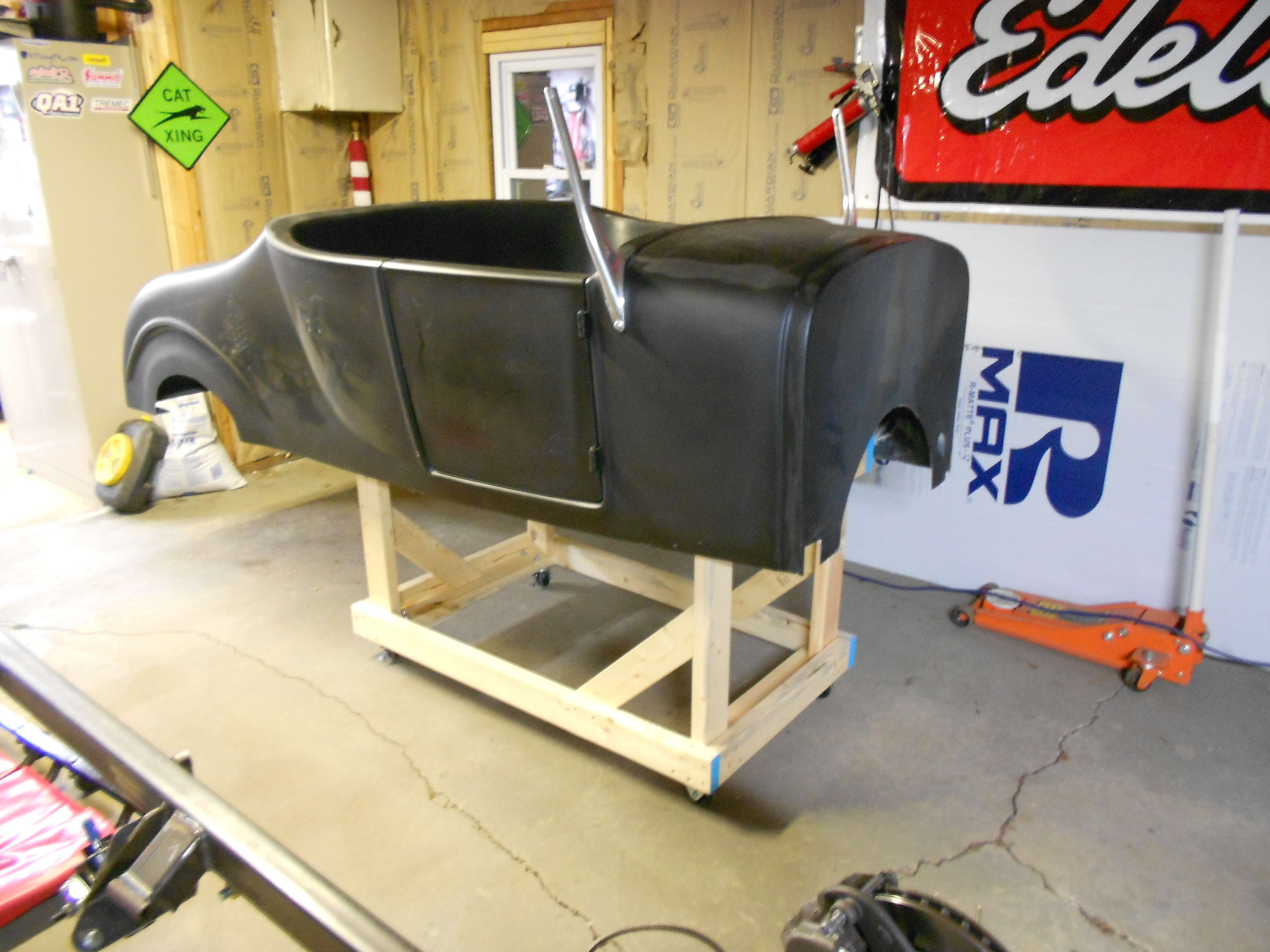

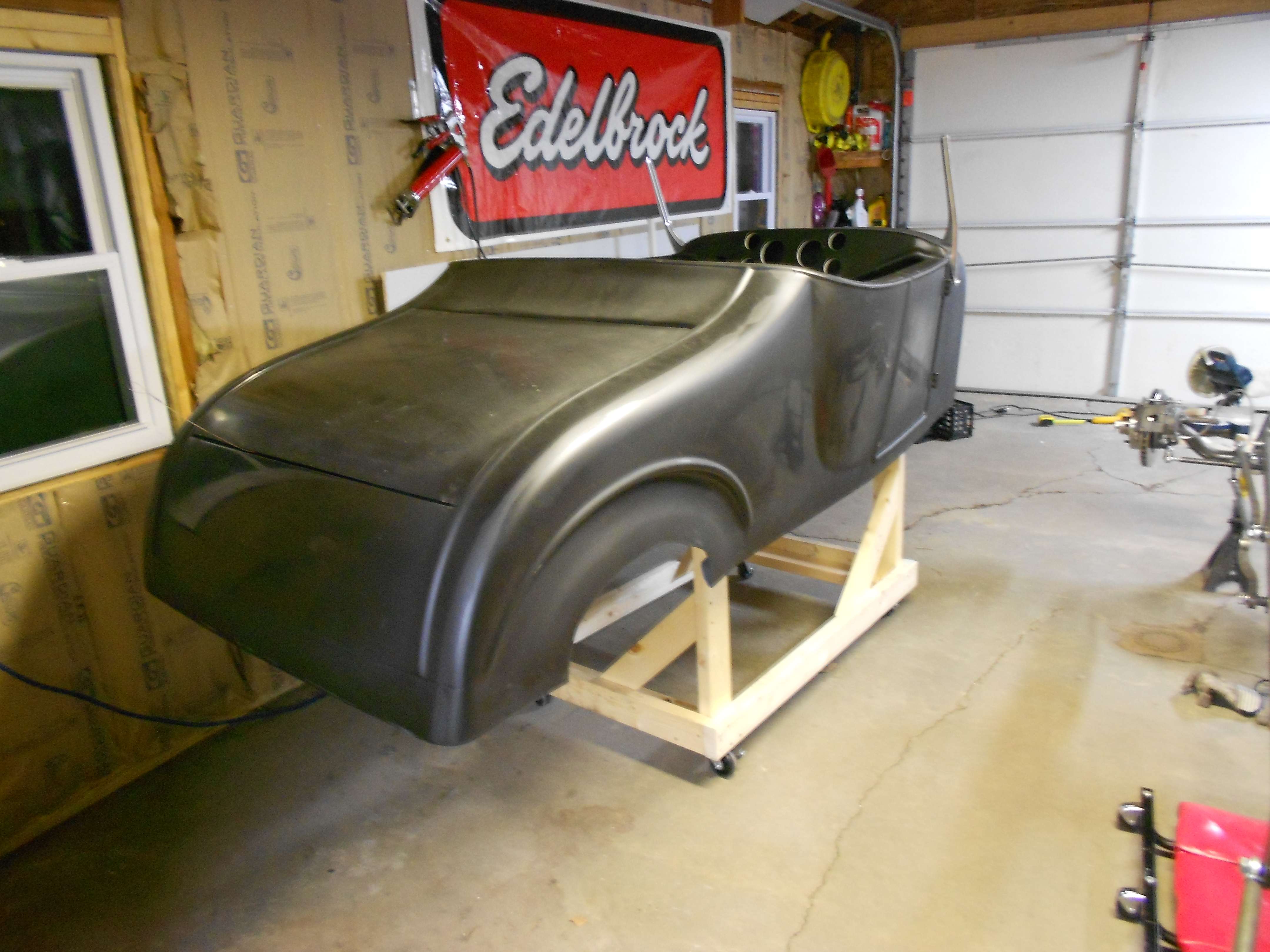

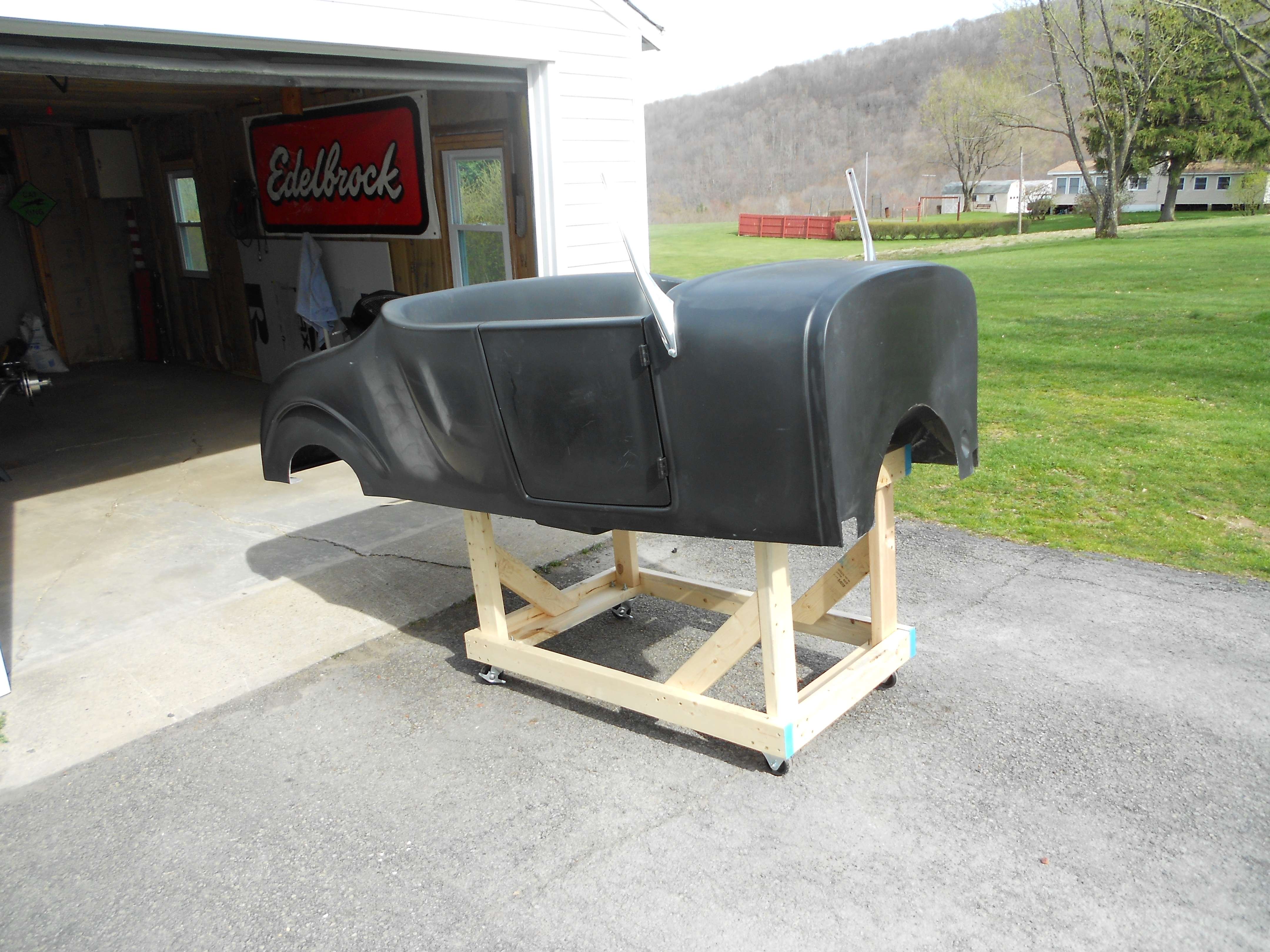

Leaving your body set in the sun is a very good idea. If the body was freash when you got it, it will finish curing.
