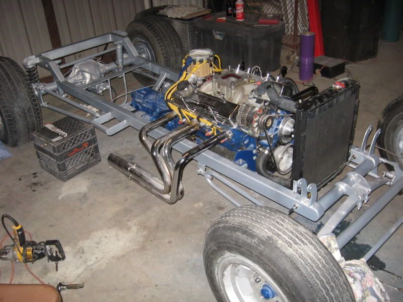

Hello everyone. I am new to this forum and to building a t bucket. I bought one that is half finished. I will have a lot of questions as i build it. Where would be the best place to put the shocks on rear with coil springs? Any pictures of this setup?

through the middle of the coil spring is one option, or if you want to angle them a little bit for a bit better roll stability, cut off a set of shock mounts in the junkyard and mount them to the bottom of the rear under the shock and tilt them inwards by about 15 degrees.
