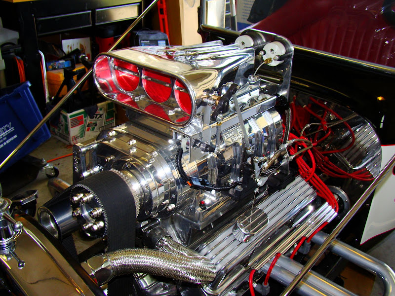

The USB cable came from Accel and is shielded, plus I added Ferrite blocks to each end.
the heads I'm considering are the Air Flow Research 195's with the 65cc Chambers. They come highly recommended.
Dawm....that motor looks purty!!!! :spy:
Note the Gauges, One is for Fuel Pressure, the other is for Vacuum\Boost. Fuel pressure is set at 45psi per Accel instructions. Vacuum was 12-15 when the carbs were on it.
