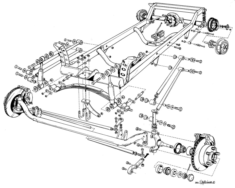

Guys.. Does any one know what the measurments are for mounting the brackets to my rear end using coil overs? i used all of ron popes stuff?
You might have the radious rod brackets on the rear end turned upside down. Having the strait bar high like that might give you body issues. Most all kits sold have the top bar of the hairpin inline with the rear end axle tube.
