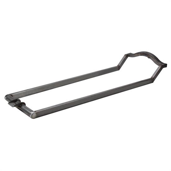

I'm liking the Speedway Tribute frame because of the model A rear "buggy" spring, must have it, seems no one else offers this. I'm kinda bummed because I prefer thicker than 1/8" steel for the frame rails.
.You are building a 2,000 lb. car not a bulldozer.

Red arrows pointing at pictures."This frame uses a Model A rear crossmember and has a higher rear kick-up than our other frames. It would typically be used with a spring-behind axle having 6" drop and our High Arch rear spring."
4" drop axle with transverse spring mounted behind it. Typical of most T-Buckets
Model A rear cross member
Talking about the front axle that has a 6" drop and the front spring mounted behind the front axle.
Most front axles are 4" drop.
The model A rear cross member is arched up instead of the usual flat cross member for the rear of frame.

Most used rear cross member for a T-Bucket.
The perch was made higher to accommodate the 4" axle on this kit.
Model A spring mounting behind the rear end.
I took a measure to it and it is a 4" drop.Red arrows pointing at pictures.
I'm confused by one thing, here's the quote. "This frame uses a Model A rear crossmember and has a higher rear kick-up than our other frames. It would typically be used with a spring-behind axle having 6" drop and our High Arch rear spring." What confuses me is the statement that the spring is "typically used behind behind the axle". I'm going with a 9" or possibly a ten bolt used unit btw. If I did that, spring behind the diff, the diff would be hitting the body? So I'm wondering how it can even work. Spring on top is not a problem and the obvious fix, use the medium I guess. I tried, I cannot find one build using this frame anywhere.
So your question (as I understand it) is, will the buggy spring work with the "Traditional" frame and a 9" rear end without a bunch of surgery? I'll bet someone at Speedway can answer that question.
