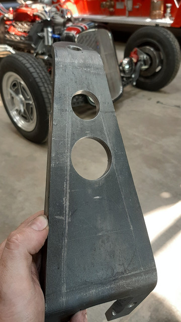

Drilled some "Speed Holes" in my home made steering arm. Helped blend the piece into the rest of the car.

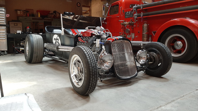

With the headlights off of the steering arms I've been experimenting with different headlight styles and mounting:
Small diameter Grote Per-Lux 200's
Even moved them behind the grill as an experiment... Big nope.
Despite that the small lights are cool, and actually do suit the entire car. They just didn't have the same presence and feel as the big lights.
With the big headlights mounted off the grill they do look good enough, but it's tight to the steering. I predict that steering arm will contact the headlight at sometime under certain curbs, driveways & driving conditions. But for now, I'll run them like this until it is a problem.
I am also considering adding those Per-Lux 200's back behind the grill as amber driving lights.

Ooowww, I like the small lights down low and outside the grill ! Although they won't be as effective
down low. I read somewhere that a headlight should be at least 24 inches off the ground.
Using Guitar Amp power jewel lights as indicators, just mounted two green jewels to flash with turn signals. I have red & yellow jewels on order for Nitrous Active and 2 Step Active. Other then the Start light above the Start button that I have active with the pin 87a of the fuel pump relay (so it turns off when fuel pump is on during prime pulse and while engine is running) I can't think of anything else I'll need an lighted indicator for.
Getting it titled in OK. wouldn't be a problem. The police would be the only problem. I doubt they would stop you for it but,,,,if you get stopped for something else, they may wanna nit pick a little. I would just go for it. Heck I always thought it meant 24 inches to the top of the headlight.

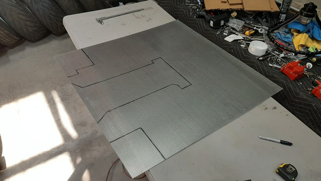

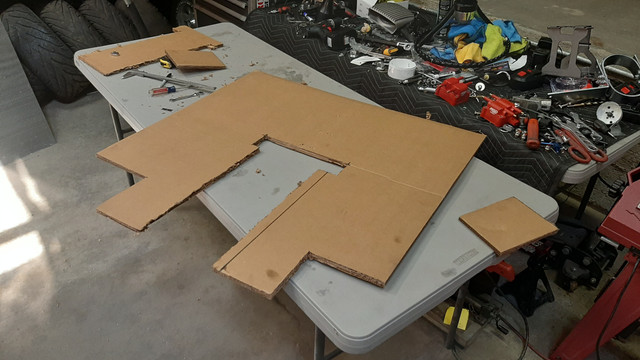

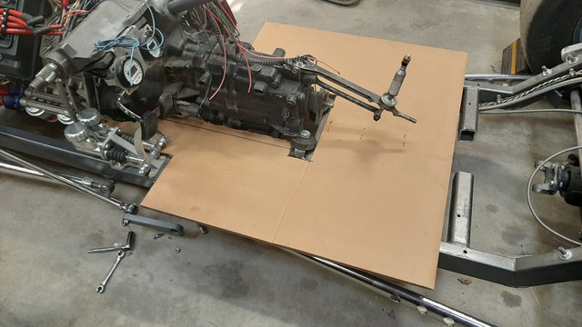

Also started making a floor:

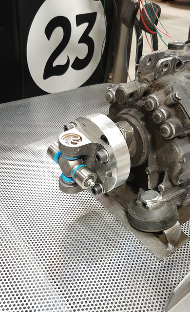

Got the BMW transmission adapter to U-joint & flange for a 1310 Ujoint, now I can measure for and order a driveshaft to be made.
