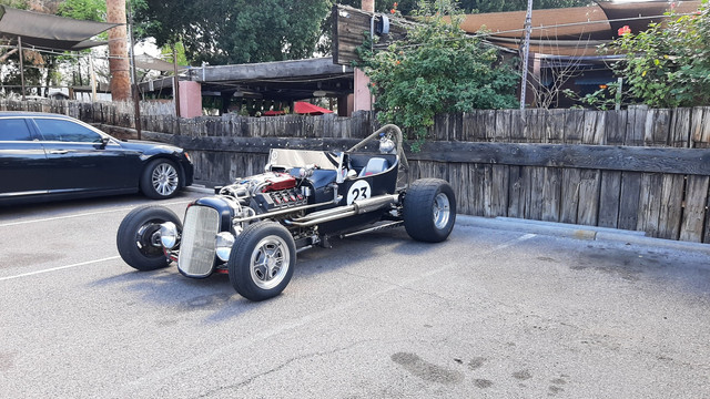

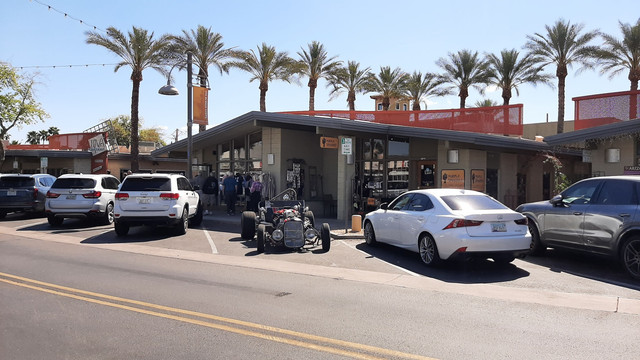

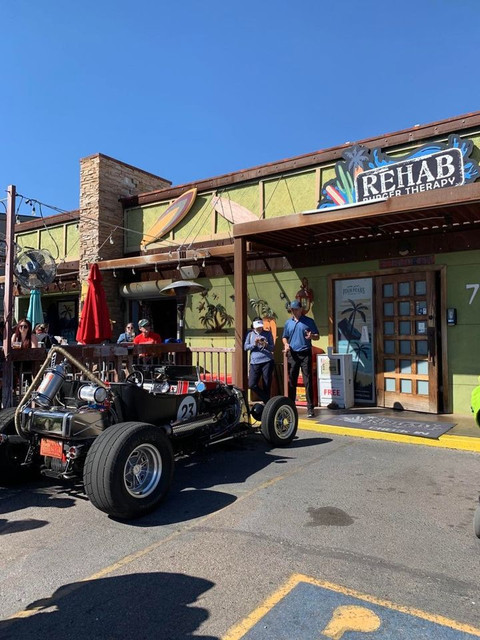

Had an opportunity to get out of my town for a weekend, loaded up the bucket and took it with me. Cruised it to some of my favorite spots around Tempe & Scottsdale. Really had a killer weekend.
I'm slowly convincing myself to add a shorty T truck bed around the fuel tank.
I call the full length headers and mufflers my "Quiet Pipes" and the Zoomies the "Loud Pipes" Although they truly are just loud pipes and louder pipes. I felt running the zoomies on the street may be the tipping point for a police officer to pull me over, it makes the drive a bit more stressful. More exciting, but more stressful. With the quiet pipes on it's not nearly as much of a stressful drive.
I do need to re-make my zoomies, and I will at some point in time. But for now the quiet pipes are serving their purpose.
