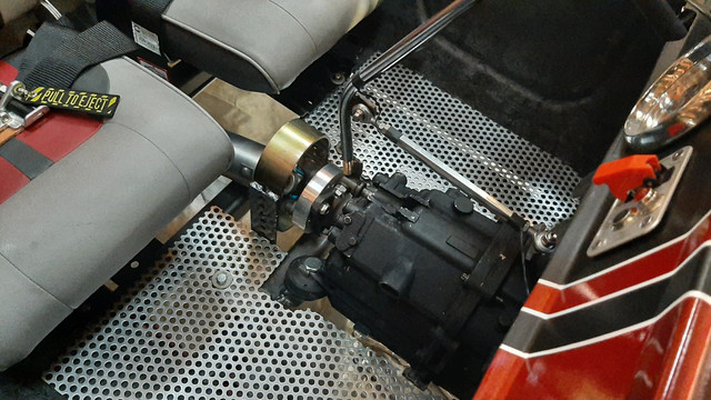

Addressed the majority of the things that just didn't jive on the test drives.
Relocated and redesigned the shifter. Not only does the tall shifter help clear my legs it also puts my hand above the steering wheel to clear that too. Speaking of steering wheel, I had to go drastically smaller diameter. From the corvair 16.5" steering wheel to a 12.5" wheel. Luckily the steering leverage is still to my advantage.
Added a 2nd driveshaft safety loop over the front U-joint:
Seats and belts are solid mounted to the frame. Still need to figure out what to do for an "interior" covering the inside of the fiberglass:
