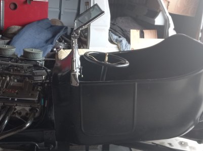

I've been on this site for a while reading past threads and have gotten a lot of helpful information of it so I figured I would start a build thread. When I purchased the car the previous owner was going in more of a rat rod tractor themed car but i was able to see past that and luckily got it for a low price. My plan has been to make it similar to dirt track roadsters from the 40s and 50s.
20180708_121637-jpg.1715983984
Yup thats the exhaust with a rain flap that conveniently was about face height haha. The suspension needed to be redone as he had quarter ellipticals up front and a cateliver style in rear but he mounted all the springs arched up like a smile to get the car lower which resulted in the weight of the car working with the springs rather than against. The car now has quarter elliptical springs front and rear and the mounts have a bolt to adjust ride height slightly but only plan to raise the front when running on dirt tracks. I also re wired the car completely as i didn't trust what was there and the P.O. used switches that weren't not meant for automotive use.
Another issue was the P.O. used a mishimoto radiator that was meant for a honda civic in order to fit it into the Case tractor grill and it was not enough to cool the slant six. After looking up many threads on here and slantsix dot org on how to clean and flush the block I did several flushes, soaks, scrapping and vacuuming from the freeze plugs and got the block running clean but will still be running a piece of screen. Then I had a friend and I modified an aluminum radiator intended for a 65 mustang to fit into a 1917 Dodge Brothers grill shell I picked up at Hershey.
roadster-png.1715983992
img_20220911_155626317-jpg.1715983995
It turned out really well and made the car look a lot better and seems to be cooling it a lot better as well.

I've heard about that stuff but wanted to solve the actual problem and so far it has worked well with just water or just antifreeze. I have to switch out to just water in the summer because of track requirements. The current radiator is an aluminum V8 mustang radiator which has greatly increased the cooling capacity. After cleaning the block cooking passages and flushing that has reduced the amount of crud heading towards to radiator. I also put in some stainless steel mesh to catch any remaining bits before it reaches the radiator. I also have an electric fan that I can turn on or off and that has helped while in the staging lanes.
