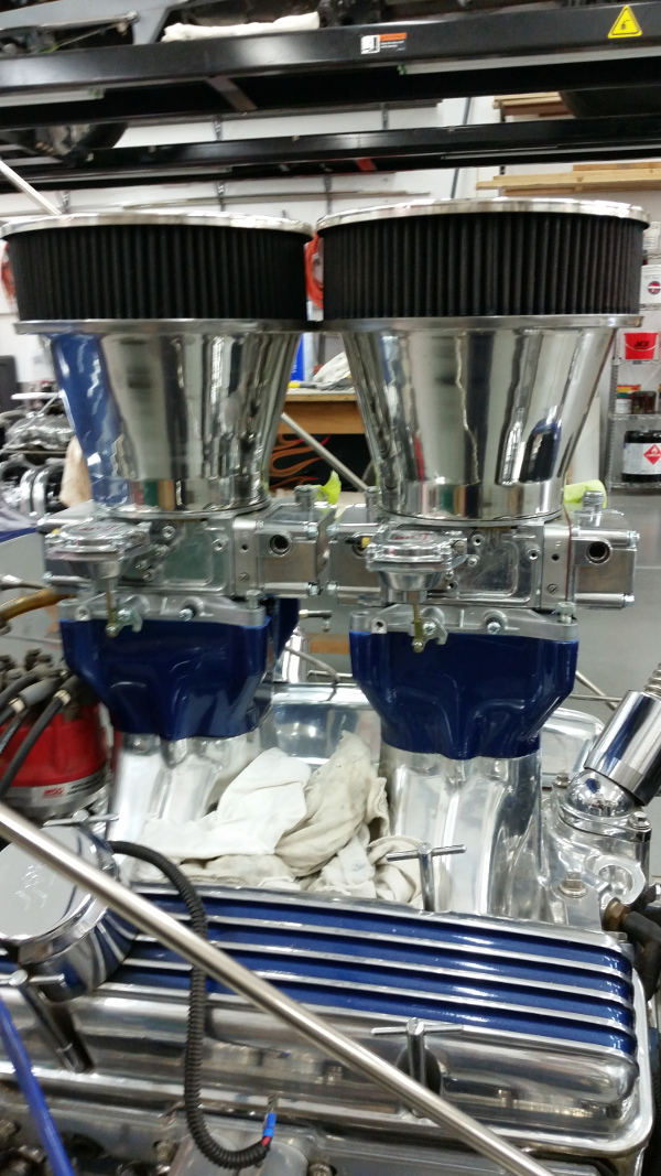

Here's what I hope will be the hot setup. Notice there is no giant plenum between the two carbs, each one handles only 4 cylinders. I don't have the linkage or fuel lines hooked up yet, so I don't know exactly how it will work.
looks awesome.
I was planning the same thing in black and semi polished.
What is your intake part # and distributor part #
There was a fella on here a couple years ago [I think from florida] that used 1 of those "divorced" plenum TR's , from what he reported , it ran well but was big bucks..reports I've read say it runs out of steam at about 5K rpm....guess it depends on what you want :thumbsdown: My "plain ol' "edel. street TR w/basically "out of the box 450 holleys runs well , pulls to 6200 , engine is a 10.4:1 388" stroker motor , gets 16.5 mpg avg , city/highway...I'm happy ..
dave
409T, do you have any pics of the individual plenums? looking down from the carb and up from the manifold base ?
I believe that the manifold, plenums,and carbs come as a kit and probably runs close to $2000.00.
AmIright ?
John
Yes, it is the Real Street Ram kit. I already had the manifold so I didn't have to buy the whole kit, just the two upper pieces and the carbs. My existing manifold bottom came from a Weiand, I think it was called a Street Tunnel Ram.
