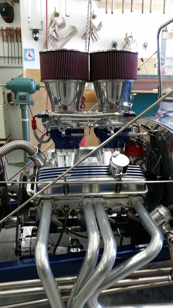

409T, do you have any pics of the individual plenums? looking down from the carb and up from the manifold base ?
I believe that the manifold, plenums,and carbs come as a kit and probably runs close to $2000.00.

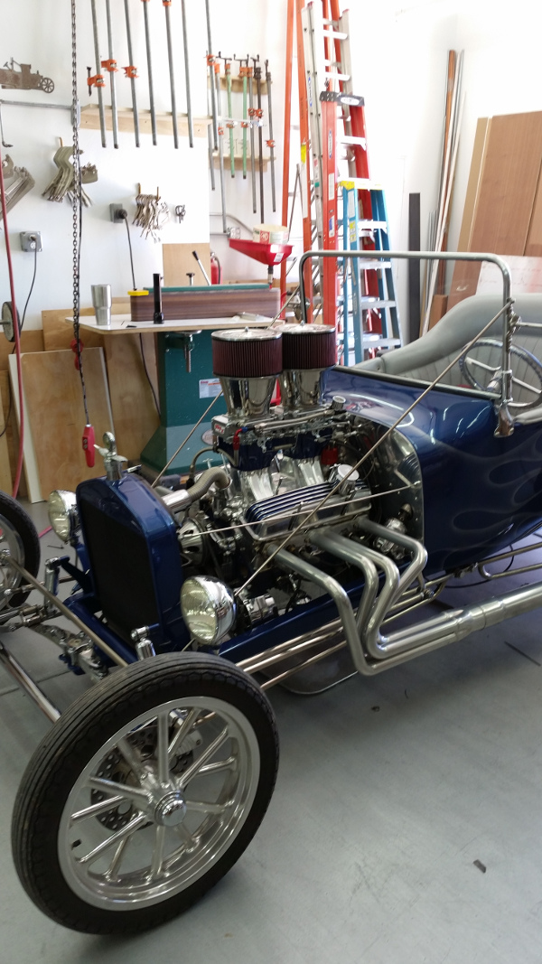

I bought mine mainly due to the 427, but I love a hi rev small lock in a light car! I have a couple old 283 and 327 in storage with goodies for just such a project, some day, lol.We go on a long cruise about once a month, I'll have the opportunity to check mileage then. For the moment it can't be too good, I've had a little bit of lead in my shoe. The engine is a 350 2 bolt main block with a 3.25" stroke crank, 9:1 compression, .465 lift 224 degree duration @.050 cam. Nothing special. I have always believed that a shorter stroke engine is better for these light weight cars. If I had it to do all over again I would build a blown 302.
MSD, no vacuum advance.409T what distributor are you using in that setup for clearance ?
Yep.I learned the carb spacing is 8 7/8".
