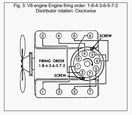

Also, make sure you don't have a crazy cam with a altered firing order. you should be 1-8-4-3-6-5-7-2 in the correct rotation. Remember, from # 1 plugwire, 8-4-3-6-5-7-2,-in the correct distr. rotation-, TDC, Balance tab set close to 0, both valves completely closed, on the heel of the cam. It should bust off....

The firing order represents what I have here. In fact the initial pic I sent also indicates that although I took the picture from the P-side. Here it is once more. Also if you look at it closely the boots have been numbered.

  1. Cylinder #'s confirmed as in pic above

Is the distributor grounded internally? Coil wires hooked up correctly from ignition switch/12 volts-negative to distributor? Engine/battery grounded properly? Has the timing gears been changed and installed correctly? Jumped time?
Fuel, fire, compression is all it takes to run, but MUST be done in the correct order. You said it was only firing on #1 cylinder. Are the other wires /plugs firing? If not, then cap/rotor is bad, cracked, or something not working correctly in the distributor. Take cap and rotor off, look at distributor while cranking over and see what you see. Shaft turning, reluctor turning, loose/pinched wires? Hole burned in rotor, cap cracked?
