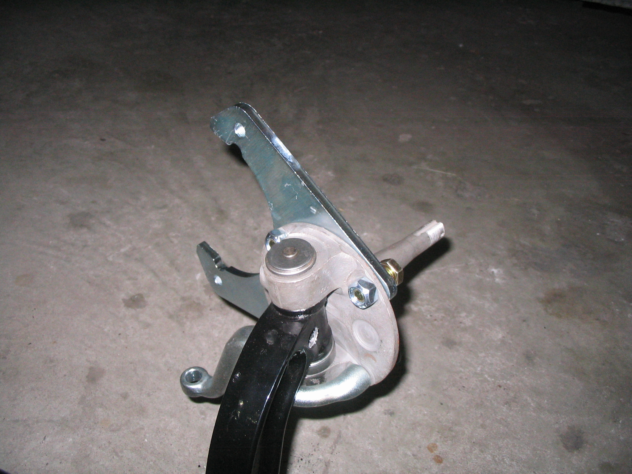

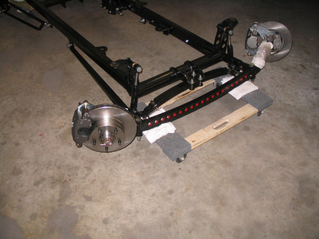

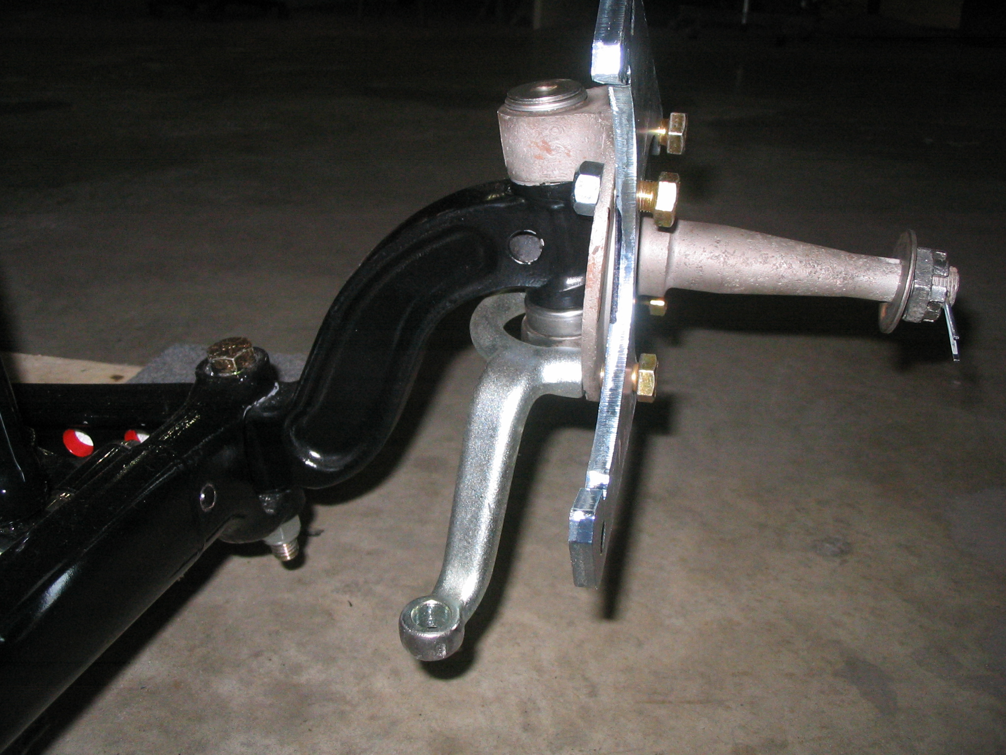

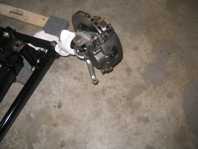

Midnight ramble and mock up of the arms and caliper braket
Okay, here's what I got. The install was pretty basic. My only concern is the steering arms. I'd much rather have them mount with a bolt going through and a lock washer and nut on the end. I'm trying to find someone who makes them or I may just go with the flat arms out front. Here's the pics and there will NOT be a video f me doing the happy dance. I chest pumped a bit and that was it.:D
Fred: I have similar steering arms on mine- no issue for 15k or so miles. Use some loctite and you'll be fine
You can drill a 1/16" hole through the bolt head and safety wire the bolts together. I'm sure they are course thread bolts so AN bolts with holes are out of the question.
Guys, it's kinda hard to explain, but I'm just so used to seeing a lock washer and nut. I'm sure I'll get used to these arms. I'm actually making a fuss about nothing and probably shouldn't have even mentioned it. The tip about using Loc-tite is a good one, thanks. I'll be taking this apart next week for paint. I just felt like mocking it up. Thanks.
Okay, I found a source for the steering arms I want. Looks very promising!
AR-2121M Steering Arms for 1935-1948 Ford (Disc Brakes)
Chassis Engineering is an excellent company to deal with, Fred. When I was building my '37 Chevy I bought the Mustang II front suspension from them. As luck would have it, after a couple of years of driving the right lower arm broke leaving us stranded. After a tow back home I assessed the situation and gave them a call. They stepped right up and shipped a whole new set up with their tubular arms rather than the stock type that I had. They also wanted to know if there was any other damage to the car. I told them that there was a small scratch on the inside of the right front wheel. They then asked for the make and size and sent me a brand new wheel. All this was handled with great care and courtesy.
