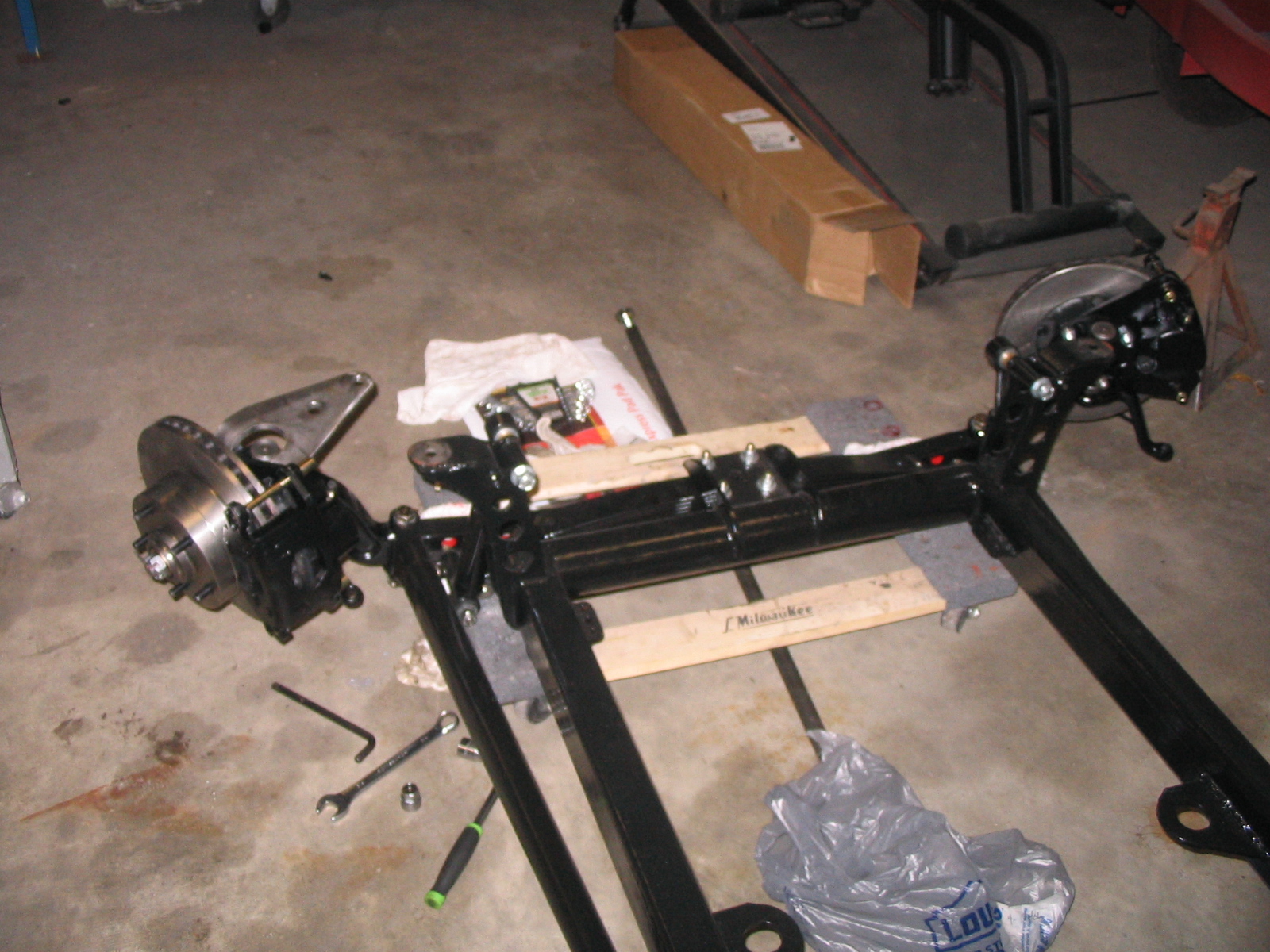

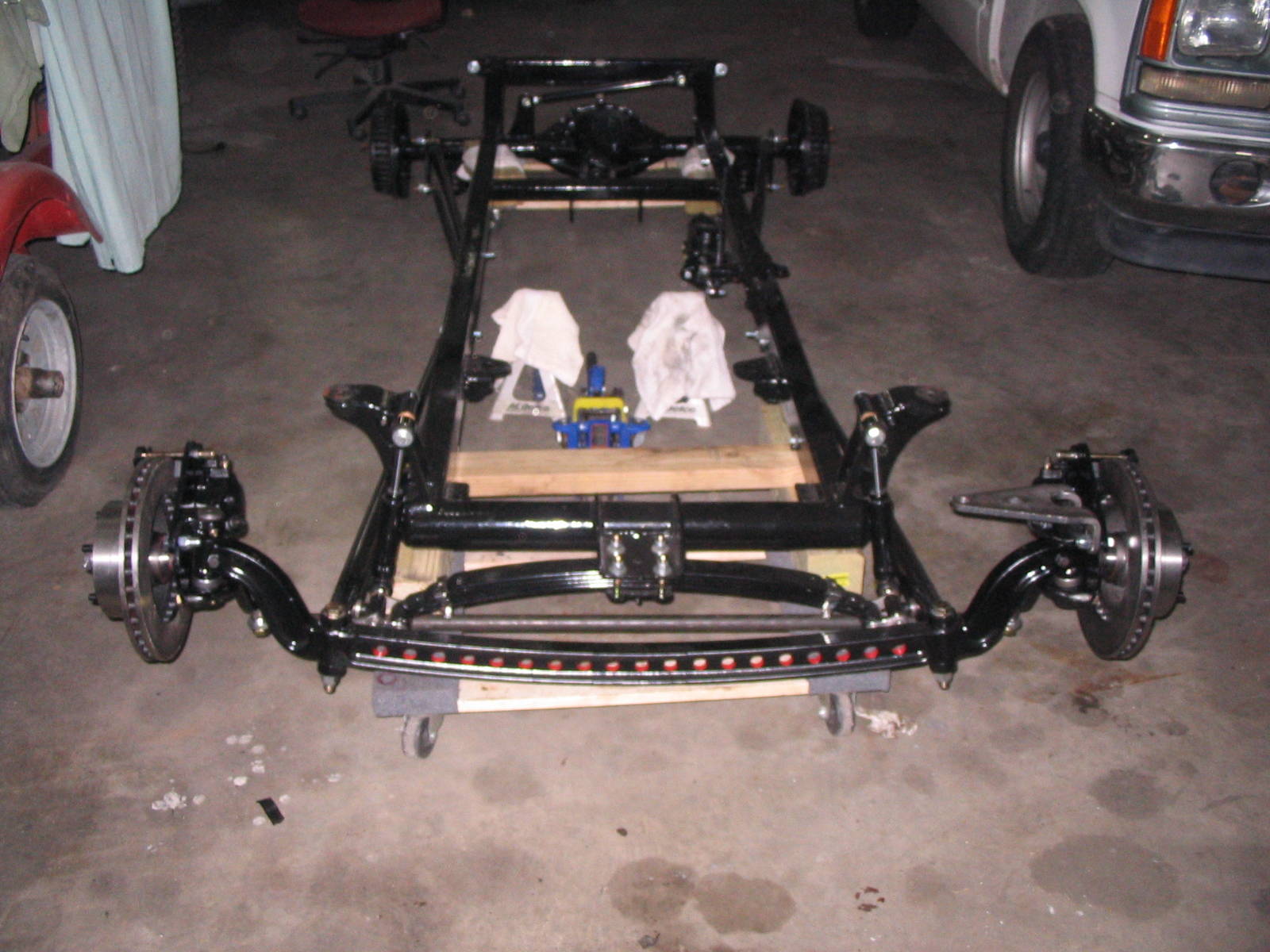

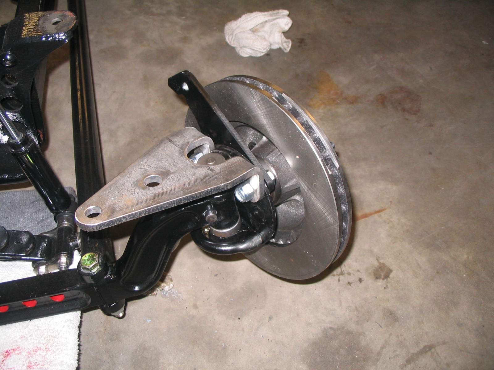

Okay..... got off my azz tonight and drilled out the steering arms to take a Grade 8, 5/8" bolt. Checked for fit and everything looks good. Tomorrow, I'll prep and and paint the calipers, brackets, spacers, steering arms and tie rod. Of course, pics are forth coming.;) Ain't no dang back pain gonna keep a hot rodder down!
I prepped, primed and got on a good first color coat. Houston's weather this time of year is making me cautious. I'll apply a second color coat before the night is over. I took some pics, but they came out too dark. Tomorrow, when I get in from work, I'll hopefully have enough sunshine to get so better pics.
Second color coat.... DONE! Looks good.
Got in from work and got after it.

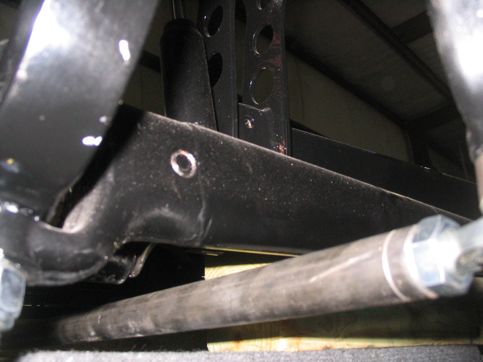

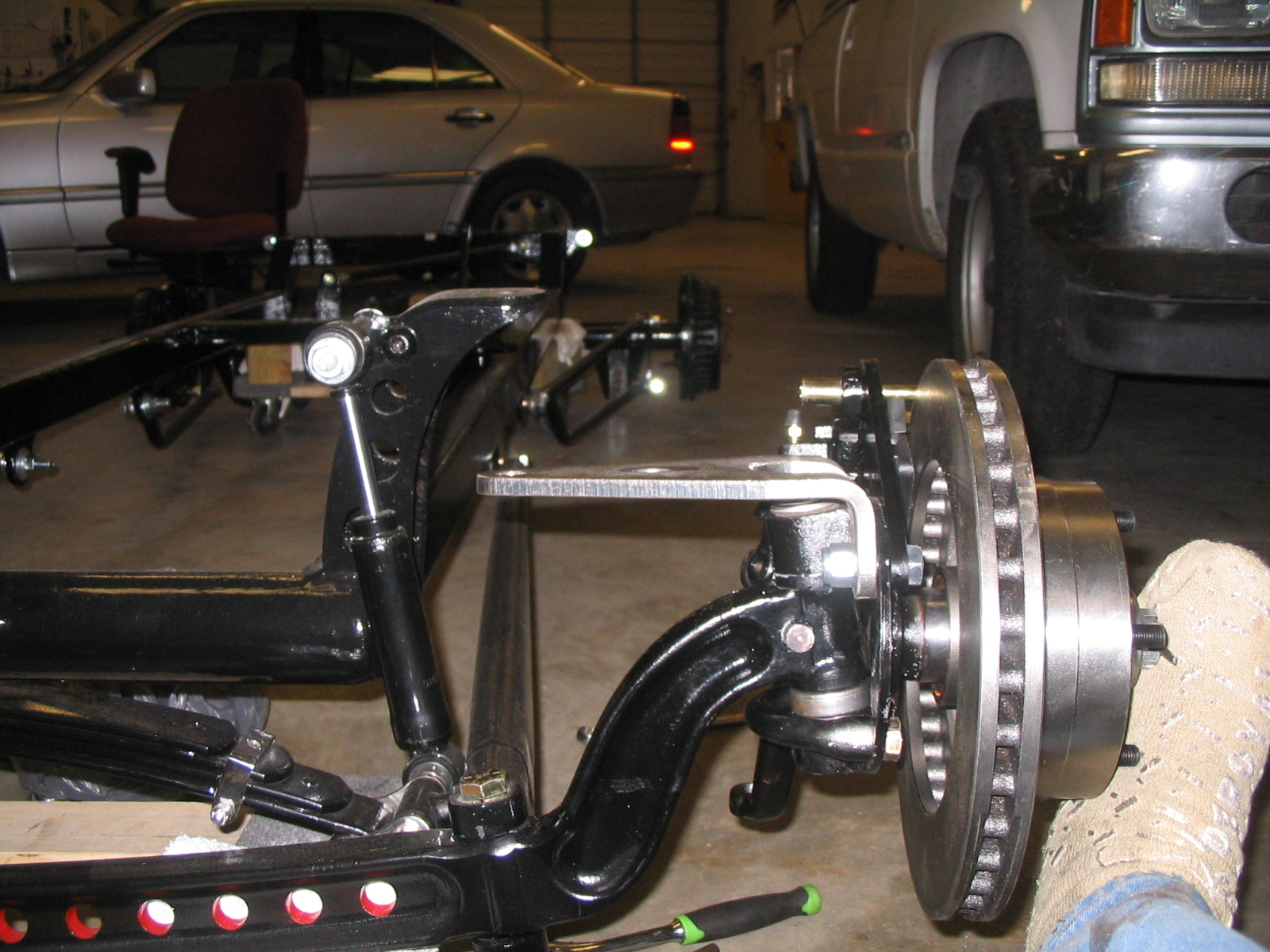

I had to grind a bit of Ron's steering arm to clear the caliper, but it was worth it. Ron's parts are made to give a bit of freedom to even a minor fabricator. Plus, his stuff is MADE IN THE USA. So, the next time you think about going some where else, call Ron. It's worth it.
I didn't paint the steering arm because I want to check clearance by the shock tower. Line of sight says she'll work. Later this evening, I'll install the toe rod.

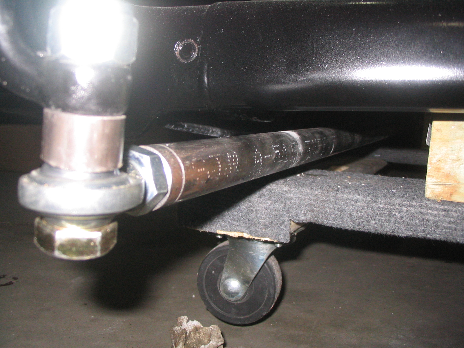

And...... done. Clearance is 9/16" and I have full movement stop to stop.
I'll say it before somebody else does... remember to remind yourself to put washers on those heims.
Looking good!
Thanks, Ron.
Looking good!
To expand on that, is that a safety thing incase the heim pulls out and you only need 1 correct ?
To keep the large diameter of the rod end body from ever passing over the nut or bolt head.
When used in single shear. If the other side is against a bracket or a mount that's bigger than the rod end body, it's not needed.
