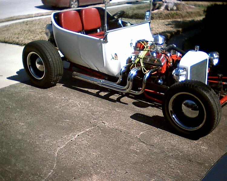

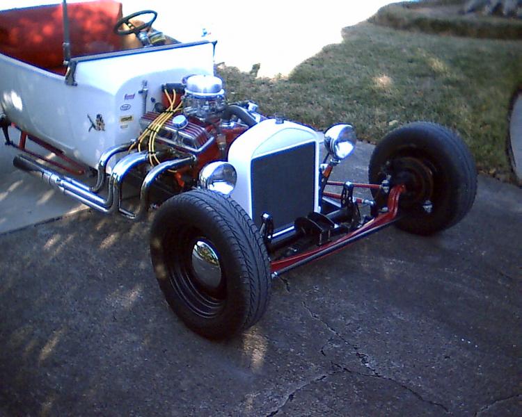

My old car without beauty rings:
and with:
There's no question that rings looked great on the old build. Will I think they'll look good on this one? Has yet to be determined.
