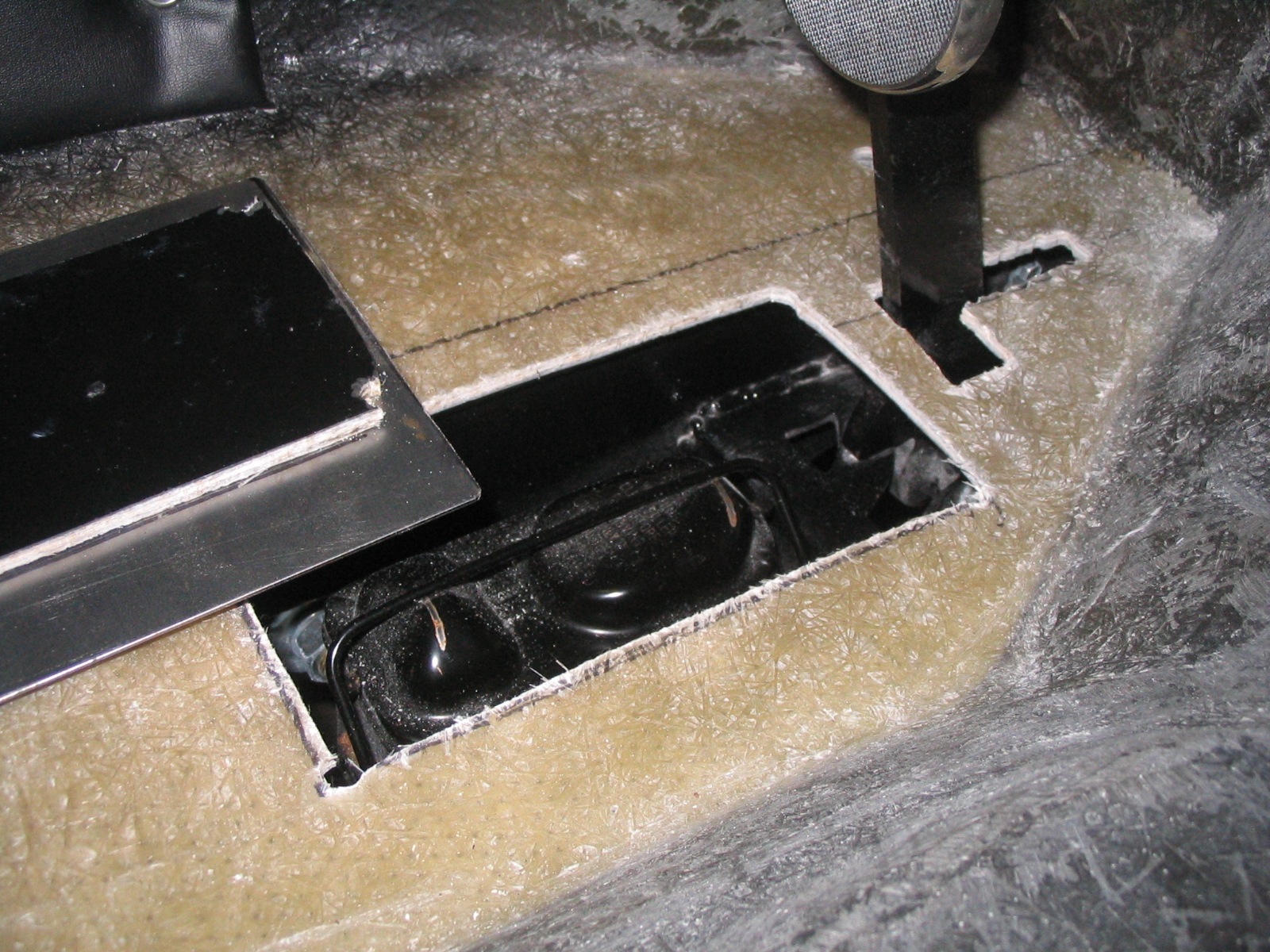

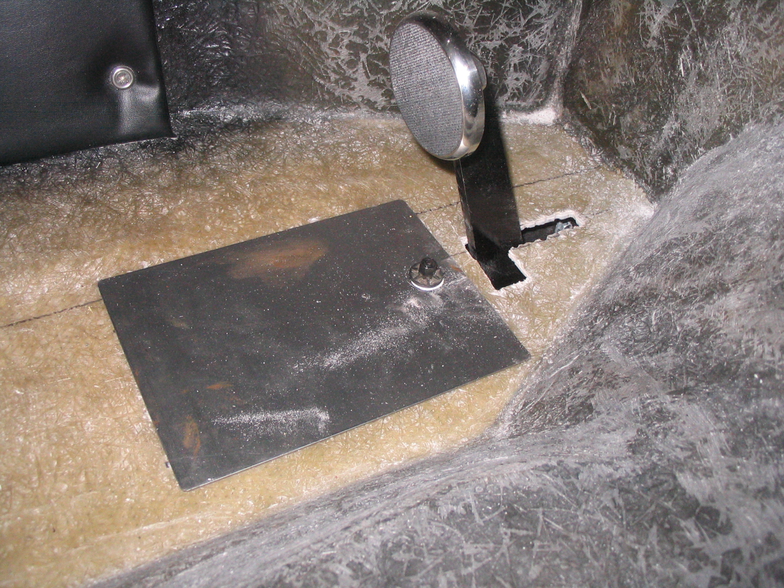

A week or so ago, I cut out the access hole for my master cylinder and brake pedal arm. I saved the piece of the floor I cut out and adhered it with 3M 5200 Fast Cure to a piece of 16GA. I added a small knob to pick it up and remind me which end is the front.:rolleyes:. It fits just right. Nothing fancy. In my last T Bucket, the hole was smaller than I liked. So, I made this one a little larger at 4.25" x 8". The access cover is 6" x 8.5".
