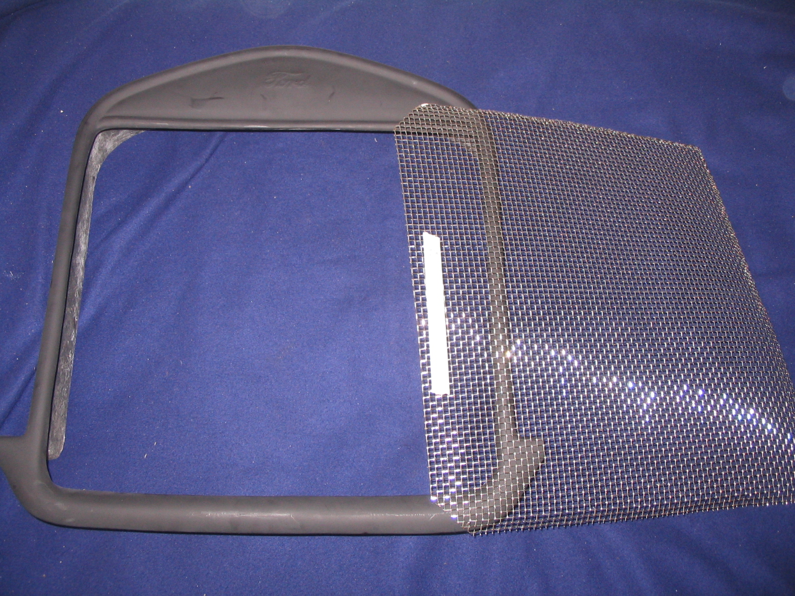

My grill shell and S/S wire mesh arrived yesterday. The grill shell came primered or that's what it looks like. Last night, I trimmed the mounting tabs to fit my frame and drilled the holes for where she'll mount. Then, I cut and bent the mesh to fit. Today, I'll glue in the insert and let that dry over night. Depending on the weather tomorrow, I'll prep and paint the grill shell.

Paint over S/S? No way, man. I pressed/formed the edges of the mesh into the grill opening recesses. Then, I'm using a thick bead of 3M Fast Cure 5200 to hold it. Gawd I love that stuff.

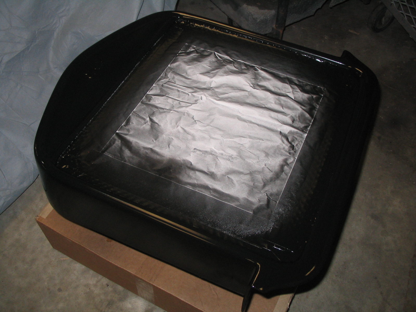

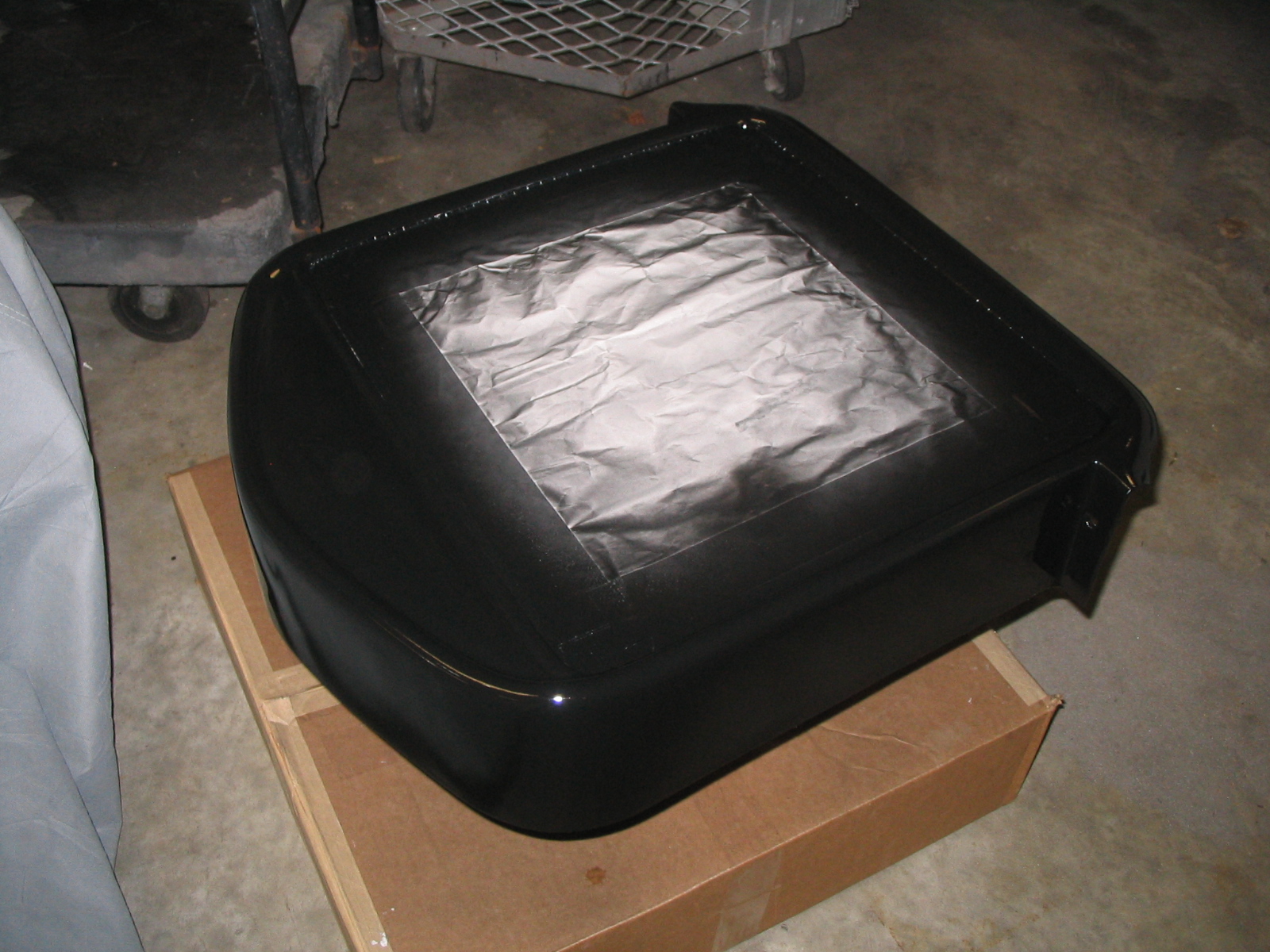

Last night, I taped off the screen on both sides. This morning, I applied a coat of primer to the inside and let it dry. Flipped it over for a coat of primer and 3 color coats. I had 2 small runs, but was able to wet sand them smooth. I meant to take pics outside, for better light, but the rain clouds were coming.

Because I didn't want to get scratches or glue on what would have been a fresh paint job. Painting it first was a thought, but I knew I'd be handling the shell a lot and then there's applying the glue I used to hold the screen in. Taping off the screen took all of 15 minutes.

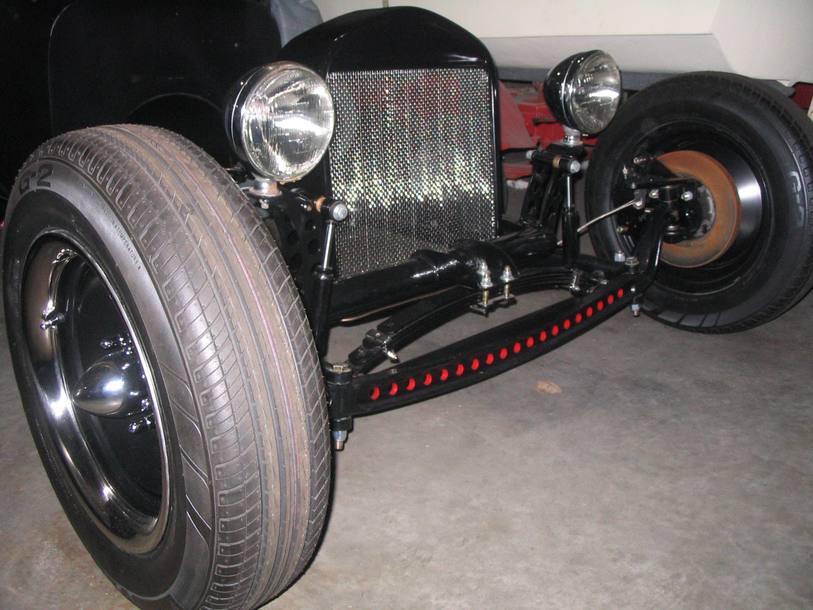

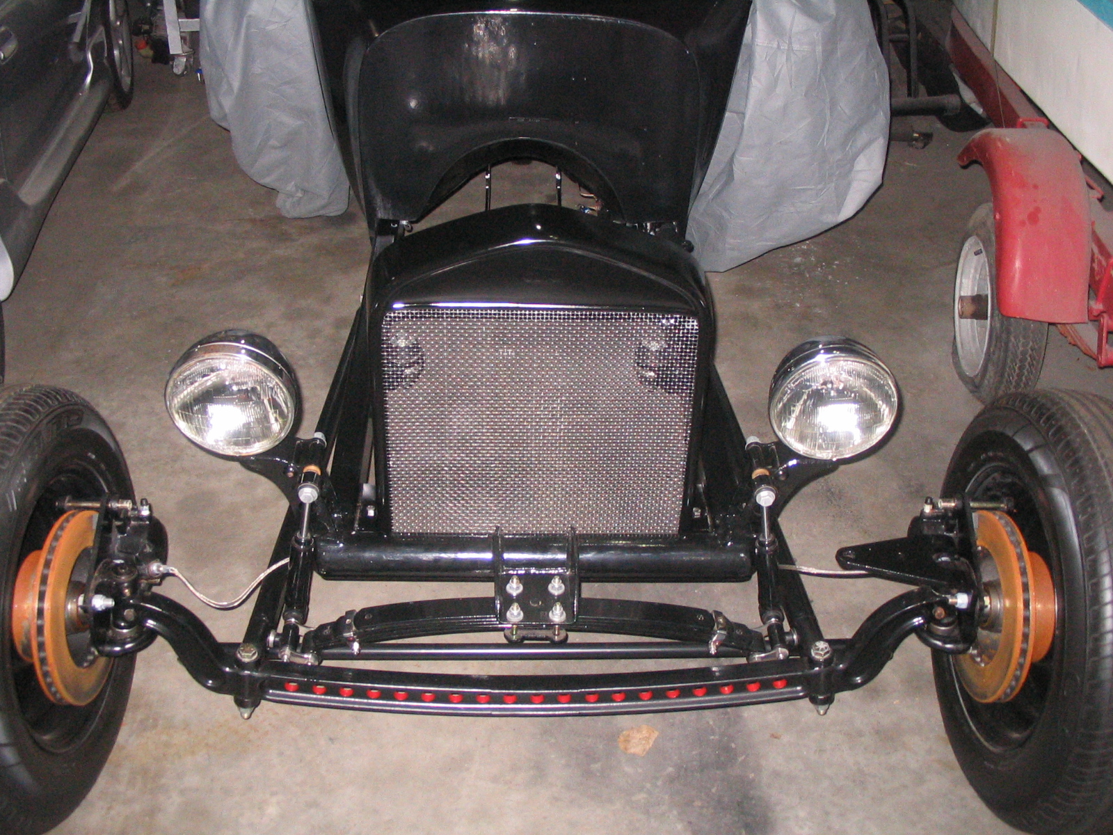

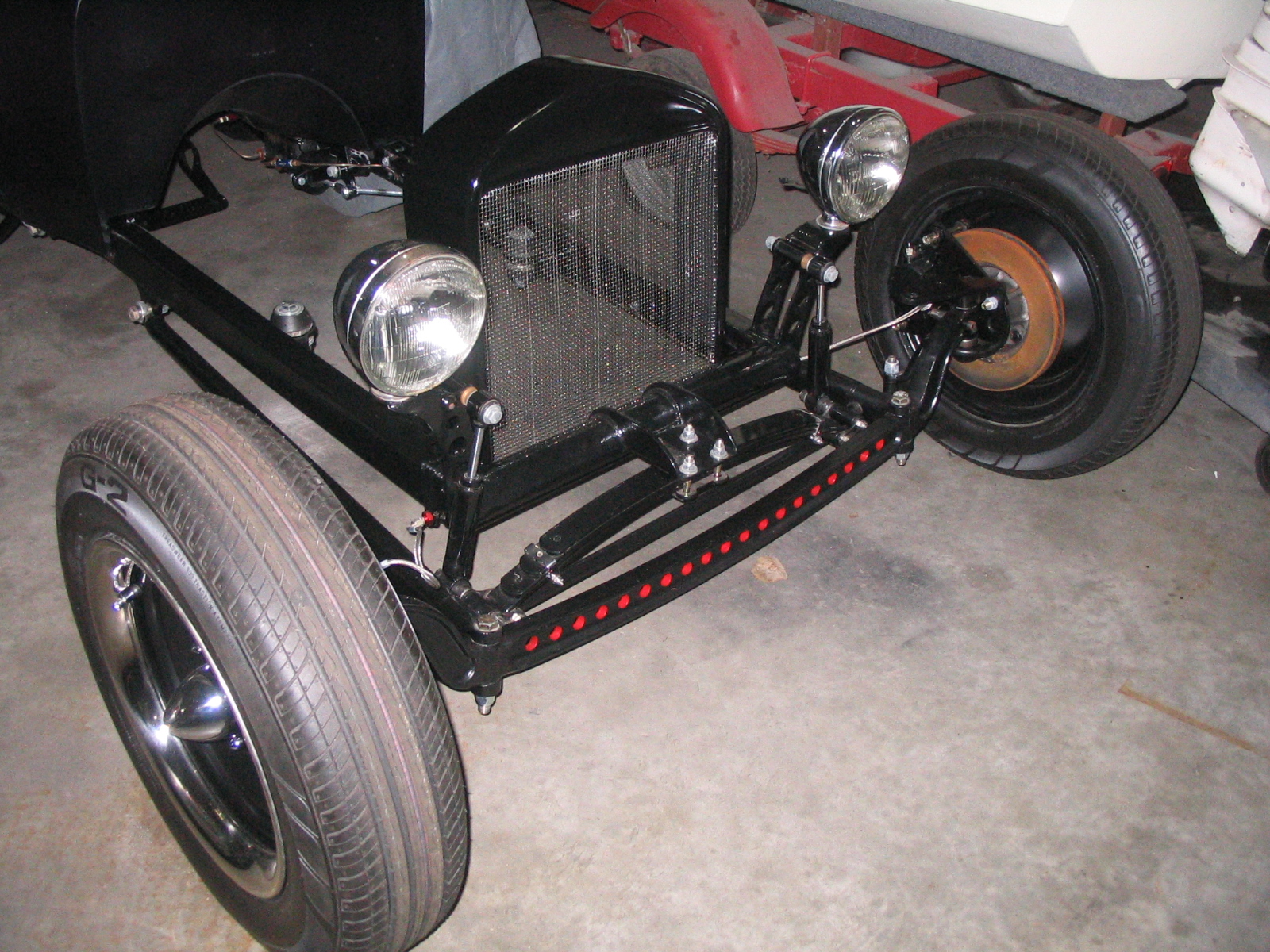

Just sat the shell on to get a look. I'm pleased with it.
