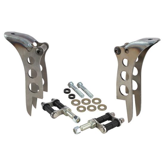

Probably going to be getting this kit to mount my shocks along with a set of the speedway short shocks. I'm going to have to cut them up a bit though. Will need to make them taller and probably skinnier. I do think that friction shocks MAY be nicer for my build but I'm not really interested in messing around with adjusting them at any frequency.

Don’t buy something you need to modify. Make a cardboard template you want and send it to Ron at RPM and he can cut out exactly what you want. Easy pezy!

Your right. I just sent him a email to start the process of getting the shackle mounts and the shocks. I'll get them set up and go from there.
