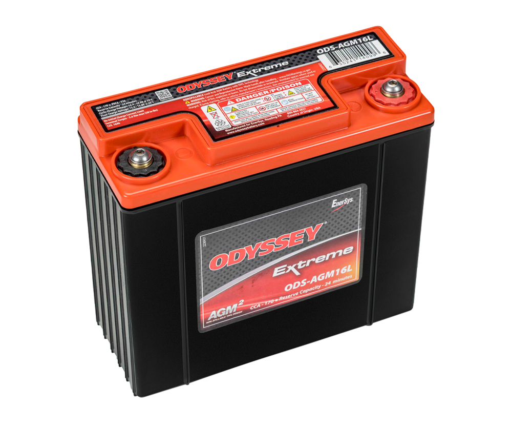

I've used the Odyssey for years also, but I had the PC-680 that is only 3.0" thick, so I laid it down under the seat.
Length: 7.20"
Width: 3.00"
Height: 6.60"
