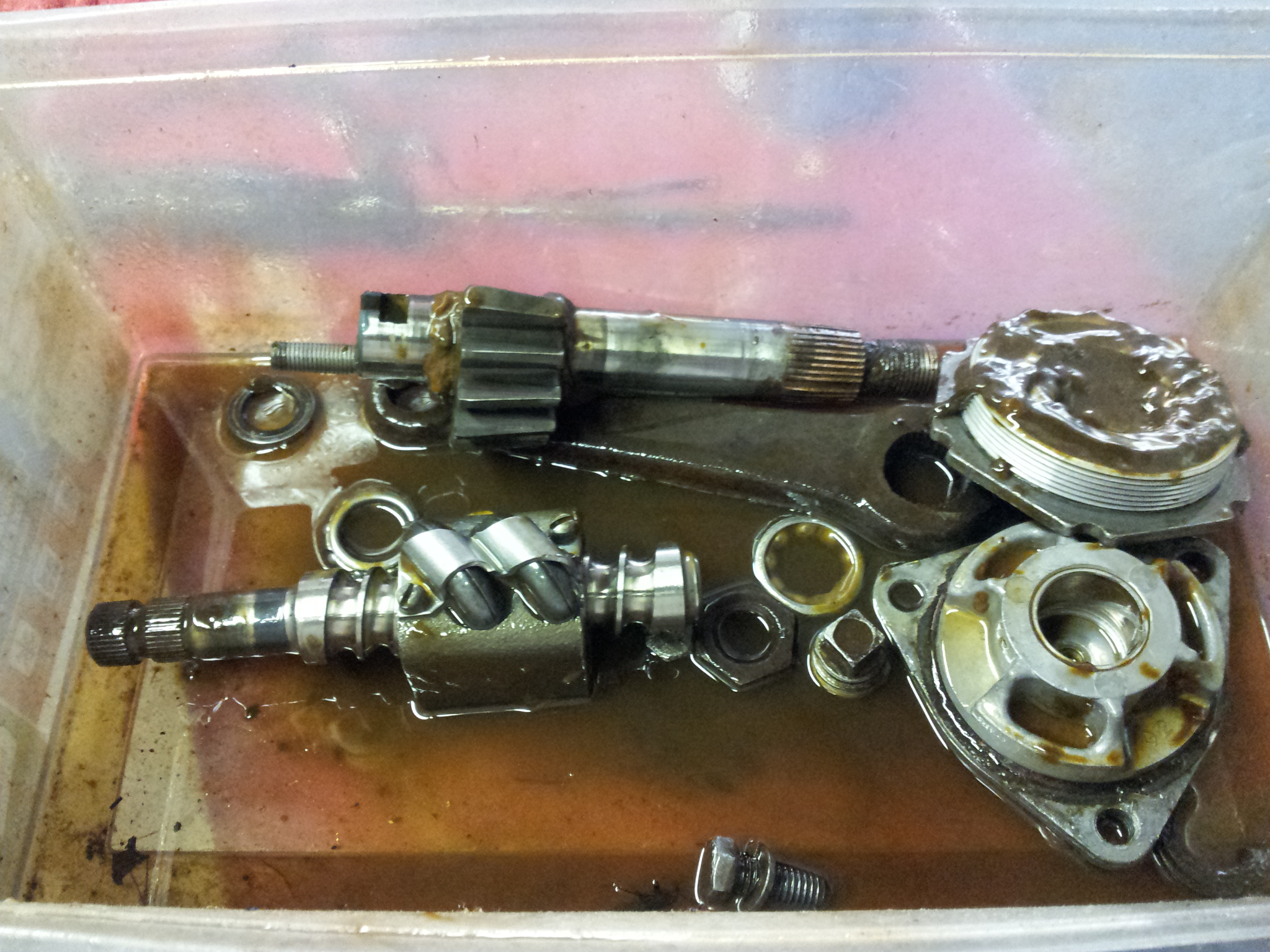

Good news is I got the original corvair box apart after givn'r the all or nothing approach and it looks like its worth rebuilding and reversing.

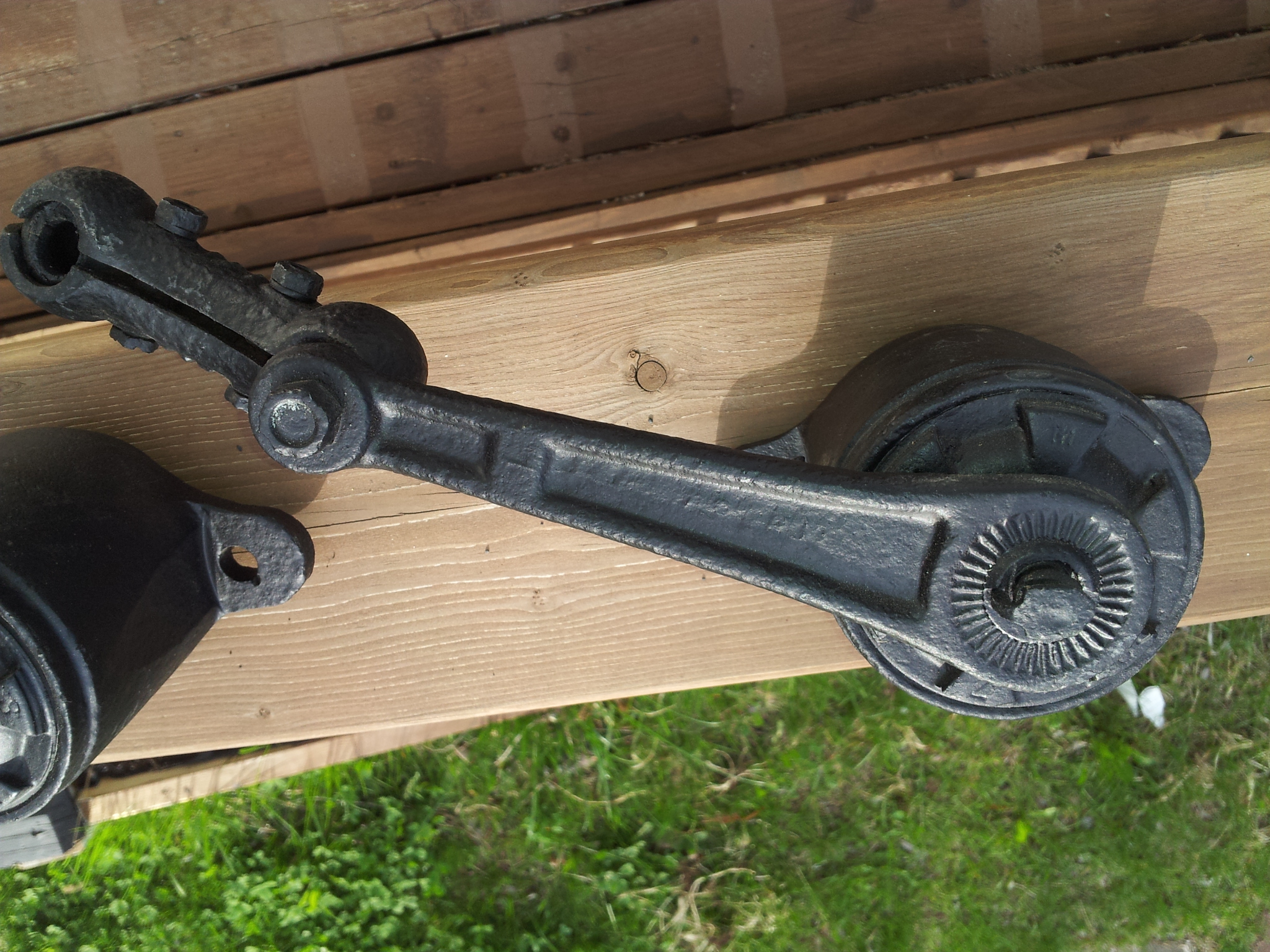

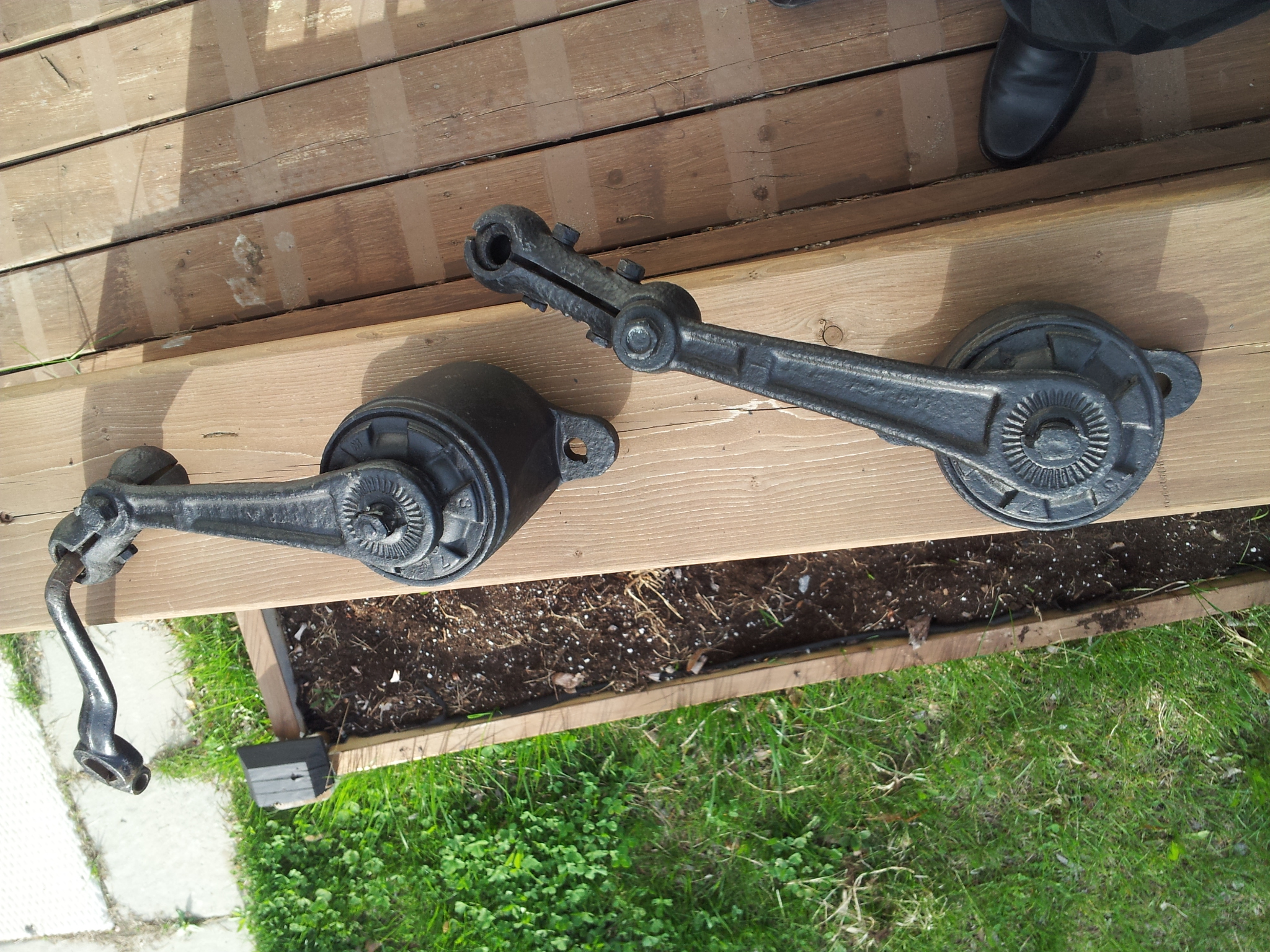

Did find some original 1930 dampeners for the front end.

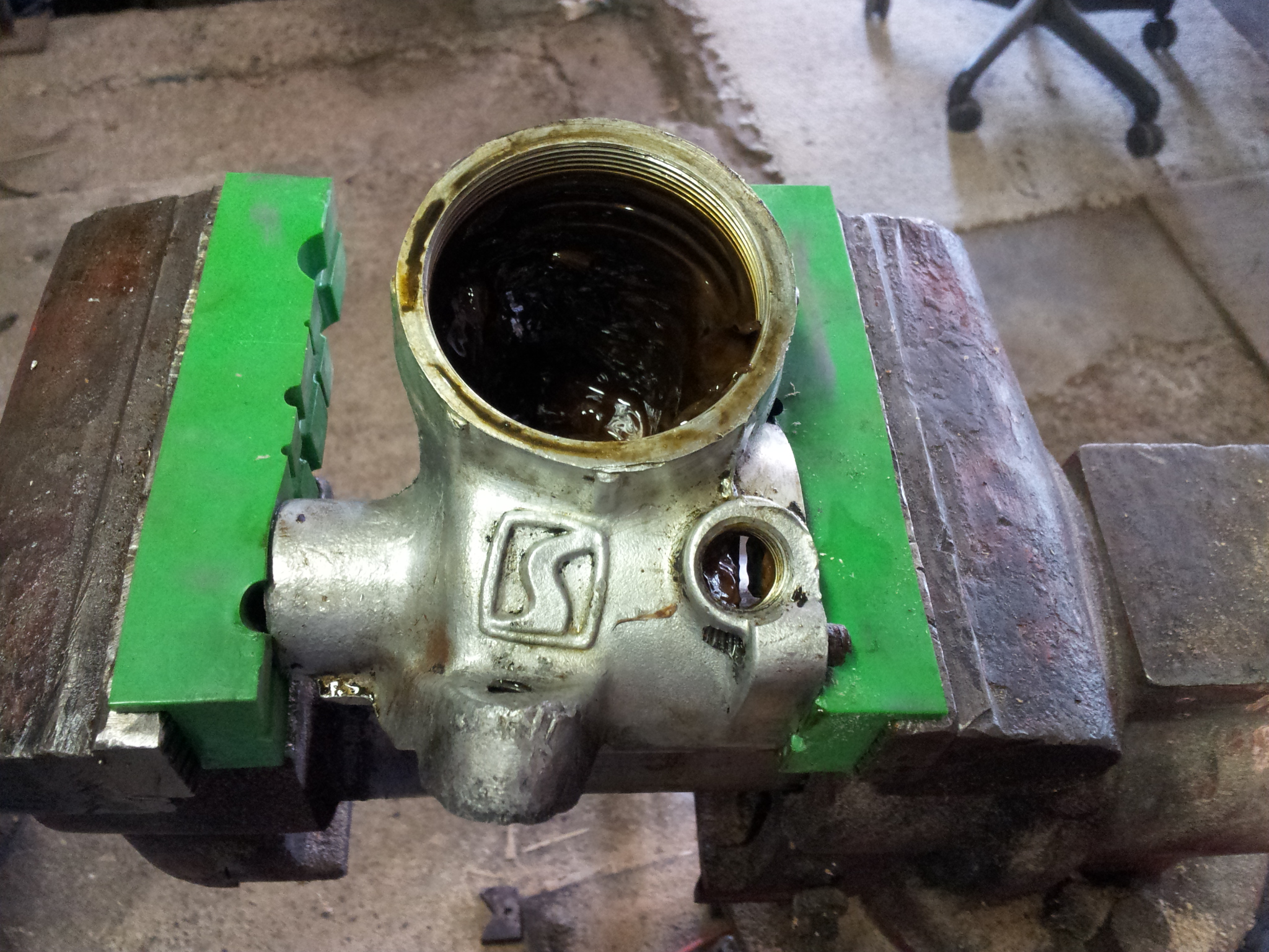

Ok.. I give a breakdown of what I did.
Some might not have the same difficulties I did from reading the other forums.
Every one else seemed to have a hard time getting the pitman arm off, mine came right off with and old puller easy.
No one seemed to mention having a hard time getting the cover plate off . but I did.
Amazing how dissimilar metals corrode with each other.
The cast aluminum housing had the cover plate glued to it as if it was welded, and all three bolts broke off trying to remove them.
I let the thing sit in WD40 soaking for a few more weeks.
After the bolt heads broke off I hit the cover plate with the torch for a while and pounded a flat head at it.
Now I was following these instructions for rebuild.
http://www.jeffw.ca/Bucket/Mech/Steering_Box_Rebuild.pdf
And there was a post on a few others about reversing it but they all seemed to be contradictory.
Let me clear that up.. Not every forum I researched recommended the same size frost plug to seal the end.
In the instructions there in note #5 ,, ,, ya . well 40 something year old dissimilar metal bonding with a steal cover and a cast aluminum case can get frustrating.
I was starting to worry I was going to melt the casting with the heat I was putting on it.
I didn't want to break it so I kind of gave up on it thinking some Corvair guy might want it and I could find another one all ready done but no luck, so it was either coming apart or I was going to have to pay big money at Flaming River or other for a box.
Well it was all or nothing so I giv'r the beens with an old flat head, busted the tip off of the screwdriver, the box went flying out of the vice, landed on the concrete, and I thought for sure it was F$%&^k.
Picked it up and the cover had popped off ..the rest was just cosmetic scratches I can fix with a nice file and some sand paper.

You know the headless bolts will come out one way or another. I would continue to reverse it, if nothing else, just for the experience. I am hard headed, and hate to let something beat me. I have a stupid project going on like that right now with a four stoke weed eater. Keep at it. Even if you mess up the threaded holes, perhaps you could step up to one size larger bolt, drill and tap. Your at the point now, you have nothing to lose but time.
If you have a welder, weld a nut to the broken studs with a heavy pass. Sometimes the heat from the weld frees up the broken bolt. If it doesn't at least you have something to work with.
It is definitely getting done. No budget for another one now, I already ordered my steering column.
If I can't get them out I know a machine shop that can.

The front shocks I scored I scored at the flea market.
may need a rebuild but look great the way they are.
I believe they are Haudaille shocks from the 30's, got the dog bones and the arms too.
After looking at Five Points prices I think I got a steel at $60 Canadian.
