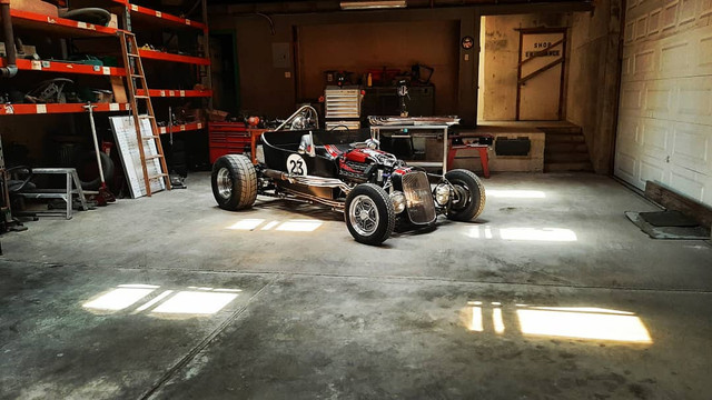

The T in my head, thoughts?
Today's project, although frivolous and cheesy. It was rather fun to implement:

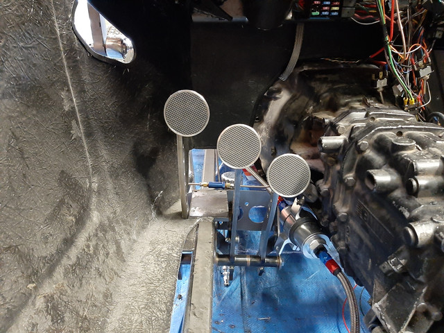

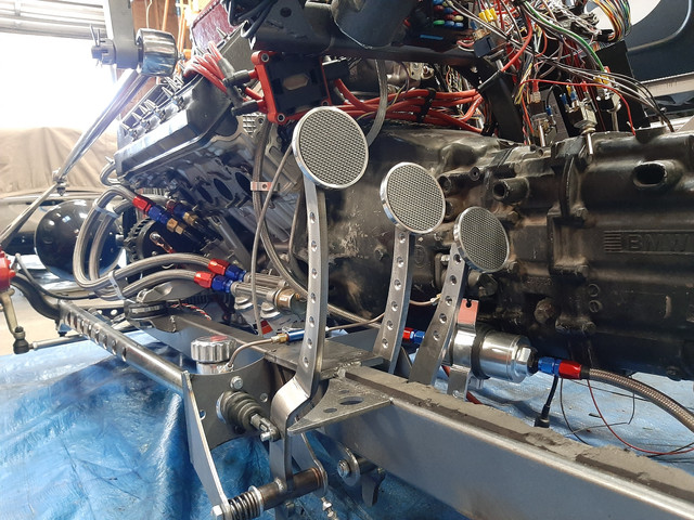

Focusing on pedal mounting & hydraulics, ordered, re-ordered & special ordered all the pedal arms in various styles I needed to accomplish the spacing that will fit. Even then, it's too tight... my solution today was to stagger the pedal pad height. And actually, although awkward it's manageable.
I am concerned for ground clearance. There is a bit of the pedals I can cut off, but may ultimately make a skid type plate for this area

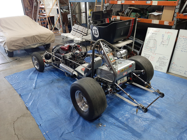

Mounted the Moon tank for the supercharger coolant:
