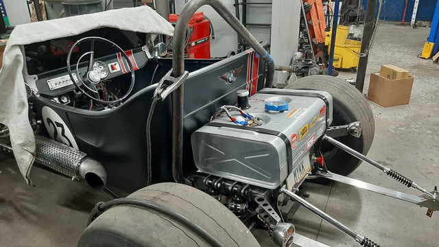

This weekends project; While awaiting the delivery of a few engine gaskets to seal up some vacuum, oil & coolant leaks I decided to finalize the exhaust. Found an issue with my Lincoln 135 MIG welder, an electrical spade terminal fell off the the gas solenoid inside the welder. So no Argon/Co2 was being released down the weld lead and tip. With the issue resolved now I can finish gluing my mufflers to the headers

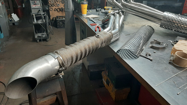

As a temporary experiment for some added sound control, I plugged the otherwise straight thru tube in the middle of the auger mufflers. If it sounds good and doesn't choke the exhaust too drastically, I'll come up with a permanent solution.
And of course, part of the solution to maintaining manageable muffler temperature at the step in/out point of the bucket. Double wrapping, 2 layers of DEI titanium header wrap around the mufflers plus those heat shields.
