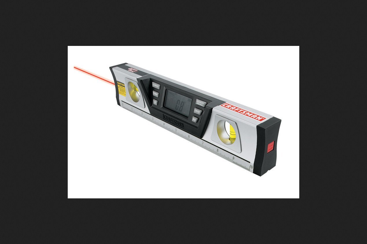

All you need is a device like these pictured below . Some call them a protractor Some call them angle indicators. Sears calls them a universal protractor and they are about $10.00. Harbor Freight sells them for less than that. There are a lot of protractor tools around but these are the easiest to use.
Whichever you use (especially the cheaper one), I'd check it against a known accurate level. Set up a 4' or longer level or a good Starrett #98 millwrights level and shim to get it level, set the protractor on top of it and check the bubble or dial for accuracy� when the reference level "is", the protractor dial should read zero.. it wouldn't hurt to check it on both planes.
