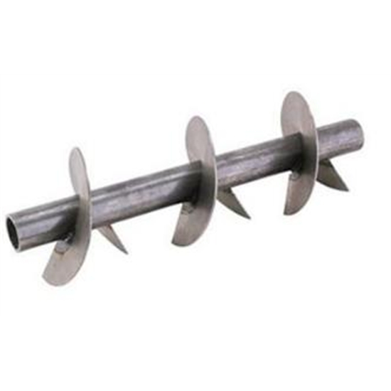

Made up some header baffles.
Also installed some auger style mufflers and finish tig welded it all together
