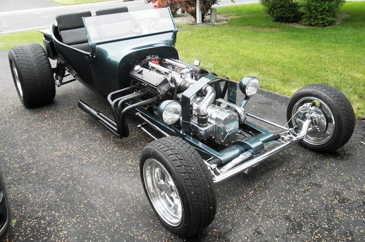

Ah, the long wait is over. Beautiful MN day and I went to market:
The new taller Lexan windshield is nice. It does bow a bit at speed, but should be OK. I can always add a stiffener to the top later.
New throttle linkage very smooth. Tip: don't try to cut Lokar cable with dikes. I did and it was ugly. Dremel or other cutoff tool does a neat job.
Pipes are very noisy. I have small baffles in each pipe, but there must be a better way.

Double the length of the baffles, but at what length would you actually feel the performance start to diminish?

Do you have any pictures of where the O2 sensor is mounted in your headers? I am using the MSD Atomic system with sprint type headers and it seems like anything below 2000 rpm the AFR is going way lean. I can not find any vacuum leaks or reasons for this other than maybe the headers are too short.
Sorry wasnt trying to hi-jack your thread just curious how you are getting it to work.
Casey
Kasso: I had an O2 sensor in my old sprint headers, right behind where the 4 pipes join into one:
After a few hours of driving the fuel map is fully populated and the O2 sensor is not needed unless you change something in the motor. So I don't run one now. I'm using the FAST EZ-EFI. The MSD Atomic, under advanced options, allows you to set AFR targets; might tinker with those.

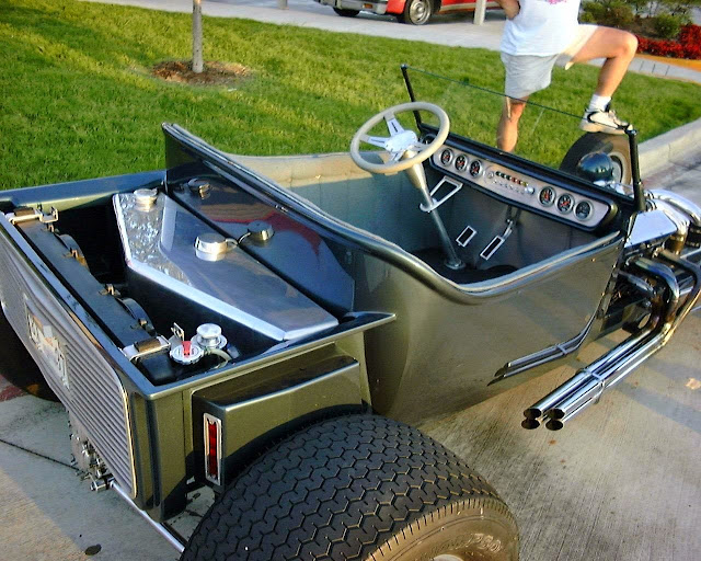

TriodeLuvr: The radiator is in the bed, behind that grill. No room up front with the Potvin blower.

Time flies when cruise season starts. The Lexan windshield is doing great. I've added a lateral support between the seats:
