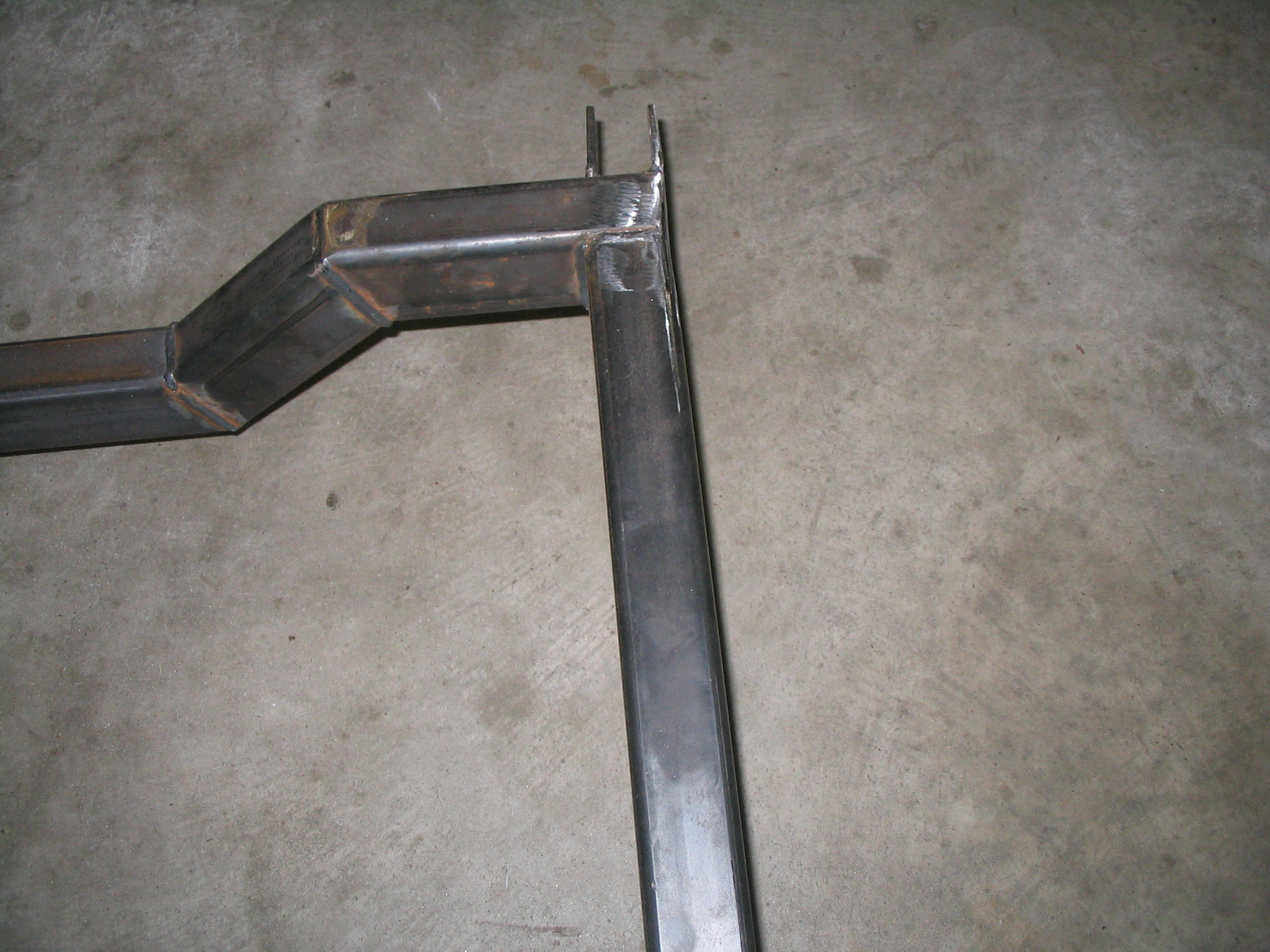

When I say grind them down, what I'm going to do is clean up the little bit of splatter that there is, which is minimal. I'm not going to do anything to ruin the integrity of the welds. As for done by this this summer?! YEA...... if my numbers hit. But I rarely play the lotto. My goal would be this time of year 2017.
FYI, you should be ok to flatten a weld on a butt type joint, the mound doesn't add any strength. The welds strength is based on its penetration, hence fusion of the parts. Now on inside welds, ie: 90*, etc, things could be a bit different as the weld may be actually bridging a gap between the parts. You could still flatten it as far as if it is mounded higher in the center, but other than basic clean up, those should be left alone imo. That's my .02.
I don't know about others, but I'd love to see before and after pics. If all goes right, I'll be needing to do this on a frame of my own some time this summer or fall.

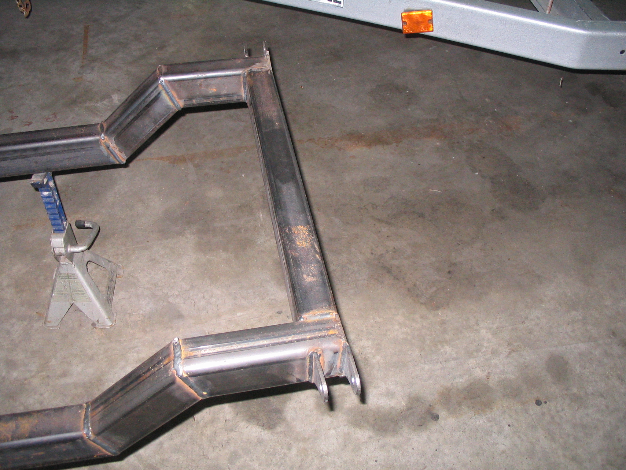

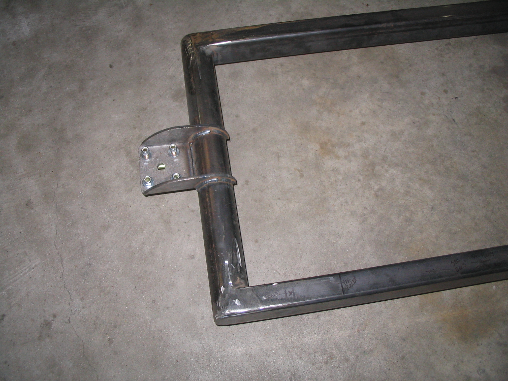

No problem. This one corner area where the cross tube is welded.
Before:
After:

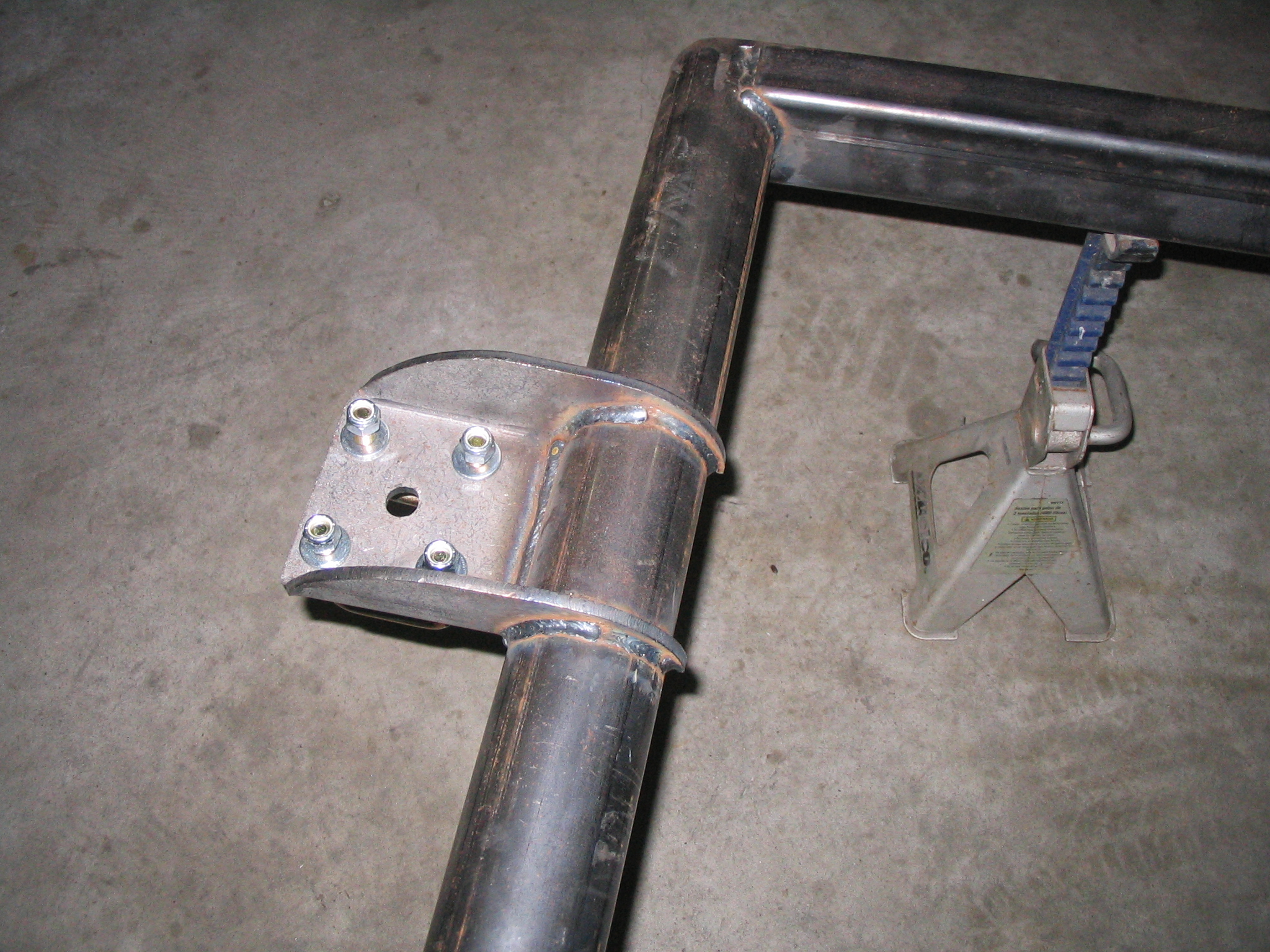

This a small area where the tail member is attached.
Before:
After:
Like I said, nothing major, just a little "grooming" because I was bored.

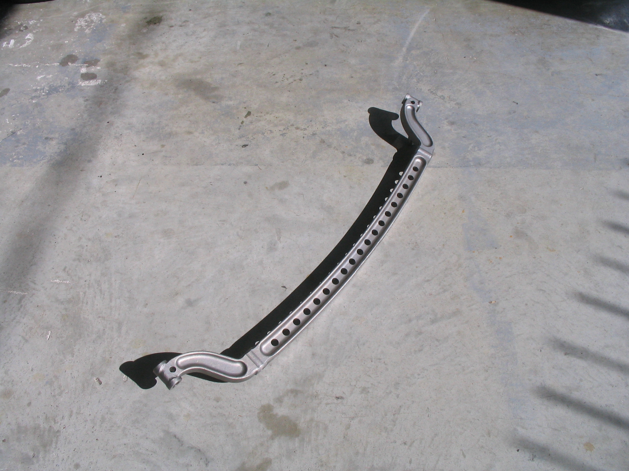

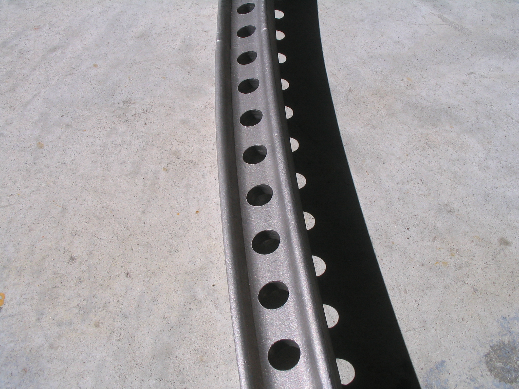

So, here's what was waiting for me, when I got home from work.

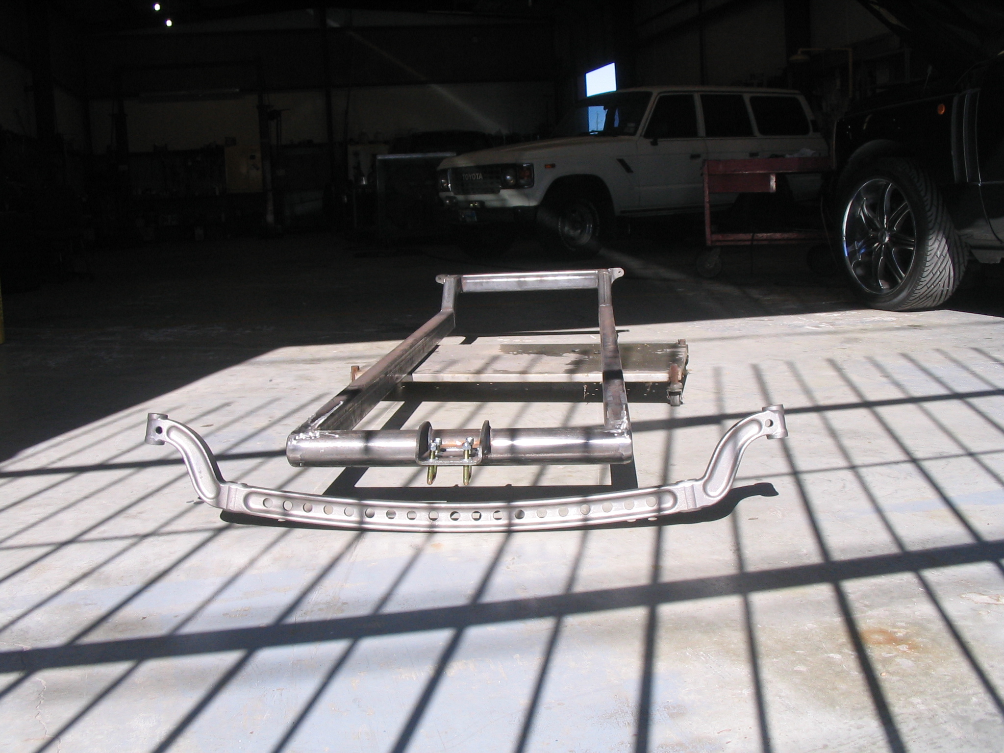

I wasted no time "mocking her up".

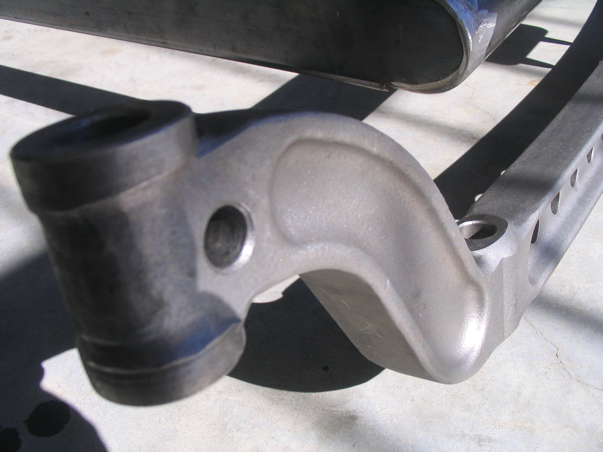

3/4" holes.... all 19 of 'em.
Nice and smooth. I can't wait to paint it. I'm going with a main color, contrasting color for the inserts and a separate color for the holes. You think it sounds "busy"? Just wait till you see it.
Next, I'll be collecting the wish bones and associated hardware to mount the completed front suspension and find placement for the wishbone brackets.
So smooth and clean.
