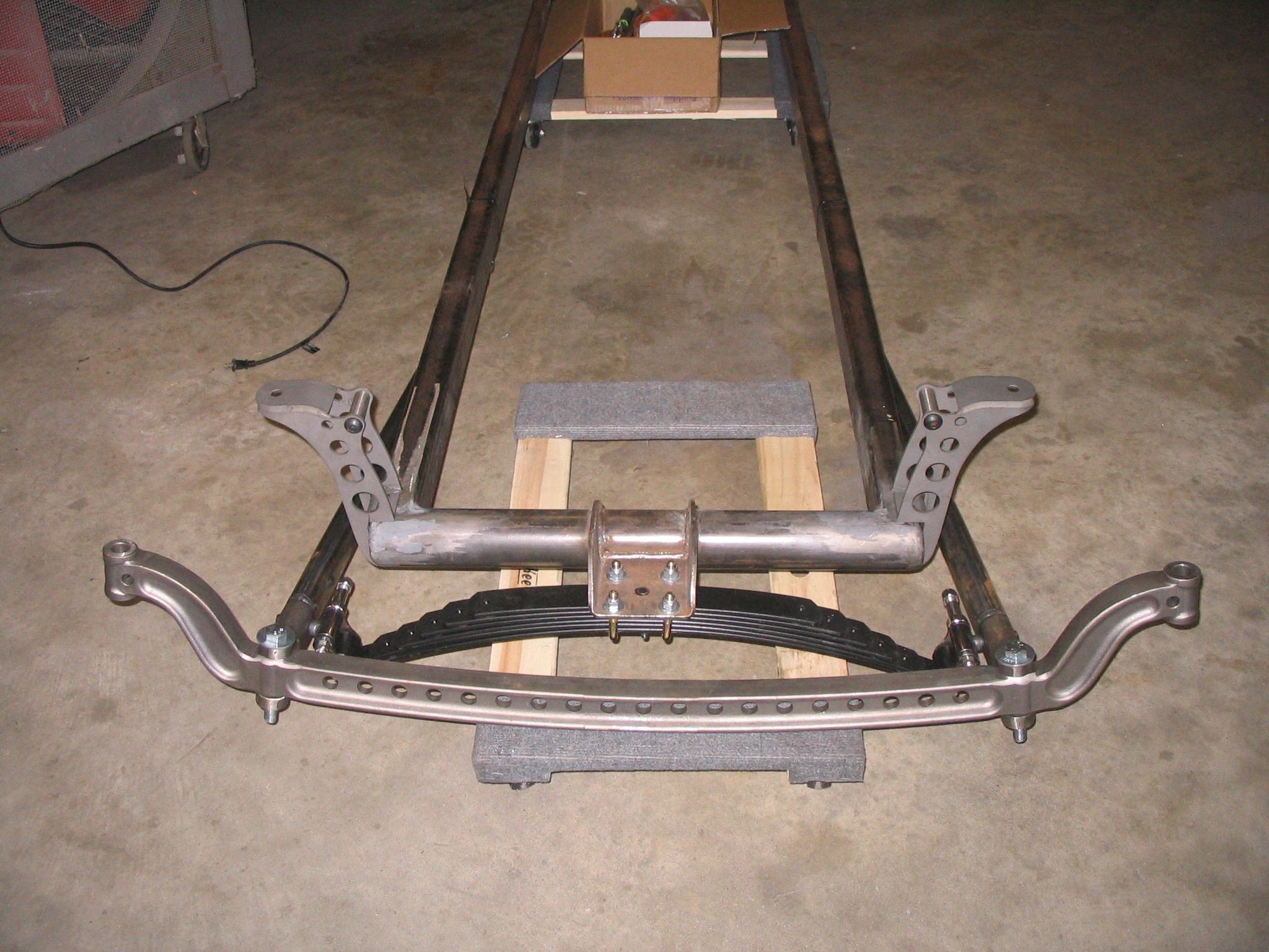

So, here's what I got today. Spring pivots (set at 5*), stainless shackles, leaf spring, shocks and mounts (not pictured) and spring clamps (not pictured).
What's really cool, is that the shocks and spring are already black........ "BLACK DAHLIA". Once I make sure everything is going to go as planned, it'll all come apart and the "bones, pivots and axle will get paint.

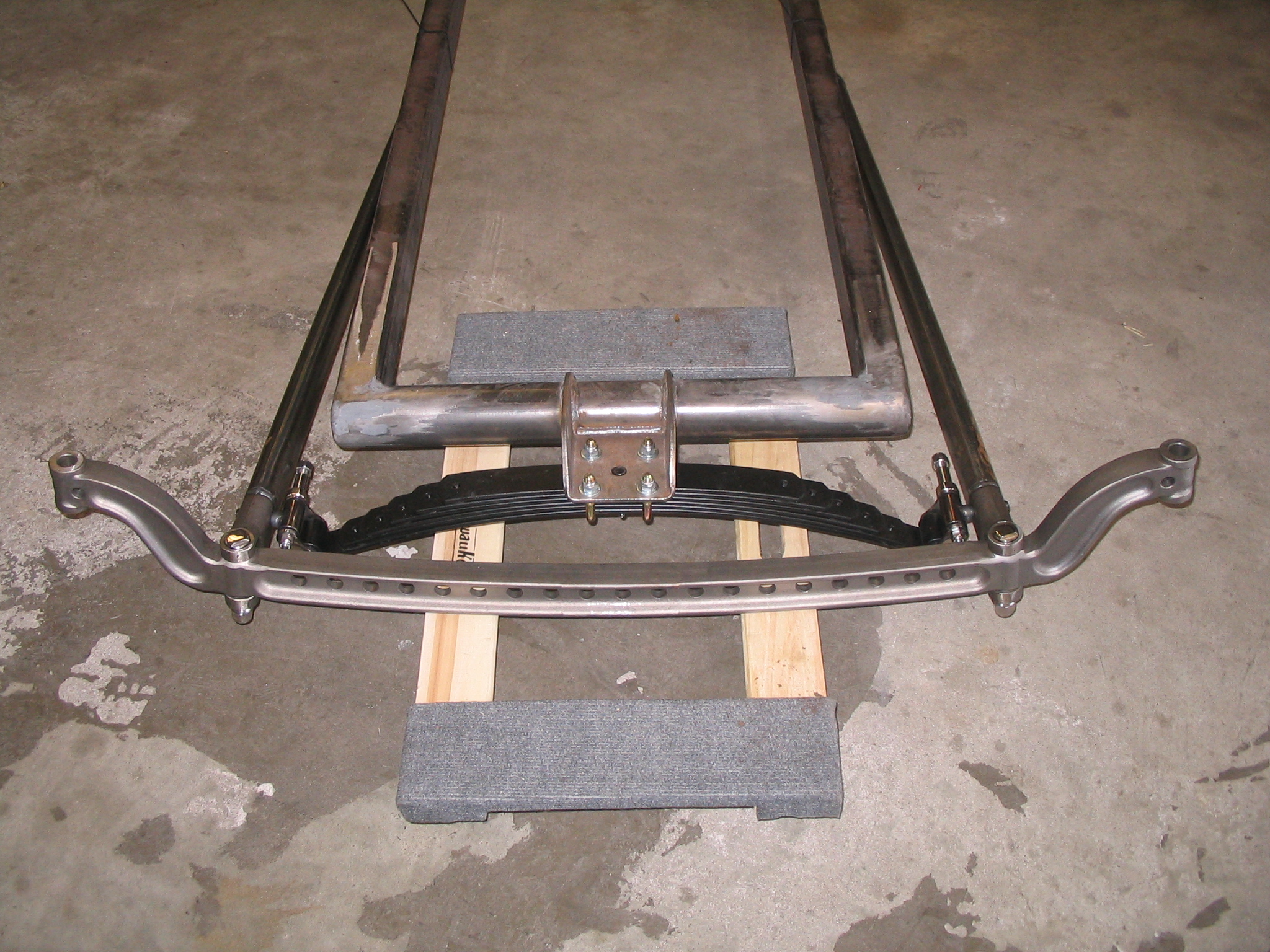

You'll also noticed, I got bored and used a little filler in the front joints, where the rails meet the cross member. Smooth as silk.
Looks like the spring is too long...
dave
As I stated earlier, nothing is tightened down yet. But if it is..... and that's big butt... I'll get one that does fit...... thanks for paying attention.

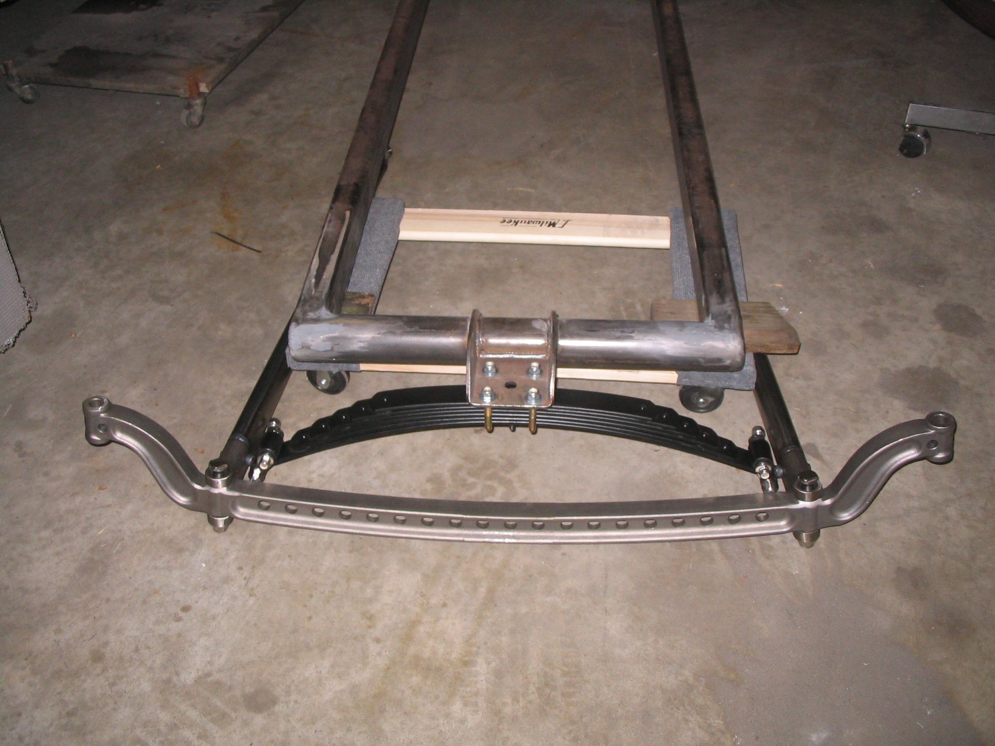

There... couldn't sleep last night, so...... a 2am thrashing to tighten things up for a real perspective.
Better? On a note about the shocks. I mocked up the shocks and mount and it seems I ordered the wrong ones. The shocks I have are too long, so I'll be swapping them out. It's actually kinda funny. Speedway lists a "short shock", so that's what I ordered. What I failed to notice, was their "T Bucket" shock. The one's I needed. Just wasn't paying attention or maybe over thinking it.

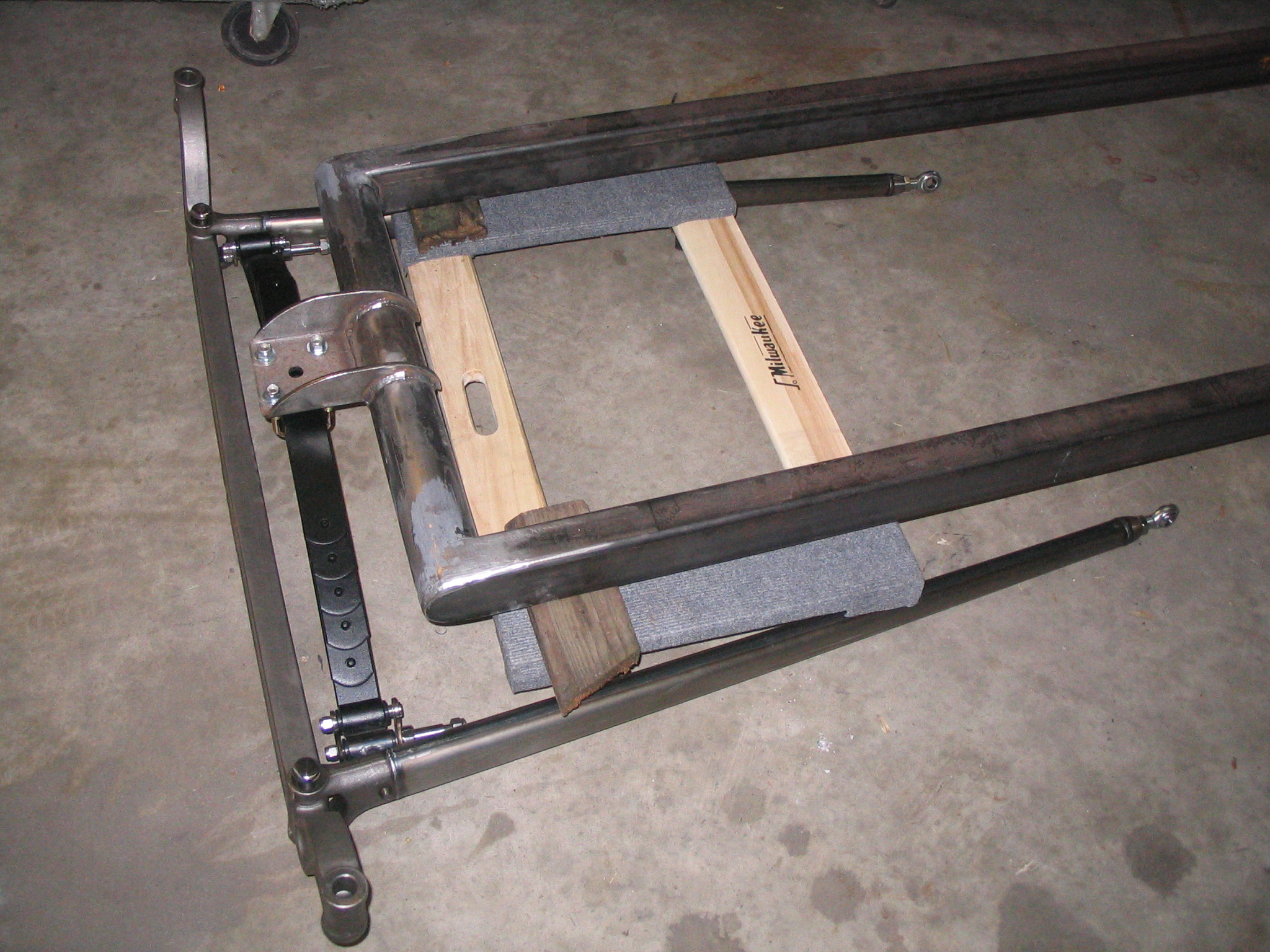

Set my shock/headlight brackets in place and my conclusion was that I'll be welding them on, instead of bolting them on. I just can't get over the gap where they join the frame rail. So, when I'm ready, I'll weld them in place and fill the gaps.
I'm REALLY loving the look.
I like it.....it looks like a double image! The axle and shock mounts have a very similar curve.
Wow! You know what? I been staring at the setup and never noticed that. Cool!
Also......Thanks, 2OLD2Fast and everyone else who said the spring/shackle set up was wrong. I learned a little lesson and for that I'm thankful.
