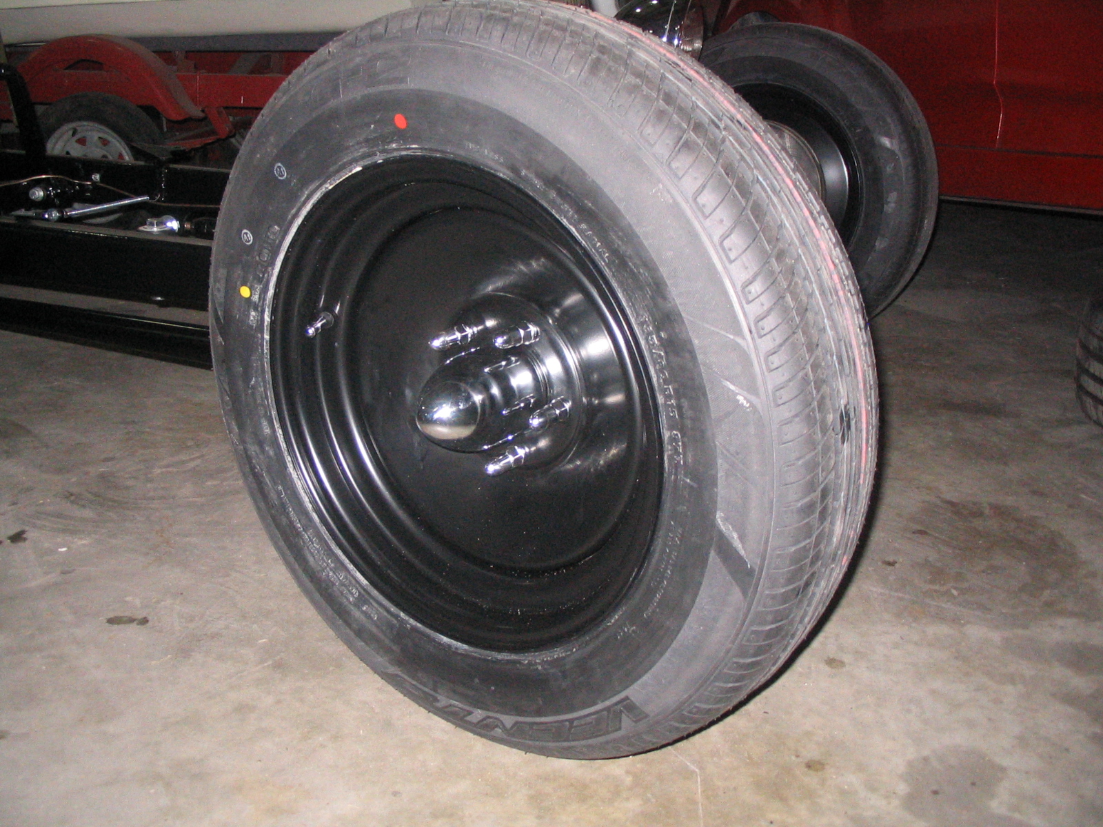

I had gotten the two front tires from Discount Tire and had them mount them. Amazingly, they balanced with no weights needed. I was watching and the guy ran it twice with the same results. Sweet. The rears required a "normal" amount of weight, which doesn't bother me. But with that, I hate the look of weights on a custom wheel. Even the thin stick on type. So, the beauty rings will serve another purpose other than looking pretty. They'll cover those gray weights!
All in all, it was a nice morning. I can't believe I'll have a roller soon. I seriously need the motivation and having my project in roller status will have me feeling good. Thanks everyone for hanging in there with me. I'm 1/4 there!
Why not mount the weights on the inside of the wheel like we do with billet wheels? It works quite well as I've done many vehicles like that including my three present rides.
There are a couple small ones on the inside too! On each wheel. I'm not worried. The beauty rings, like on my old T, will cover them. Worse case scenario, I'l paint them black.

Weights on both sides of the rim means they have done a dynamic balance possible. On the narrow wheel doesn't really make much difference, but on a wide wheel like we tend to run on the back might make a noticeable difference. Of course your mileage may vary, and the wider the wheel the more difference there will be.

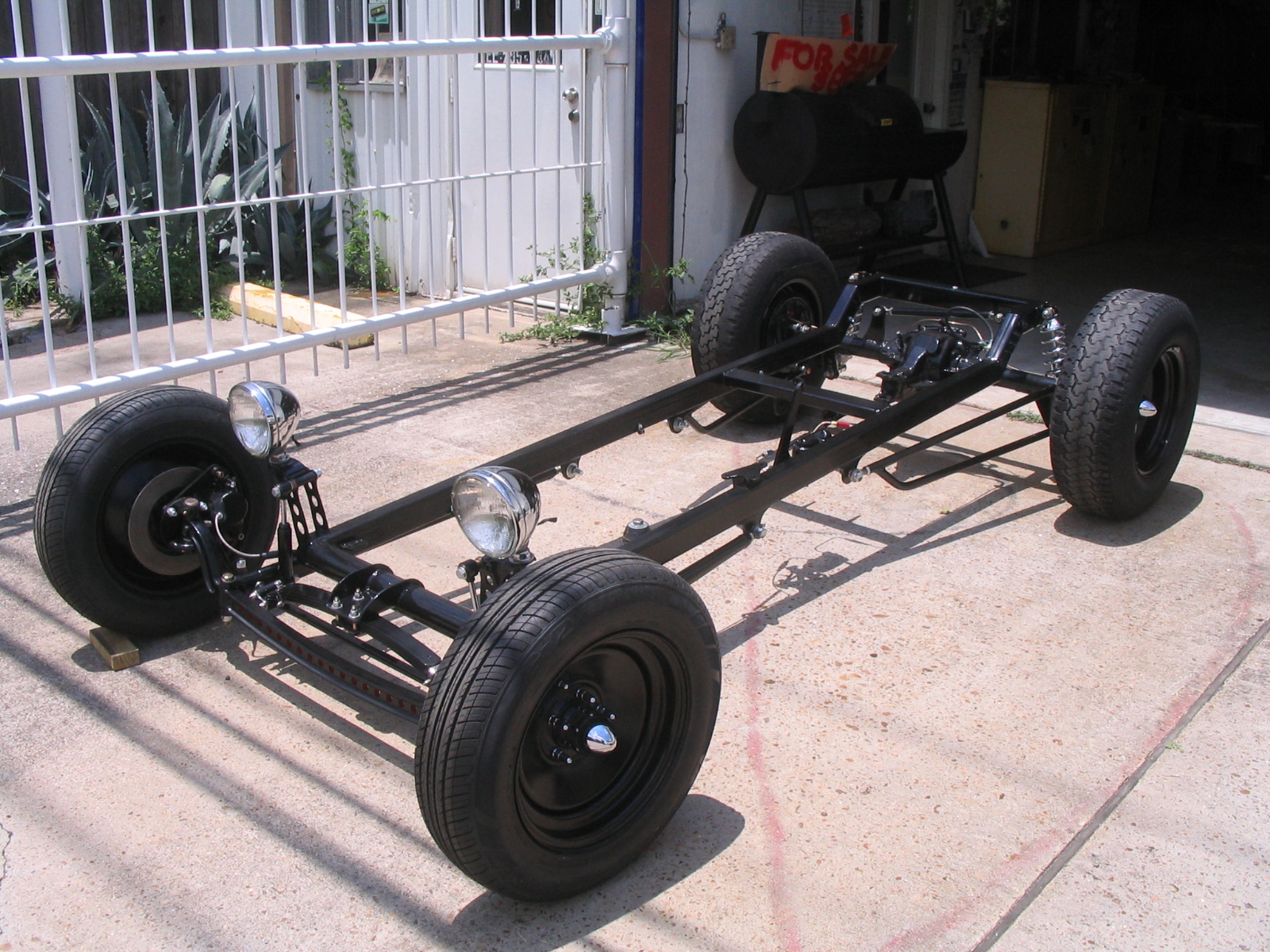

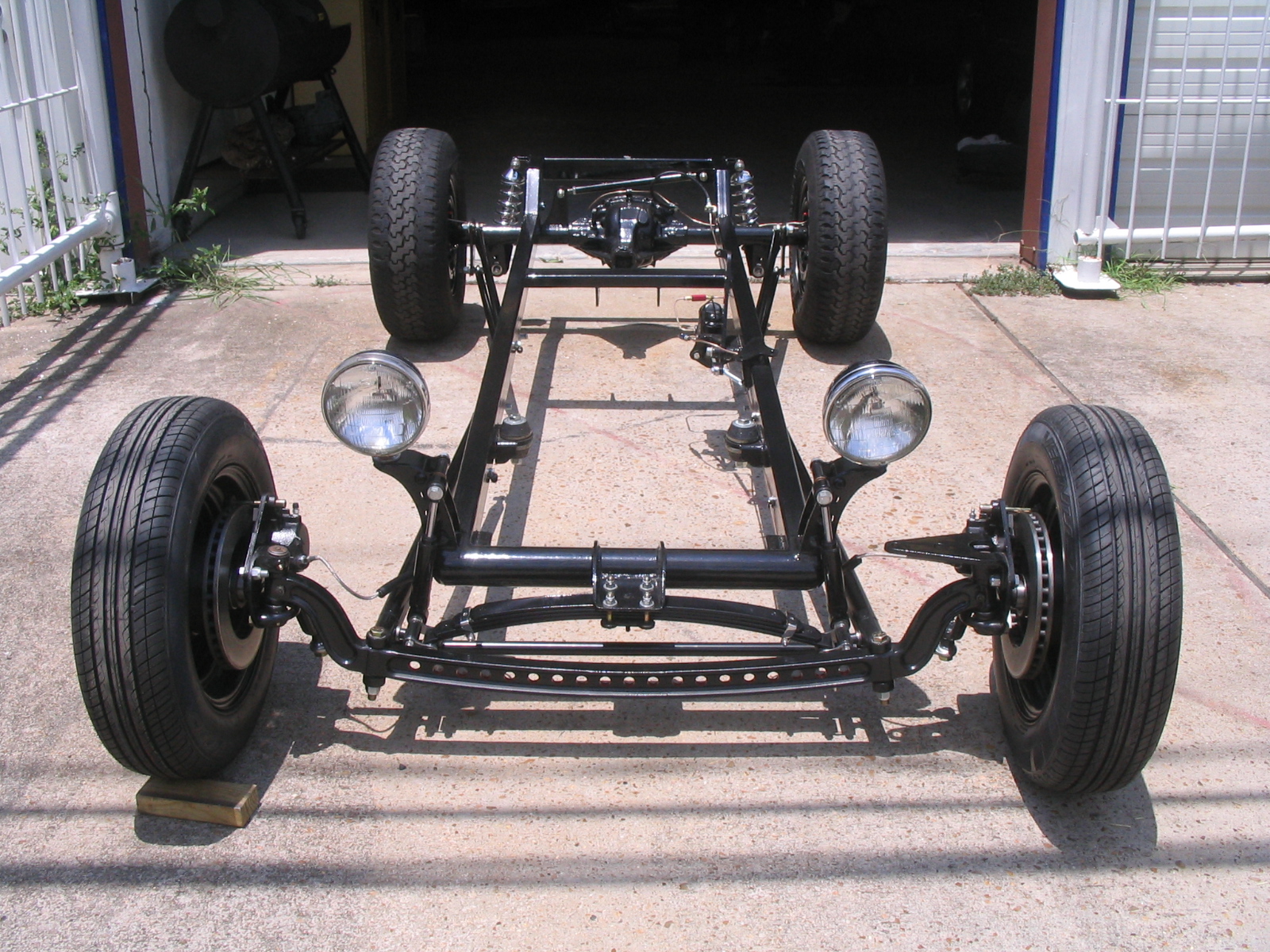

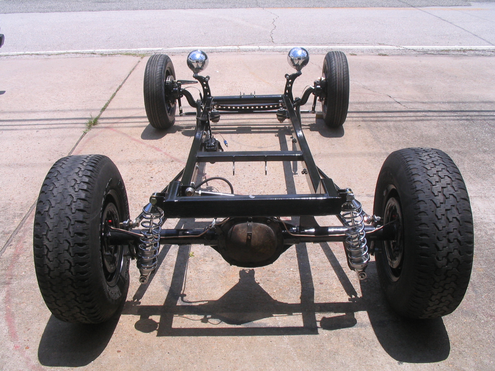

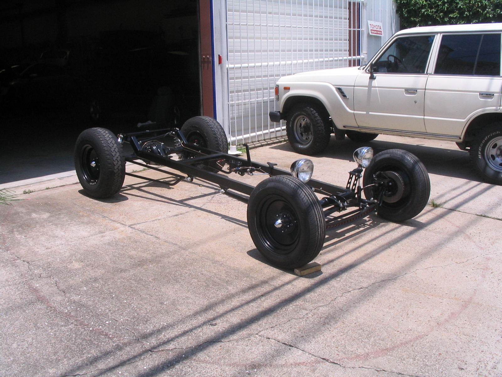

Roller!:D
Beauty rings in a few weeks.
Rings will look great with all that black to show them off.
Got off work and rolled her into the sunlight.
Yep... beauty rings are in the near future.
I've got a cool rear end cover in the works, too.;)
