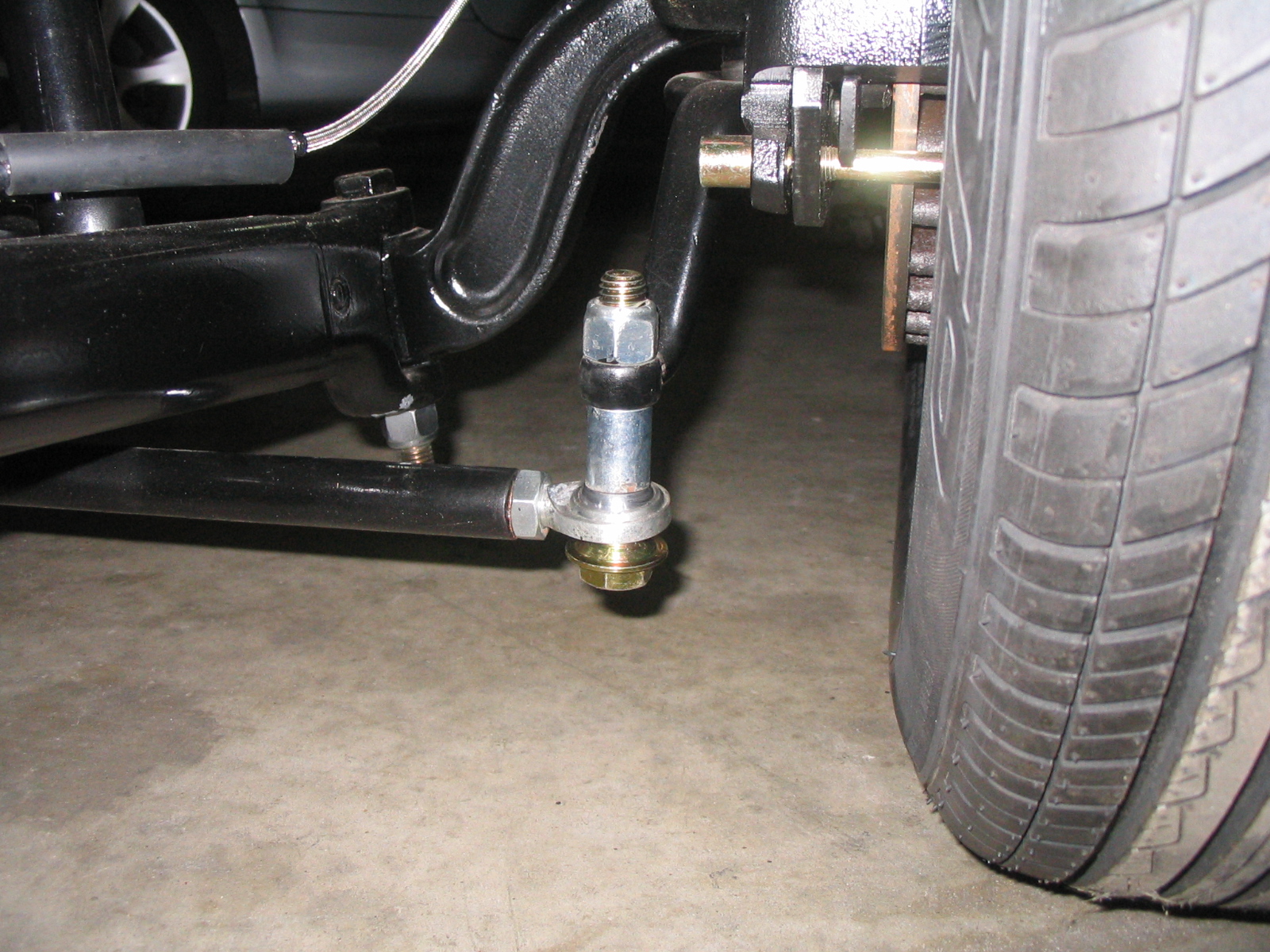

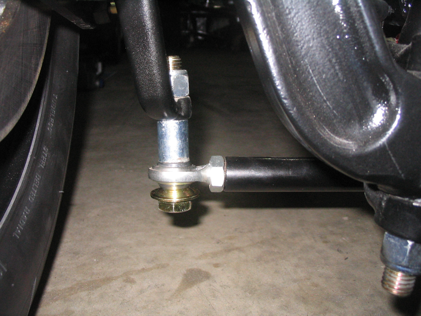

On their way. Should be here Friday or Saturday. Beveled on the inside to cover the ball of the rod end. .0270" thick. 1.432" in diameter.
Edit: 0.270 thick.

Okay...... the safety washers came a day early! But I won't put them on until tonight. Hell, man..... it's 103* in the shop!:eek: I'm glad I Googled a pic to see how they install. I would have had them reversed! Now, I see how they function and they make perfect sense.

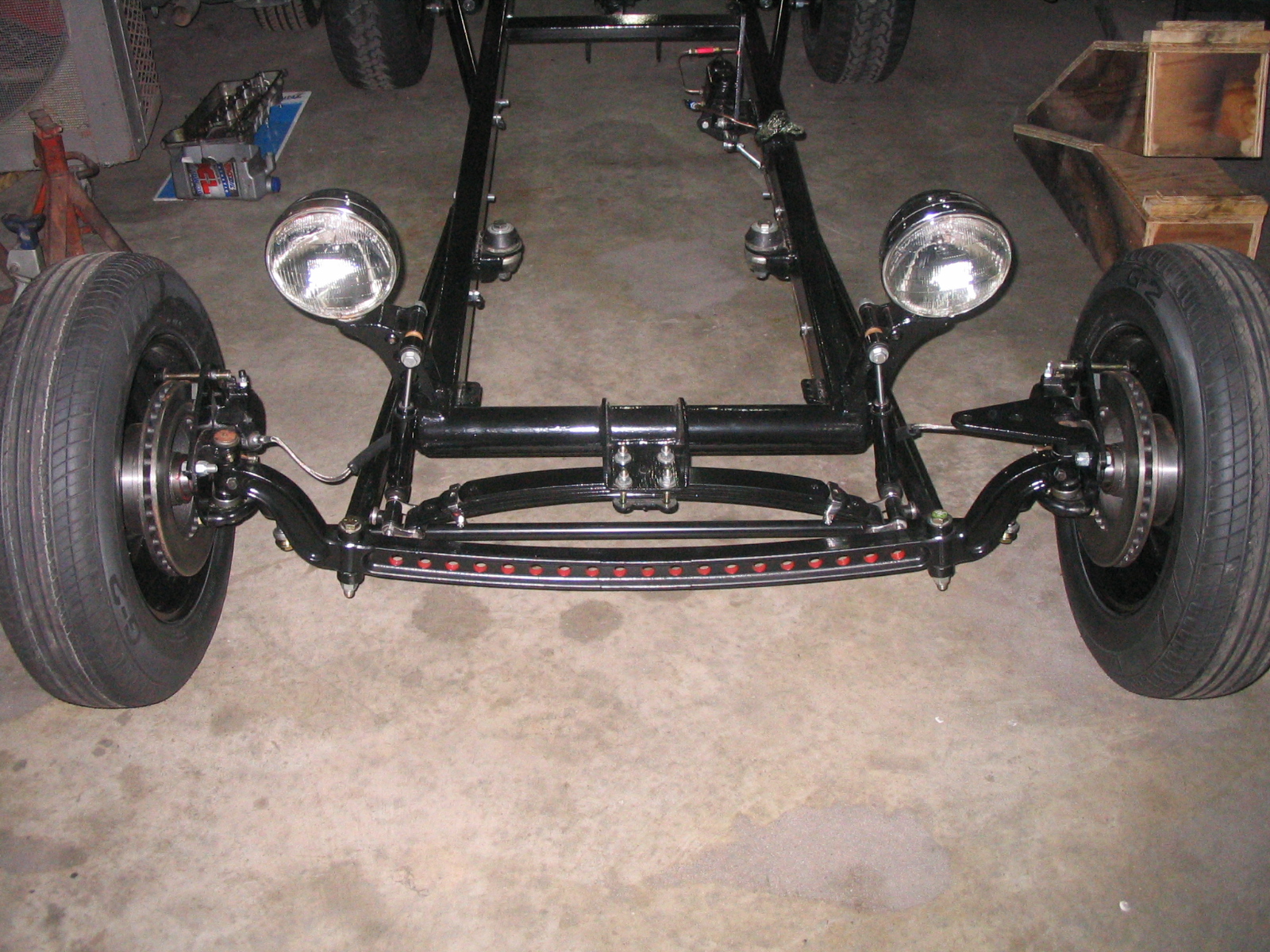

And...... done.
Sweet little chassis! Now . . . what are your plans for the power train?
I have a friend who's been building an engine for me. I've been paying him installments when I can. I'll be getting with him to see where he left off. I had stopped payments, while I finished my chassis. Which he was cool with. Now that the chassis is done, we'll be getting back on track. It's a nicely warmed over SBC. A little better than my last engine from him, which was VERY nice. Originally, I had wanted a BBC, but I decided that I really didn't need it. He was a little disappointed, but understood my decision. This engine should come out to be a 383 ci. Which is way more than what I'll need.
Transmission will be a 350TH. I had been looking at cores to have one rebuilt, but here in town a rebuild is more than a new trans! So, I'll be going with a new one with a 2,200 stall.
