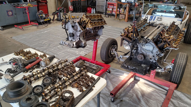

Getting started on the engine work:
Degreaser and pressure washer for the initial rough cleaning. The engine on the left is the 4.4L engine, the one on the right is the 4.0L with the bigger cams desirable double row timing chains.
The 4.4L had a much better maintained life compared to the 4.0L. Luckily the 4.4 long block will be used for the build.
My 1/2" impact gun doesn't have enough oomph to break the crank bolts loose on the engines. They are notoriously over-tight from the factory. Thankfully a shop here in town is willing to break them loose for me with a 1" impact on 180psi
My 1/2" impact gun doesn't have enough oomph to break the crank bolts loose on the engines. They are notoriously over-tight from the factory. Thankfully a shop here in town is willing to break them loose for me with a 1" impact on 180psi.
