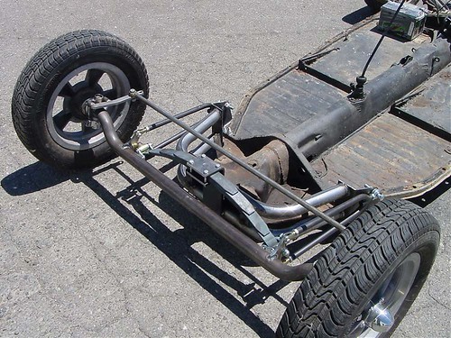

very interesting stuff. V Dub parts are very interesting to me for some reason. I saw a Tbucket with a Dub engine/transaxle in the back and a 3 piece hood that stored the fuelcell...had pretty good handling, old school wire wheels like the car pictured above and to the uninformed was very hard to spot as what it was. I dont know if it was a real bucket or something hand formed; as I couldnt find the owner. I often wondered about using a corvair drivetrain and suspension since T's use the box sometimes. Thoughts?
I like that set up better than the one Speedway sells. Looks as though it could be bench welded. That's a big plus for some of us plus sized guys.

Maybe we are looking on the wrong end for what might be usable. I have a trailer that I use to haul steel on that a buddy built long ago. It uses a rear axle from, if memory serves me correctly, a VW Rabbit. Here are a couple of pics that you might be able to identify. This VW stuff is Greek to me...or I guess that should be German. :lol:
Anyway, the spindle portion is a bolt on piece to the axle with a nice flat back that is perpendicular to the centerline of the spindle. If, and I suppose this is a big if, the wheels and brakes that are what you want are available for this axle, then I could see a fabrication that would bolt to the spindle and have the lugs for the kingpin seats to fit a early ford style axle. Maybe even incorporate a mounting for a caliper in it.
