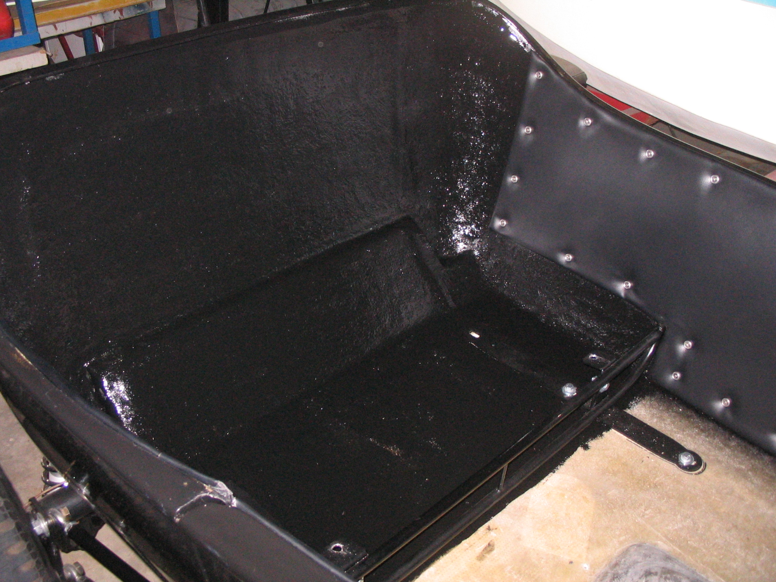

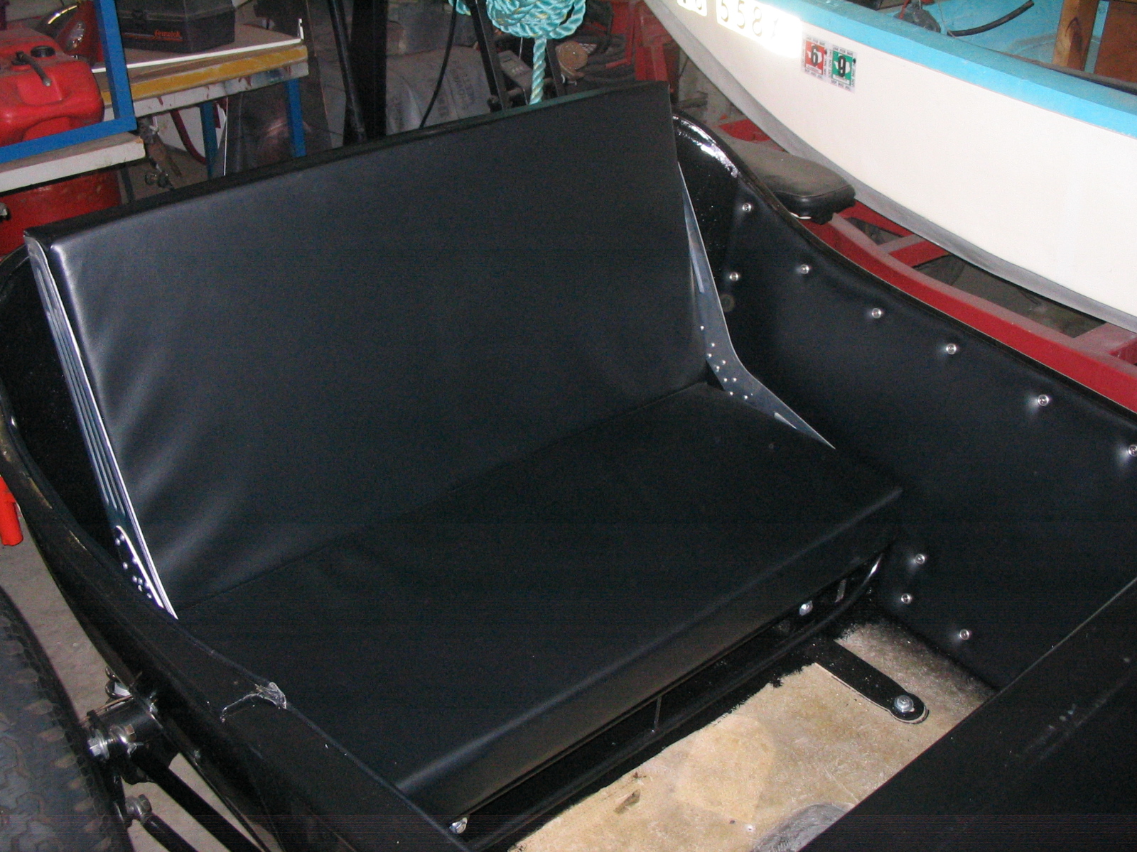

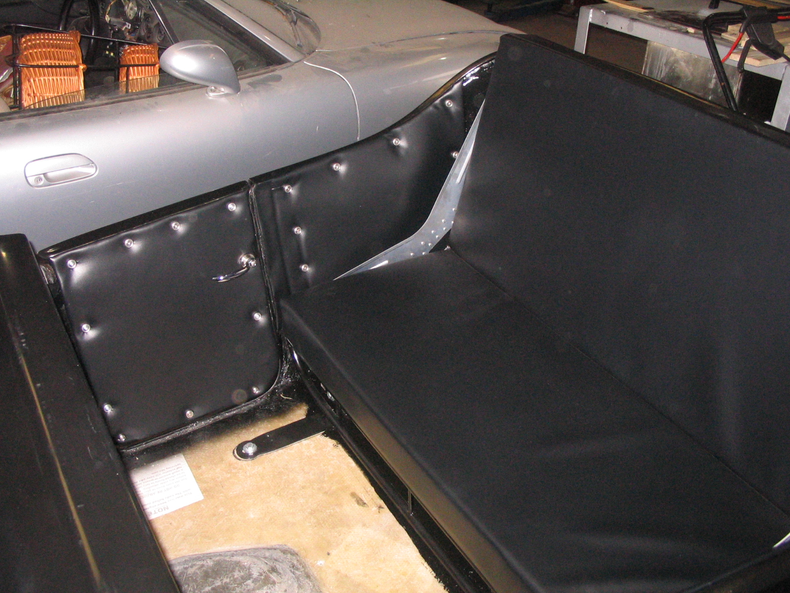

Why not use the Marine Adhesive to secure the Velcro? o_O
I found the weather strip adhesive, I kinda knew I had and bonded the velcro to that body edge and the vinyl material. Let it set over night, clamped in place. Just checked it when I got home from work and it worked like a charm. Thanks!
Hey Fred, what type of backing board, foam, and fabric did you use? Boy, if my interior comes as nice as yours, I will be one happy camper.
I used 1/16" ABS sheets for the panels, but would have preferred 1/8". The CCR body with a door has a support brace that extends to the drivers side and goes about 3/4 up the side of the body. It sticks out a bit and I figured the 1/16" ABS would form over it with a minimal bulge. I was right. But using the 1/16" caused me to use some wood pieces in the voids, instead of foam. For the panel foam I used 1/4" foam from: Foam Factory, Inc. - Storefront And the Marine grade vinyl came from: https://www.marinevinylfabric.com/products/marine-vinyl-fabric?variant=13535168902

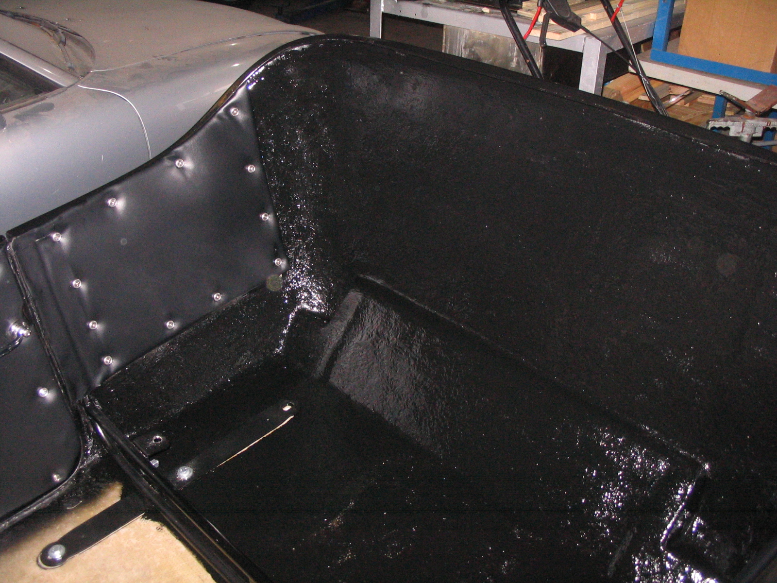

A coat of black paint to finish off the back panel.
It don't have to be perfect, when you can say "I did it myself" !!!
You might consider a lighter coat of paint under the seat if you will be putting your wiring
there. It will be much easier to see what you doing or if you drop something. Or use some
Lexan and mount everything to that. It is harder to keep clean thou.

Well, that's a lot more wiring than I'll have, but I was thinking a contrasting color "jute" material would do the trick.
Can't say I've every seen it done with Jute material under the wiring. Looking forward to seeing how it comes out.
If done right, you can undo the external wiring and lift the whole piece of Lexan out
with all the internal wiring still intact.
It may not be "jute", but something similar. A very low nap material. I used a sheet of rubber liner, in my first T Bucket. Just about anything will work.
