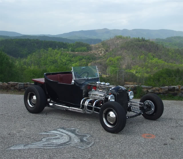

This is the setup that Ted Brown wanted to do to make a Bucket road worthy for long highway trips. He wanted the front spring to go from kingpin to kingpin and long leaves in the rear parallel with frame and the frame under slung the front and rear axles. Age and medical problems prevented him from his objective before he died. RIP

The main ideas I was toying with at the time was using a Satchell link rear setup, with a Curtis style trailing 4-link front for a T track roadster....later more about watts links and isolation methods for more conventional 4-bar fronts and rears.
Double 1/4 elliptical springs act as a 4 bar set up.

I liked the idea of splitting the front axle:

No need for a Panhard. Fat Man made a kit for this, but dropped it due to low interest.
Also like to try a composite monoleaf spring. There is a company (can't recall name) that makes them for Corvettes and I called them a few years ago and they would make a custom one for the bucket. Supposed to have some advantages.
