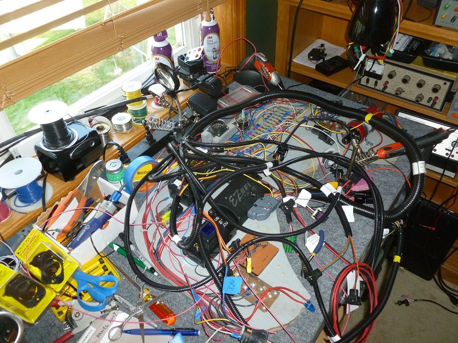

Anyway, I have a MAP problem now. It reads -100 psi, which is not only wrong, but impossible. Wired wrong or bad sensor...I'll dig into it tomorrow.
