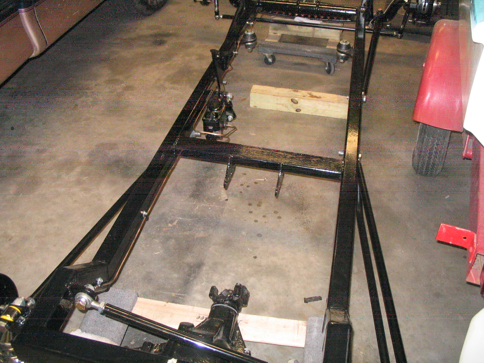

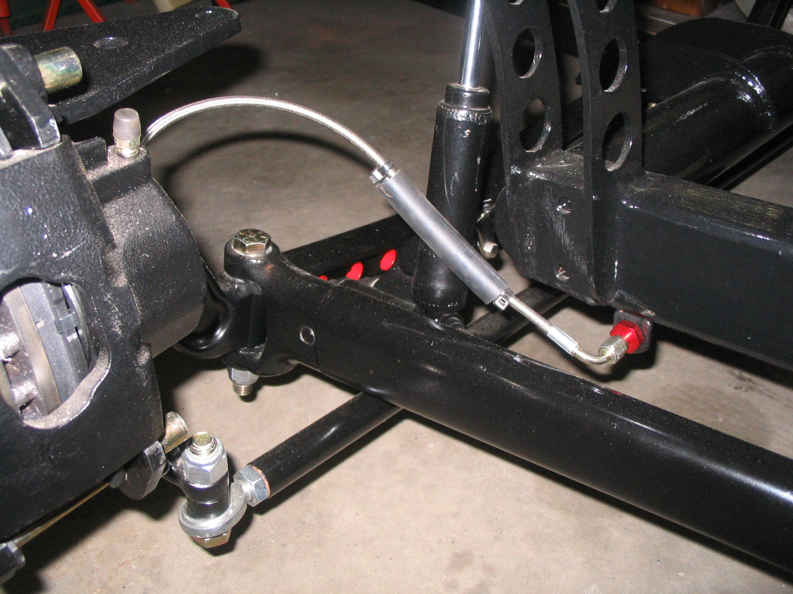

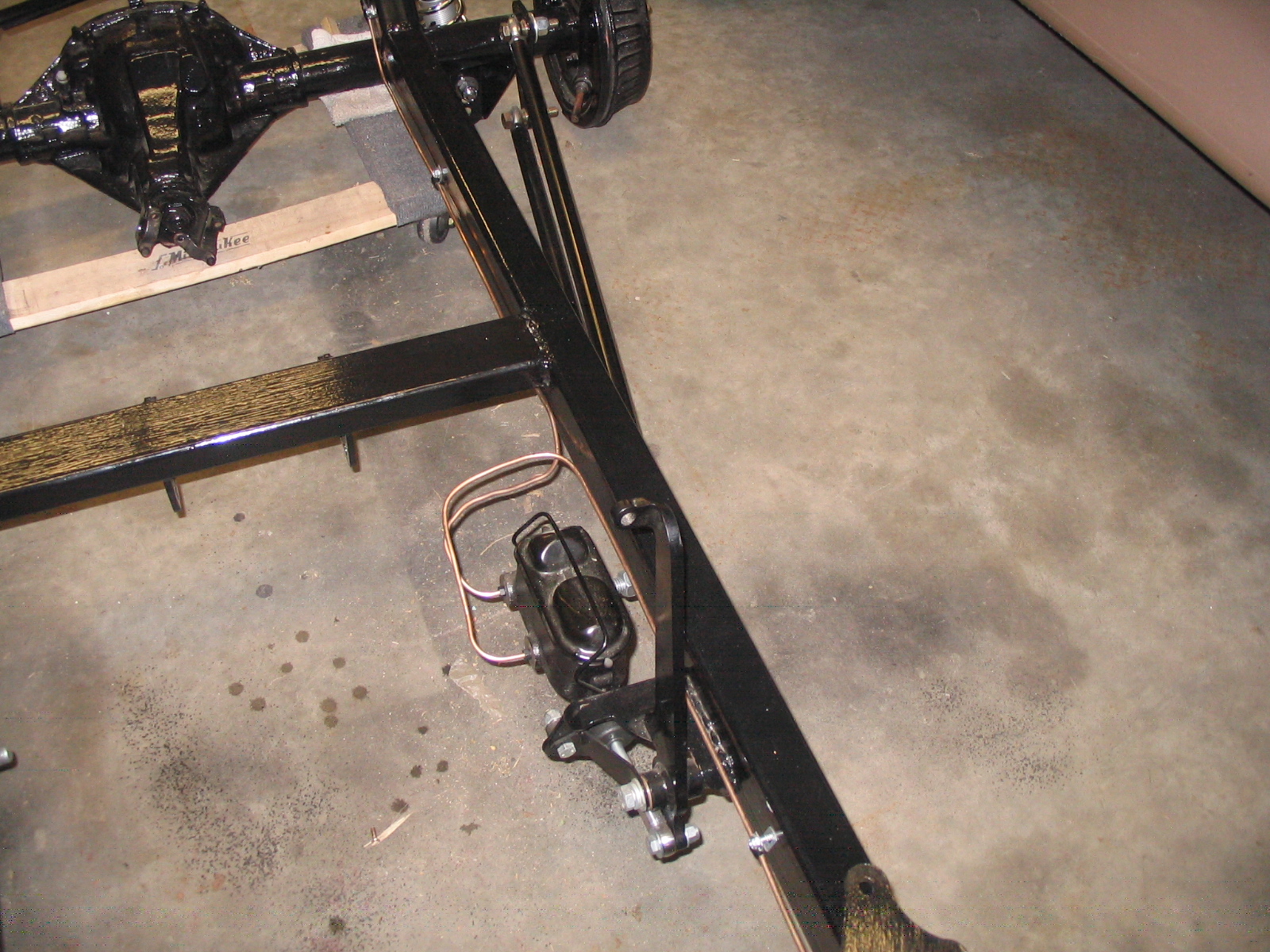

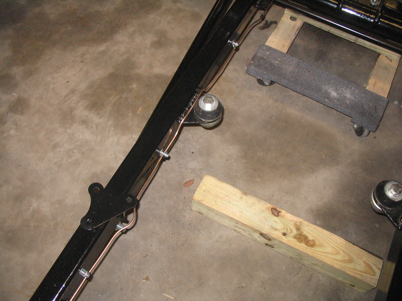

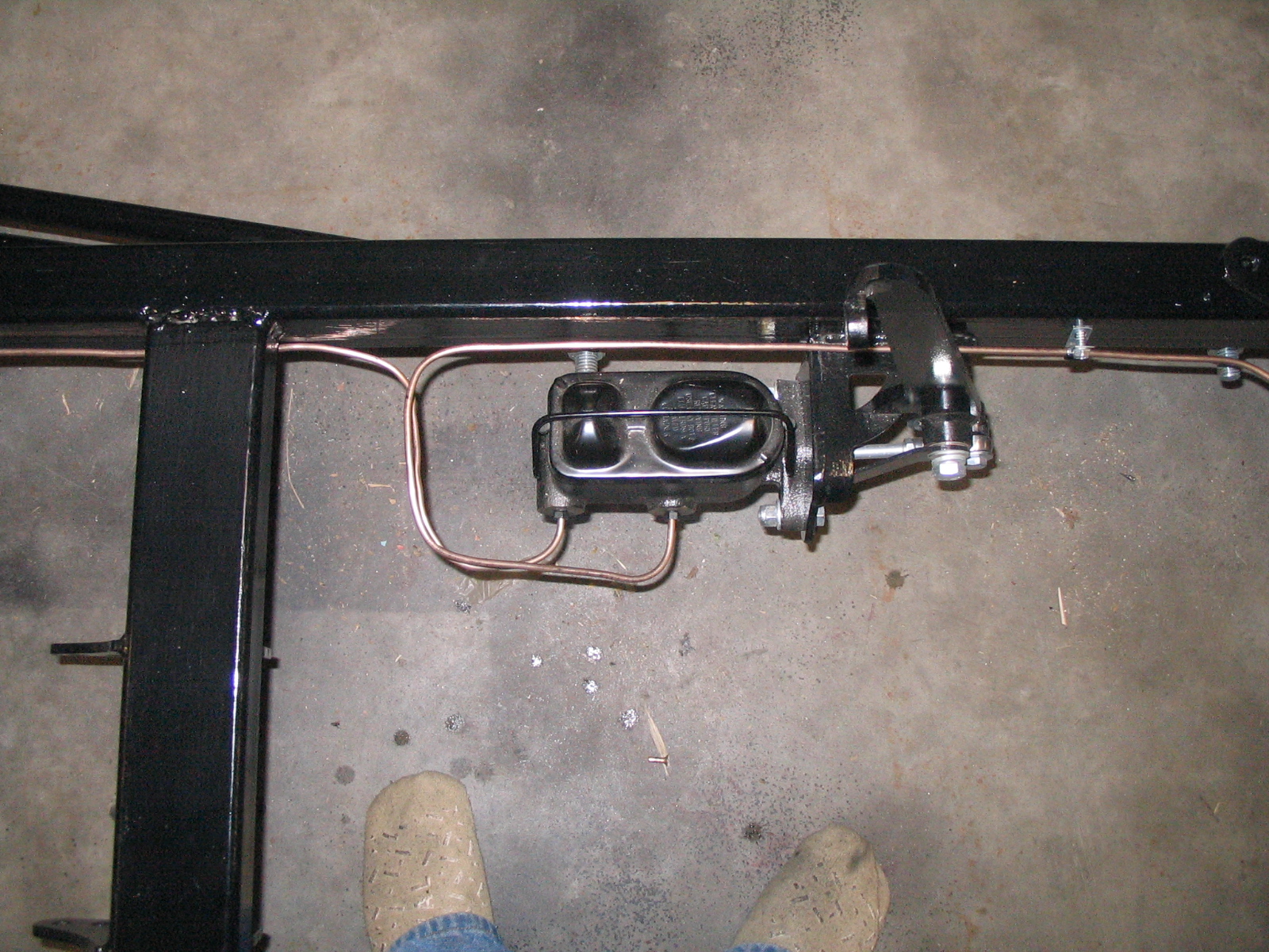

Sorry for the tease. Here's some pics of what I have so far.
I ran this section over the motor mount because of a protrusion below the mount. I may change this later.
The sections coming off the M/C could have been a little better, but I didn't have a tube bender.
