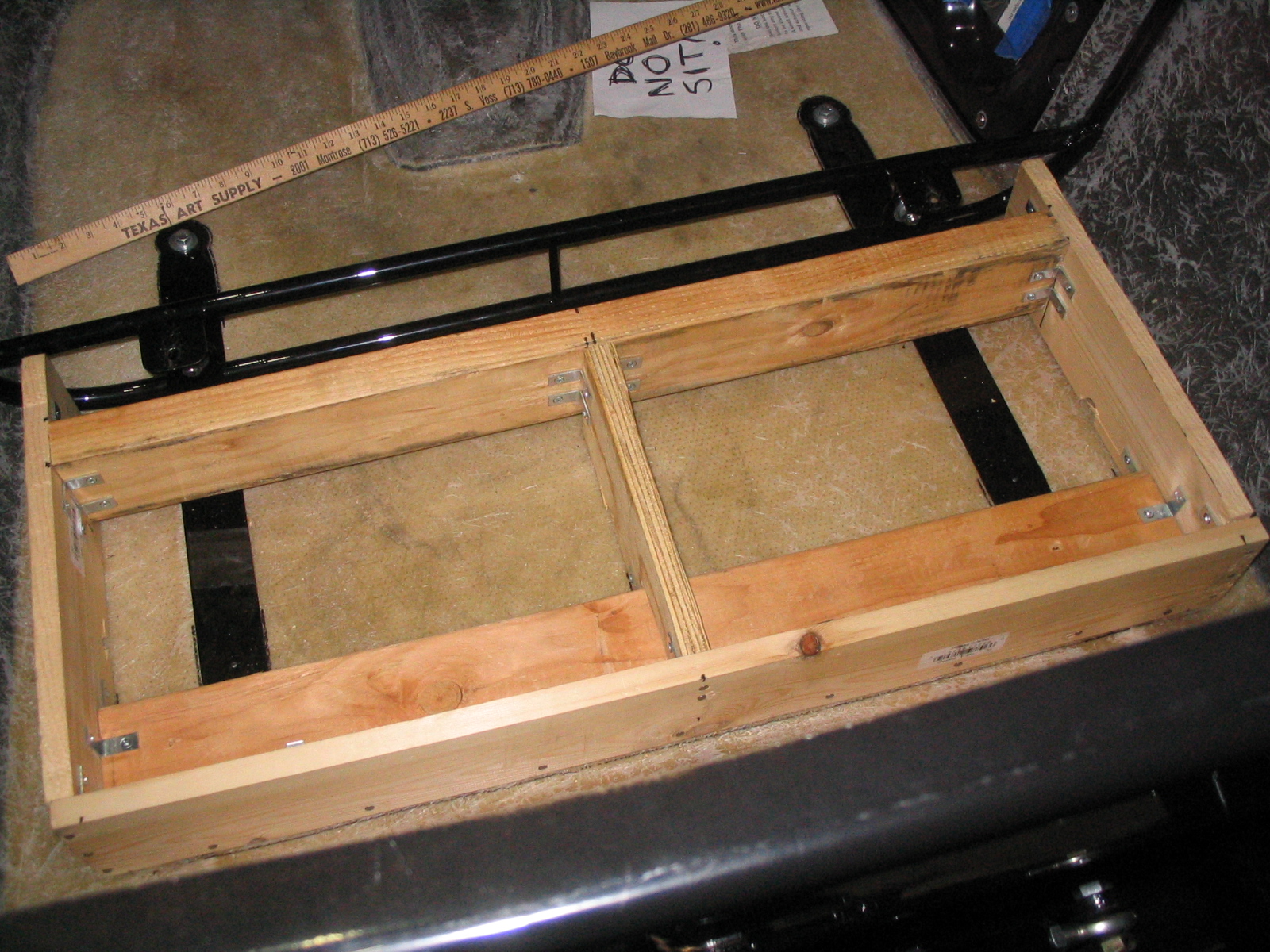

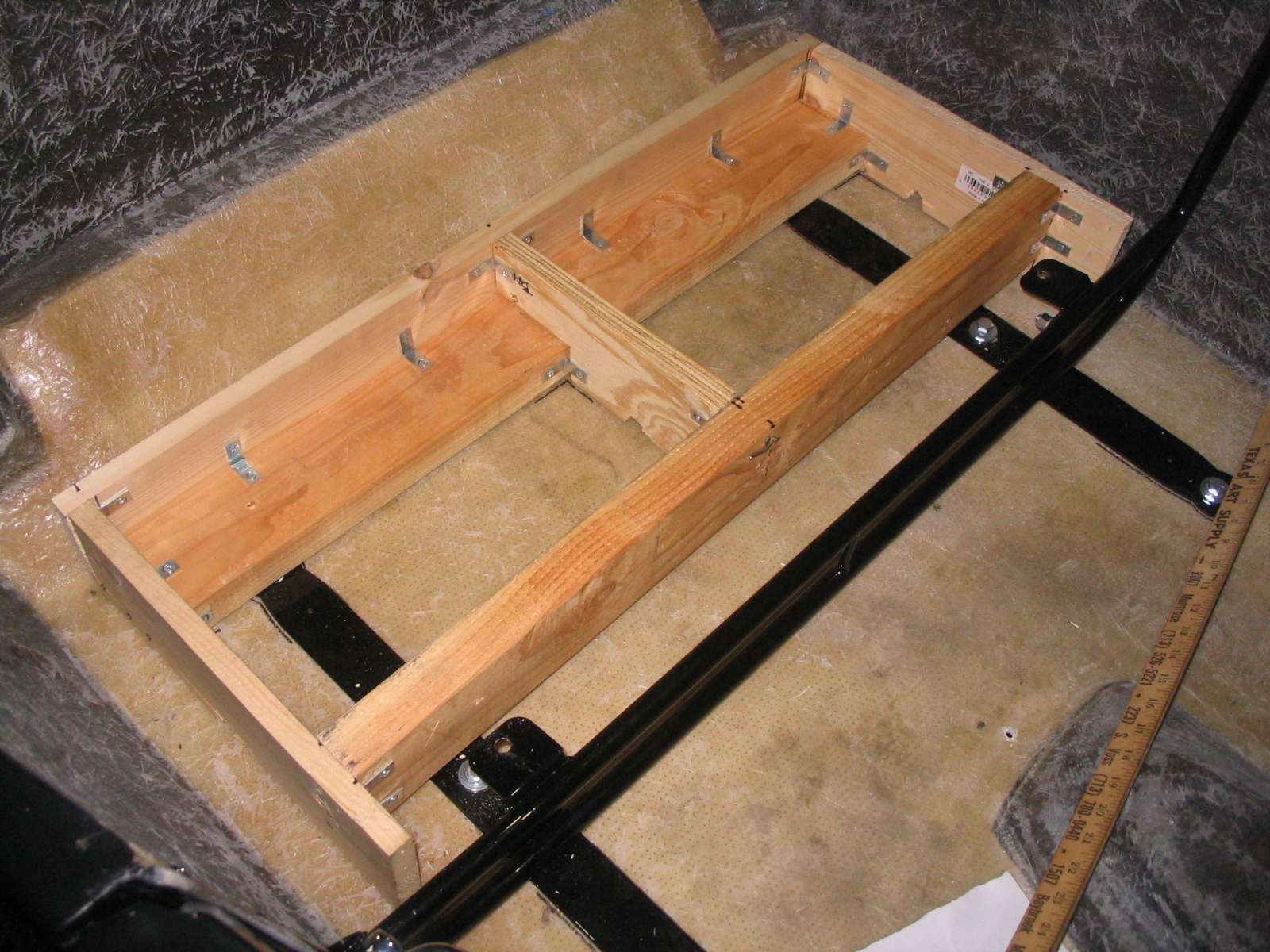

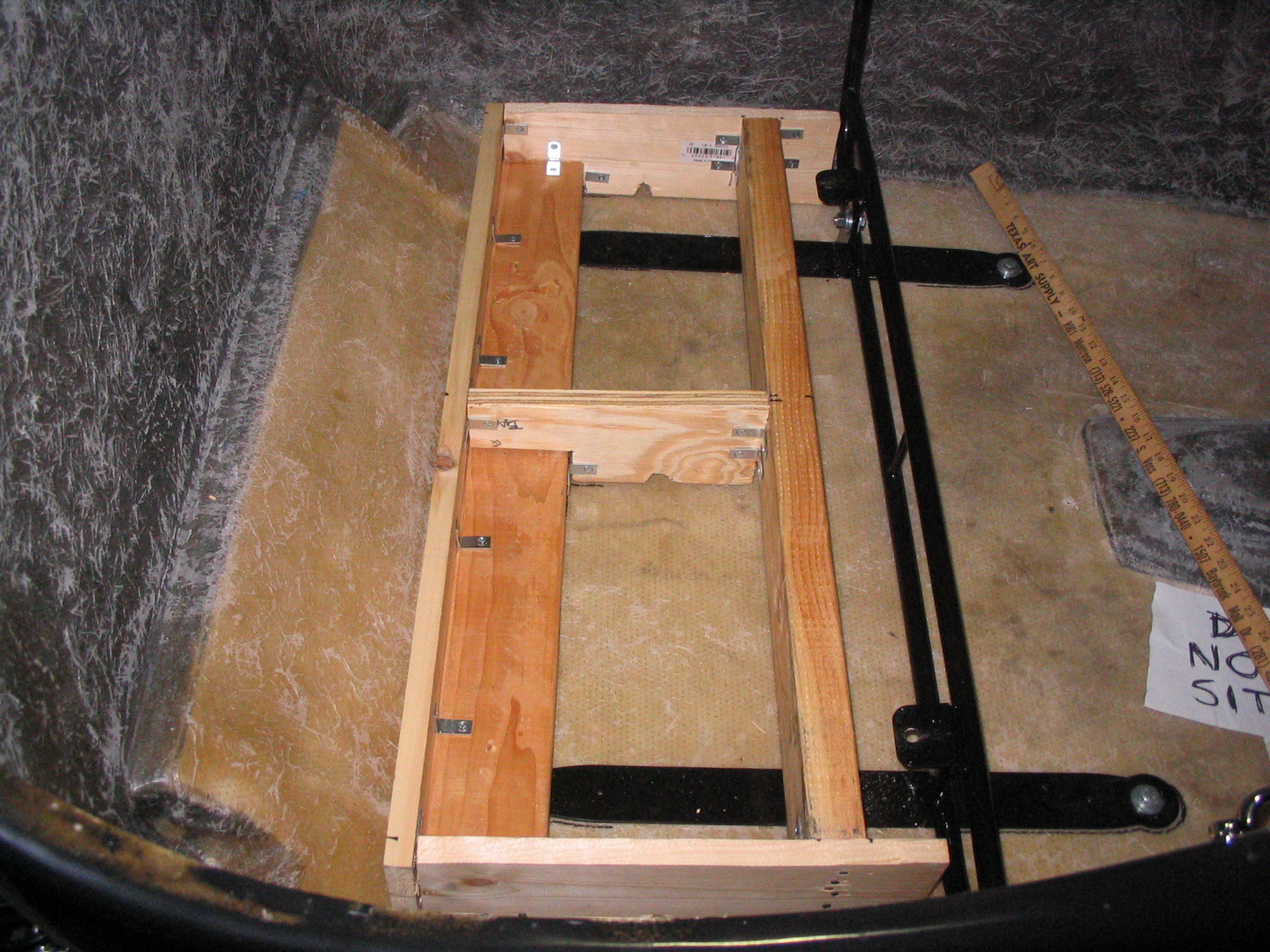

Got off work and loaded up on supplies for the side and back panels. What I didn't get, I priced and noted the location. I plan on building the base for my seat tonight.
The classic rock station on the radio came through. I had already measured and marked my wood. A T Bucket base is pretty simple, so I didn't take any assembly pics. It's just a matter of planning and putting it together so it's strong. I used 3/4" plywood for the middle piece. 3/4" yellow pine for the back and side pieces. Those pieces were attached to 2 x 4's front and rear. I used the 2 x 4's as an anchor for all the other pieces. I installed corner braces in all the corners. I also cut a hole in the lower side of the middle and side pieces, in order to run my wiring through to the fuse box, which will be installed in one of the compartments.
Later today, I'll paint it black and call it done!
That is looking very stout!!! Are you wanting to make the body stiffer with the 2x4s and 3/4 inch plywood?
The body is plenty stout as is. CCR's bodies don't require wood bracing. I used the rear 2 x 4 because I plan to bolt the assembly in through the bottom and as stated, the other pieces are anchored to it, at some point. The corner braces are a bit of over kill on my part. I didn't plan on using so many. They were 98 cents for two at Lowes, so I just grabbed a few handfuls. As I was building, I was listening to the radio and day dreaming. Before I knew it, every corner had a brace on it!:D But since I'm not glassing the base in, that's actually a good thing.
I plan on using a drop down battery box, so I won't need to cut out a battery access hole. I was going to paint it today, but it's 47 degrees and raining here. I'm wussing out and staying warm, planning the side panels. The foam and material won't be here until early next week, so I'm just kicking back and researching how to upholster those dang rear corners. I have a couple ideas already, so I'm really just trying to decide which way will look better.
