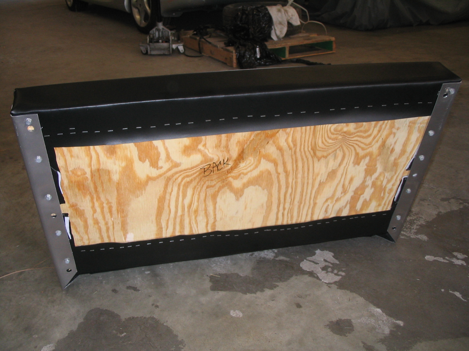

If you are trying To hold the sides to your wood screws will never hold straight in the plies. Bolt a piece of angle to the sides and bolt the angle with t nuts through the seat.

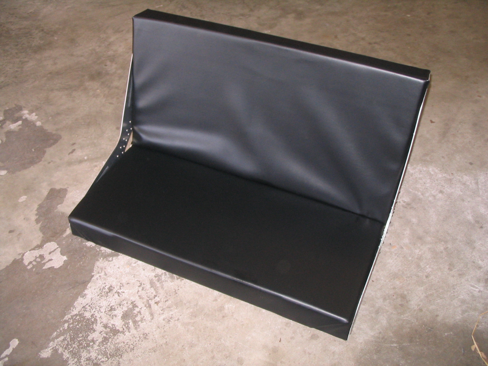

Has anyone tried these angles? Looks like with the bottom being flat instead of tilted up, you will want constantly slide forward. The research I have found is saying 15 degrees up and back. I am going to make a set for my 27 truck.

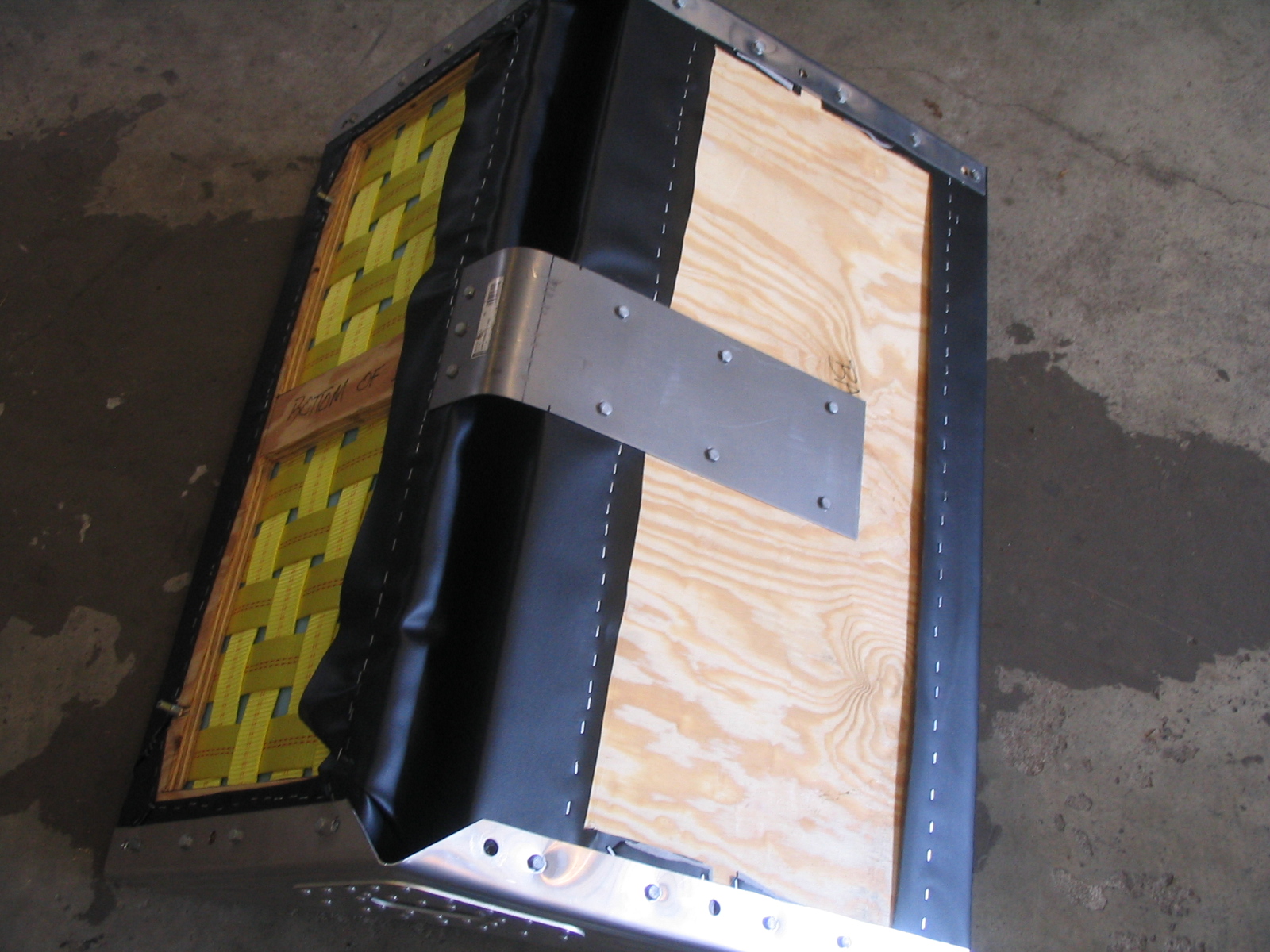

Are you going to be running your electrical under the seat? Just a little concerned
with that metal center brace.
How thick is the aluminum (stamping?) for the seat sides ?

Sorry, but I still don't understand. I guess it's not important, you seem to have it covered.Yes and that metal brace s a non-issue. How could it be?The metal section that's under the seat will be covered by the back piece of the seat base.
