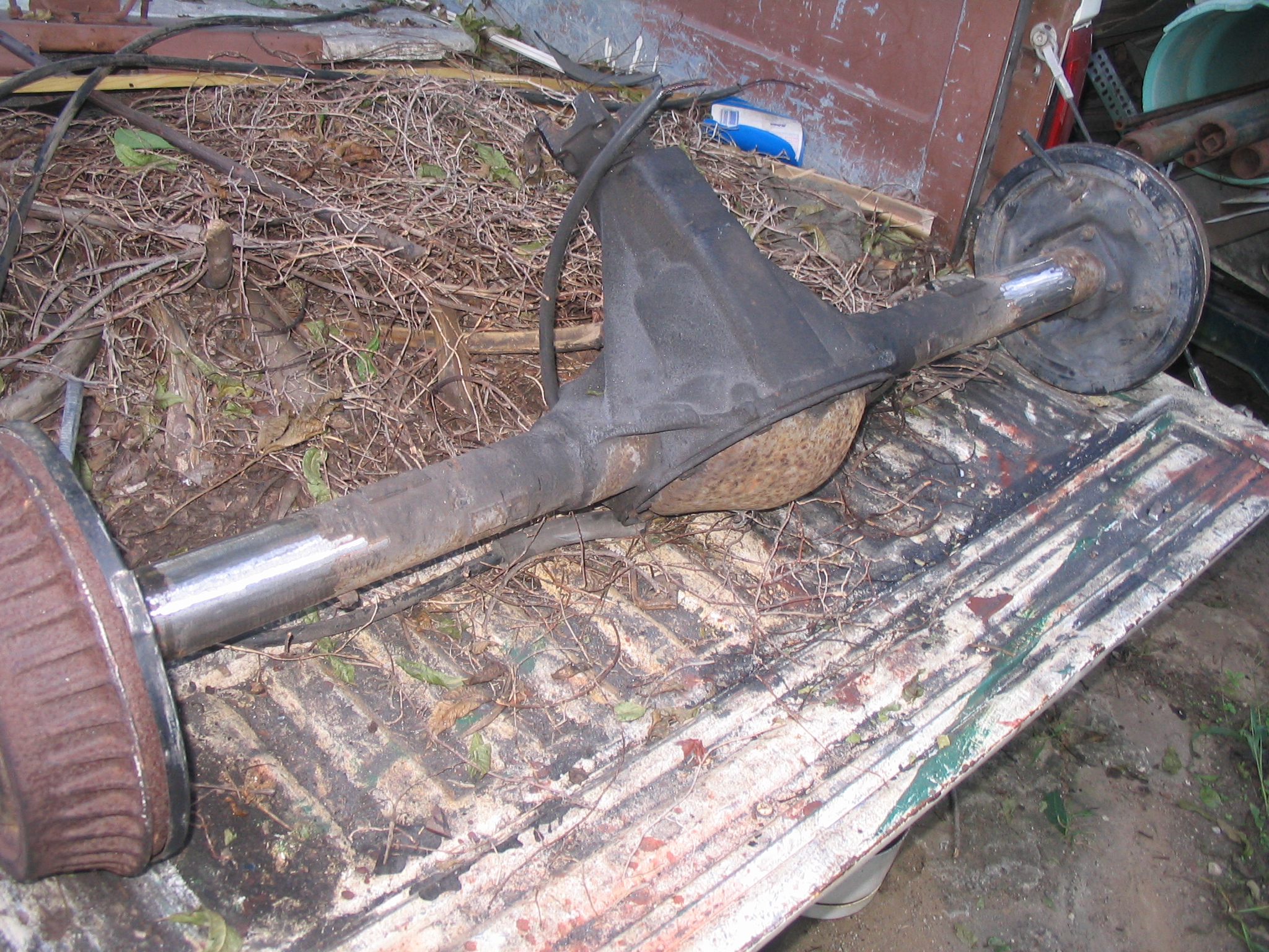

One side down and one to go. I'm working outside, "shade tree" style. I've lost my shade, and the heat index is 96*, so I'll run some errands and get back after it in a few hours.

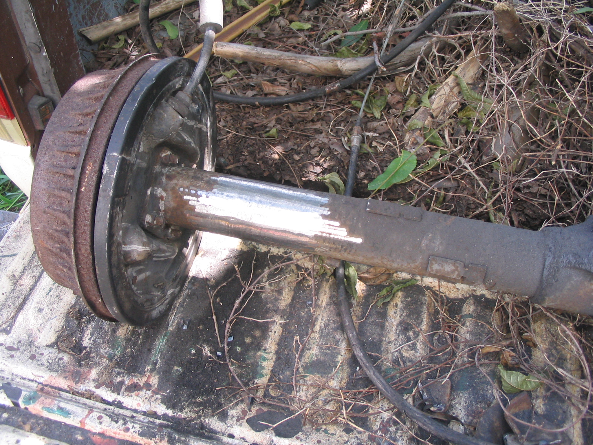

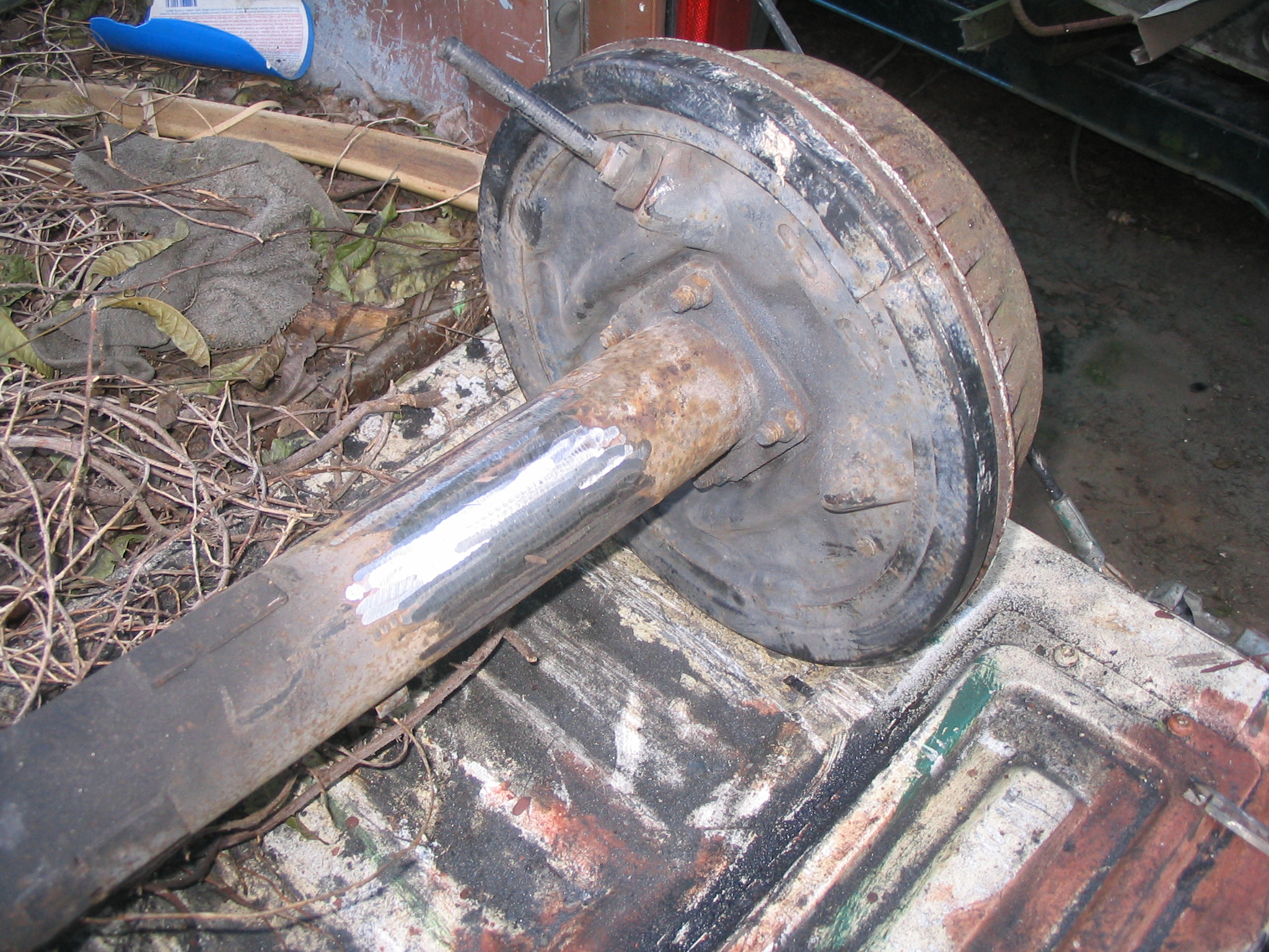

I used a small Makita with a 4" cutting disc. Then, I used a BF grinder. It didn't take as long as I thought. The hardest part was getting started. So far, it looks like I'll be able to use the factory brake line tabs. But I won't know for sure, until I lay out my suspension brackets.
Heat is your friend on rusted or frozen fittings. It expands the metal and breaks the bond. Cut off wheels are the bomb! I use them on everything. I like the six inch ones, the thinner, the better, they cut better and faster than the thicker ones. Also if you by buy the ones designed for stainless, they last longer.I hear ya on that hardest part!
I have an angle grinder, and cutoff discs, but I've never done any cutting.
I've already run into problems with the brake line tabs on mine. After repeated doses of WD-40 and Sea Foam Deep Creep they still will not budge. I'm afraid I'm going to have to grind the heads off. The only suspension brackets I have to deal with are the two bag brackets. I'm using the factory link brackets, so no worries there.
I've been reluctant to try heating because of the warped axle tube stories I've seen. The grinder and cutoff wheels I have are 4"...and to be honest thin enough that I have worries about them shattering and becoming shrapnel. I've not noticed stainless wheels...I'll look for them.
As far as removing brackets, I always use a cut off wheel to cut the welds just above the housing. If the bracket is complex, I cut it apart as I go to minimize the stress on the wheel and allow the cleanest, coolest cut to the housing. After I get the bulk bracket and weld out of the way, I grind and sand the remainder smooth. Again, if you let the blade do the work and dont rush or force it, the heat will be minimal.
 I sliced those suckers out in easy to manage pieces. I'm going to grind and wire brush the rear end, but it'll be later. Like maybe this Saturday.  Maybe. Gotta stay busy and get ready for Ron's rear suspension package. So far, I'm on track, as far as having a rolling chassis, by the end of summer. After that, my journal/build thread will get boring because I'll be putting the coins away for the engine, trans and body.
