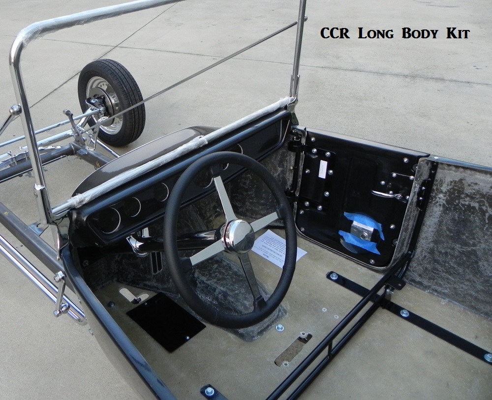

Really like this interior.
don't think they would like the volume .. but the interior goes with the engine bay.
I think it is about bringing those to things together with the offset of the paint on the bucket.

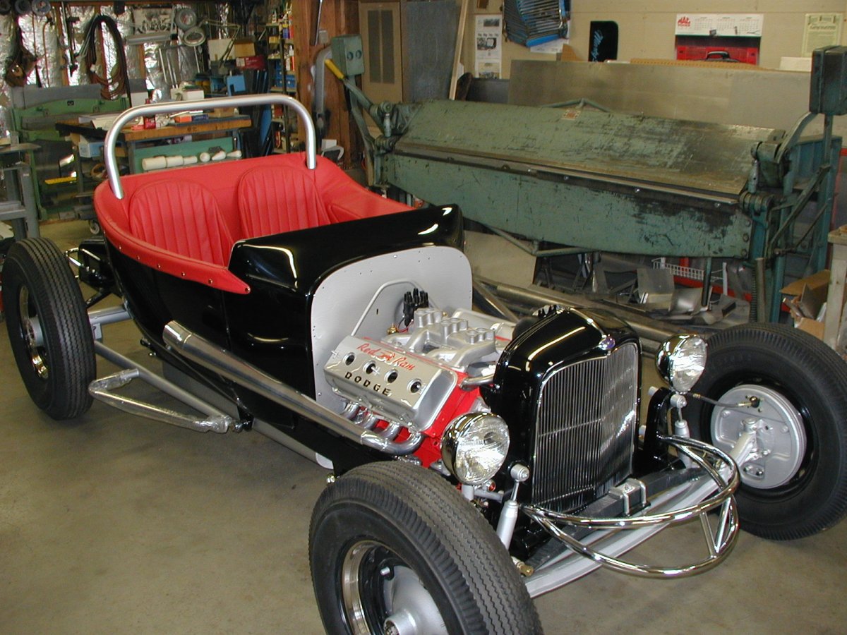

I would love to see more pics of that car!
Built and owned by Marty Strode. He's a well known Hot Rod builder, racer and master fabricator. He's on the HAMB, but I think he may be on Facebook.

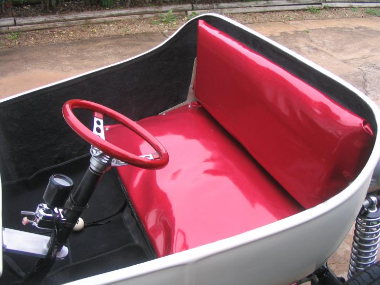

So, with a day off and a HUGE breakfast, my thoughts are back to interiors. My cars going to be black with a red interior, so that's why I posted Marty's track roadster. The Bomber seat idea is still an option, but looking at pics from my previous car, a simple bench seat is always a good look in a T Bucket interior. While not as race themed as Bomber seats or buckets, the comfort level is a lot better. Here's my last seat and interior of "Miss Behavin'". Perhaps, this time I'll use a permanent, wrap around back and make just the bench removable. I'd like to do it myself. The main issue would be the corners in these bodies. It's a series of curves. Getting the fit in those corners would be a challenge.

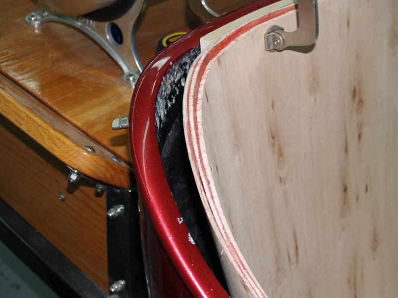

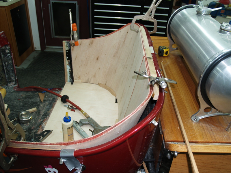

Fred, if you check out the thread that I posted on how I built my seat, you'll see how I handled the curves to which you are referring. My seat is easily removable also.
It's not that hard. I used 3 layers of 1/4" bending plywood and made a totally removable insert.
