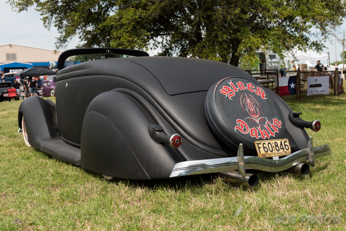

Yup....... 10:30pm last night, hanging with some friends and net surfing, when my good buddy says, "Ya know Fred, it's like you're rebuilding your old car. You should call it "Miss Behavin'". That idea lasted about 5 minutes. "Miss Behavin'" was my first Hot Rod and I loved the journey. But I made a LOT of mistakes and lost a LOT of money having to redo things. But she was a learning experience. I'm glad I kept notes and pics. I've used them to stop myself from repeating those same mistakes. So, "Black Dahlia" she'll stay.

That is a very clean looking ride! I like the use of the generator, it adds to the nostalgia effect. Always love a tri- power!

Are you sure you want to name your car after one of the most brutal murders in history?
Elizabeth Short - "Black Dahlia".
That's some bad Ju-Ju.
That name has been used for a few cars and I'm not superstitious.

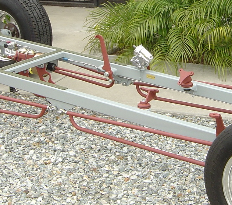

I'm reposting Resinators in my build thread, where I'll have them handy. The are the location of the transmission cross member and the motor mount.
"So here are the dimensions off the Extended body frame we have fully assembled in the back.
All these are from the top of the main rail where it meets the 45* kick-up
To the back side of the 1.5"x 3" transmission crossmember = 21 5/8"
To the pedal pivot centerline of the master cylinder bracket = 41 1/2"
(down 2" from top of frame to C/L pivot)
To the center of the motor mount bracket on the frame = 63 3/4"
(down 5/8" from top of frame in front, tip downhill toward rear 3-4 degrees)
These dimensions are out of our fixture so our long body fitment will be correct.
There is room to go forward 1/2" on the motor and trans dimension if you want more clearance at the distributor and steering box but do not move the brake pedal bracket"

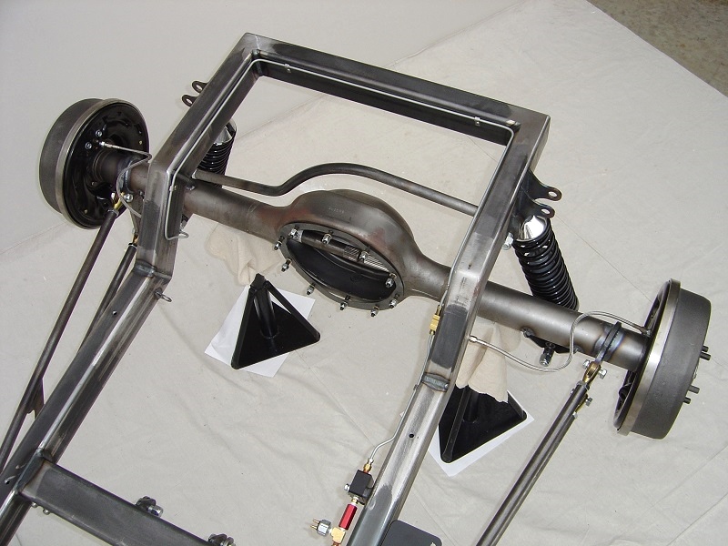

Next step....... rear suspension. Notice the placement and angle of CCR's radius rods. VERY nice. I'm hoping to have Ron's kit by the 1st of next month.

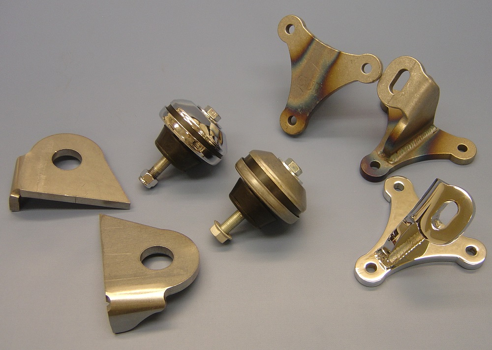

Back on track. While this isn't mine, but mine will be similar. Today, I got all the measurements for mounting my brackets on my frame, from Resinator. This way, I won't need an engine & transmission as a mock up to weld in my brackets, Next will be my rear suspension pieces from Ron. With the info I got today came a lot of much needed motivation. It's great to begin to see the light at the end of the tunnel.
I sure like the looks of those engine mounts
I like the "biscuit" style too. I've never used them, but a lot of people do. They look plenty strong.
