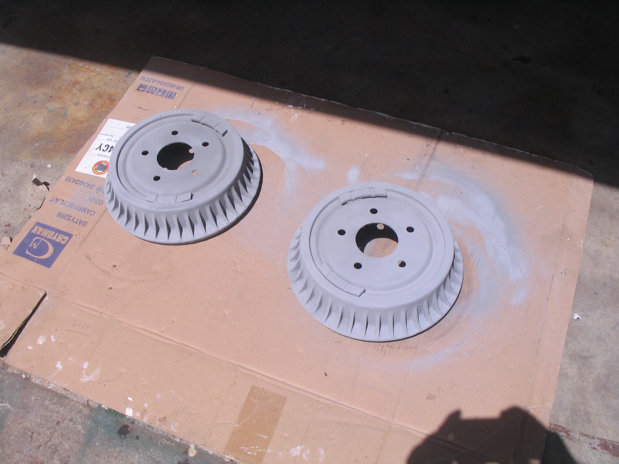

Tomorrow, I think I'll clean those drums up. When I was looking at my frame last night, they were buggin' the hell out of me. Every little step, is a step forward.
That's how I am. My gut usually dictates my actions.
I've learned to trust it and go with it. Even minuscule things that bug me have to get corrected.
Got up early and did some grinding and painting on the drums. It was mostly surface rust, so I didn't expend a lot of time and energy on them. Being out of site, a good cleaning was all they needed. A couple coats of primer and, if I get a wild hair, I'll paint them black tomorrow. I love the fins on drum breaks. Heck, if I could afford them, I'd run a set of finned drums up front. Maybe when I'm playing on the internet, I'll see what's out there.;)
The edit timed out on me. I used a wire wheel, NOT a grinder, on the drums.
I got lucky and found a great deal on rear brakes for my tri five rearend at rock auto. They are high quality parts, finned drums, even have a nice painted surface. I got both wheels including everything, springs, wheel cylinders, hardware, drums, etc for less than a bill including shipping. Overstock or old inventory, I guess. Anyways, I tried this rust remover from my local farm supply store that you just soak the parts in, and it works well. I tried it because I have some wood working equipment that has sat and all of the parts rusted. I was shocked how well it worked. You just let the parts soak, check them after a day or so, rinse them with water and re dip them to prevent flash. You might try it on stuff that doesn't have scale, etc to save some effort. The stuff can be reused. Ive had it for over a year and it still works. I think it's called evaporust or the like. I will look when I go to the shop and confirm or correct.
Thanks. Not sure I'll need it any time soon, these drums were the worst and they weren't that bad. Just a layer of surface rust from sitting in the salvage yard. But cleaning stuff like that is always worth having around.

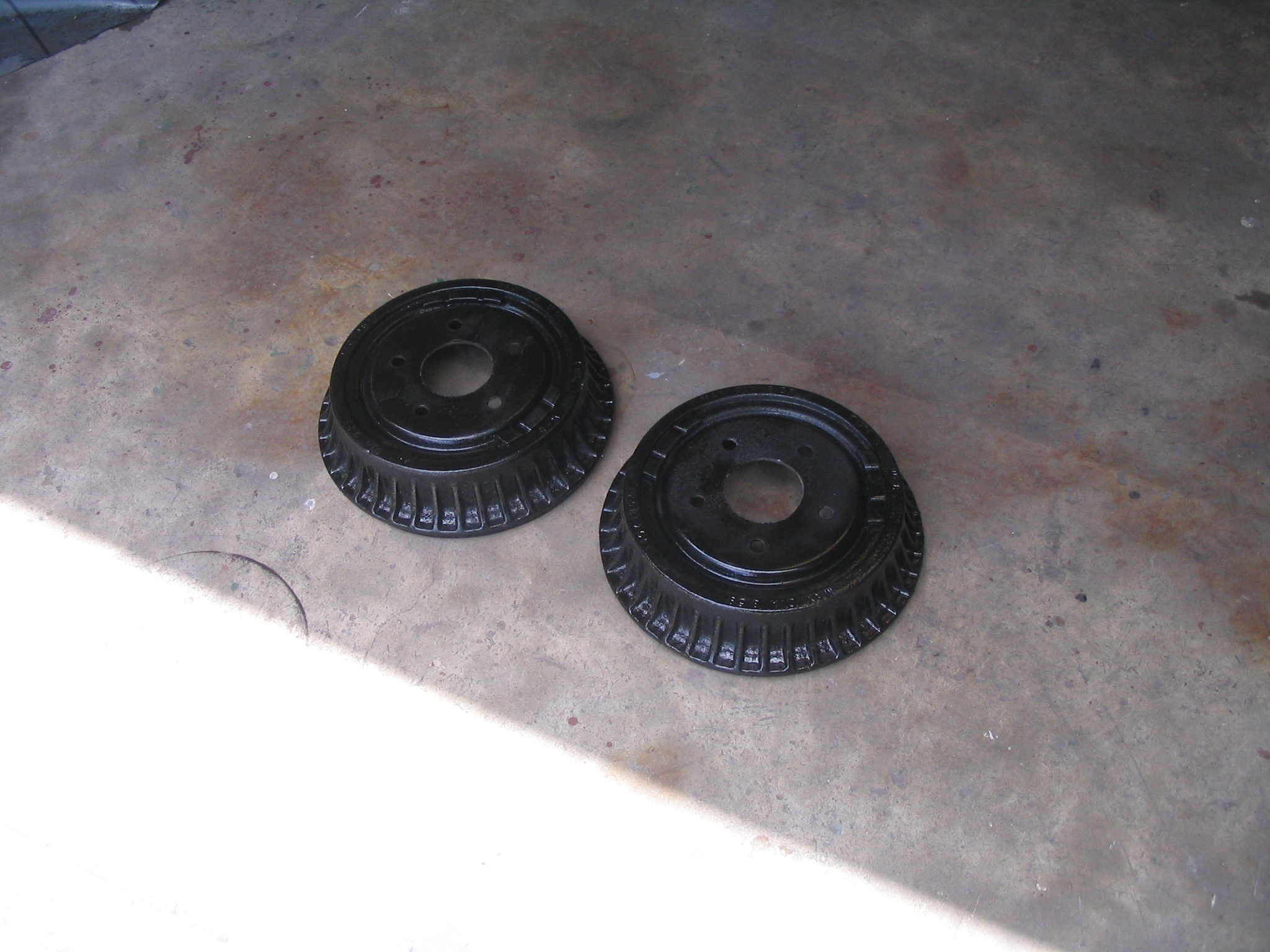

I some how, grabbed the faces of the drums and forgot to wipe them down with a tack cloth. The result is some bad spots. I'm debating whether of not to redo them. They won't really be seen and they are, after all, just brake drums. I'll see how bad it bugs me.:D
We won't tell. After I had my car on the road for 2 years, the front rotors kept bugging me about the rust rings where the pads didn't touch. Finally I had to tear it the rotors back off and paint all the bad areas.
I just finished repainting them. Couldn't help myself.:p It would have bugged me too death.
