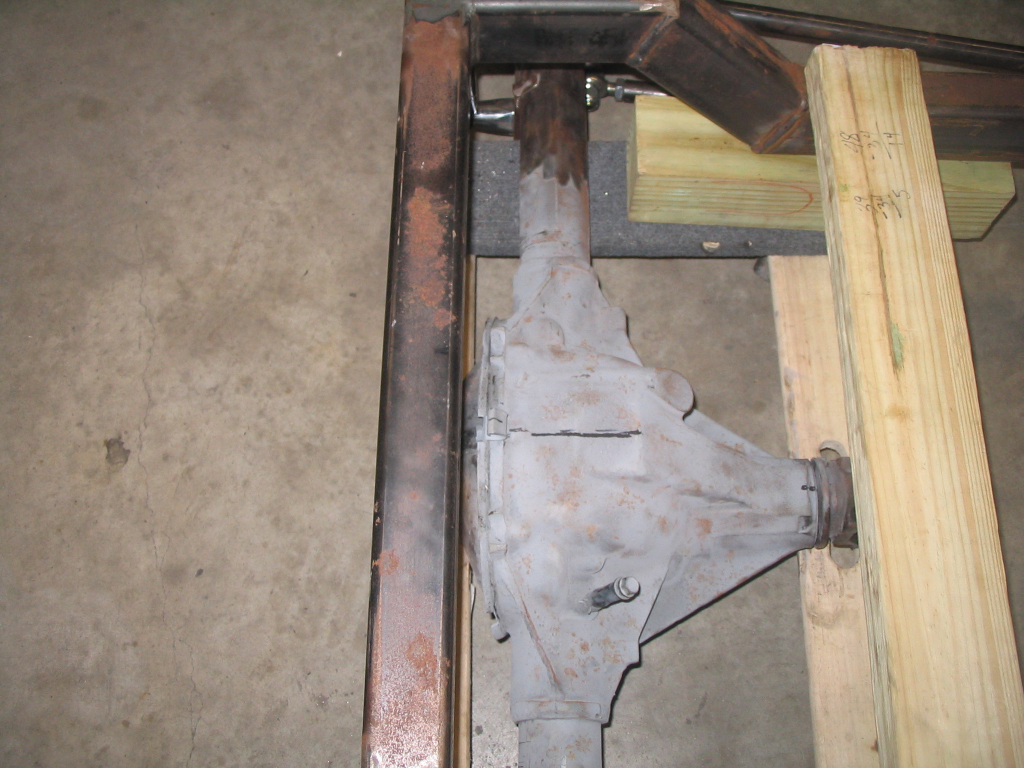

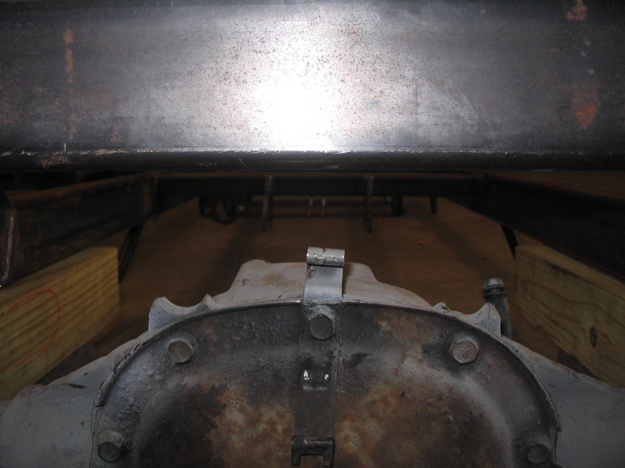

This morning I ordered Ron's panhard bar. As usual, I needed a slight modification and Ron will oblige. CCR's panhard bar is a very nice unit, after some measuring, it wouldn't fit my frame. If you look at my rear cross bar, you'll see how close it is to the rear end housing. I measured about 1". Since my shocks will be 12 3/8" at ride height, CCR's panhard bar just wouldn't have the room to mount correctly and safely. Here's a pic, I'll take a better one later.
Here are the pics of my rear crossbar and rear end clearance.
I'm considering moving my rear end forward about an inch. That should give me a tad more clearance.
Okay, moving my rear end assembly forward gave more clearance, but it also moved the shocks forward at what I consider a bad angle. So, I'm keeping things the way they were and will probably end up using rear shocks with a ride height a little taller. Maybe 13 1/2"
