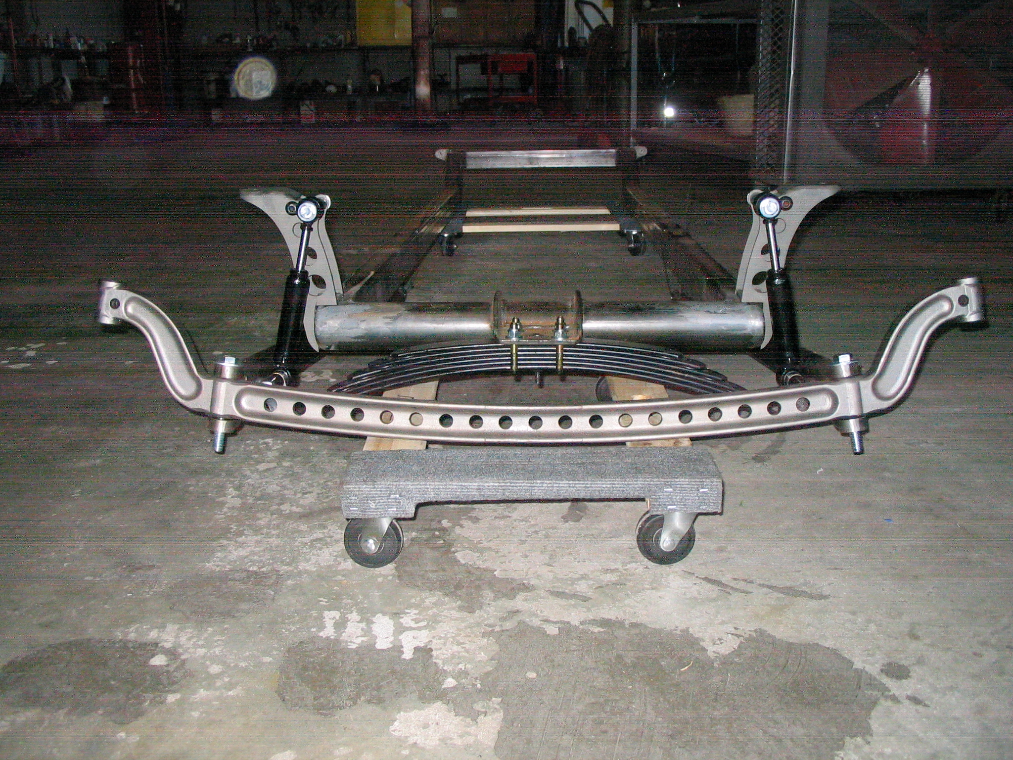

Okay....... it was a nice day (72 degrees) and I was bored, so I broke down and installed the new shocks. This will all come apart, when I change springs, but at least I have practice at it.:D

You need a pile of parts to prevent boredom... How tall are those upper shock mounts/ light perches? When are you going to weld them?

Just an observation, but those look to be pretty stout springs. I know you plan on changing them, are you planning on running 6 leafs? I have seen many with only 4 my big block currently has 5 1-3/4" leafs and I am going to remove another to see if it will soften it up a bit. It was plenty stout with 5, it was a drag car and routinely bounced the front end... I don't need it to do that, lol. Also, it's a standard, so a little lighter than an auto shift. Perhaps that will matter?

Fletch, I was bored because I was trying to have a day off and not do anything car related. But, I couldn't sit still.:) I'm going to weld the towers in, along with other stuff like RR brackets, once I have everything sorted out. The new spring is 3 leaves and rated for 1,000 lbs.. My last T weighed in at 1,750, so I figure 1,000lbs. should work. If it doesn't I'll add leaves from my old one as needed. Here's where my new spring is coming from.

What you got planned for spring bushings? That trailer spring has an odd size hole in it.

I was just messin with you relating to your boredom statement... No rest for the wicked, so to speak. I personally like to tack weld everything in place, then finish weld when disassembled to gain access and gravity, lol!

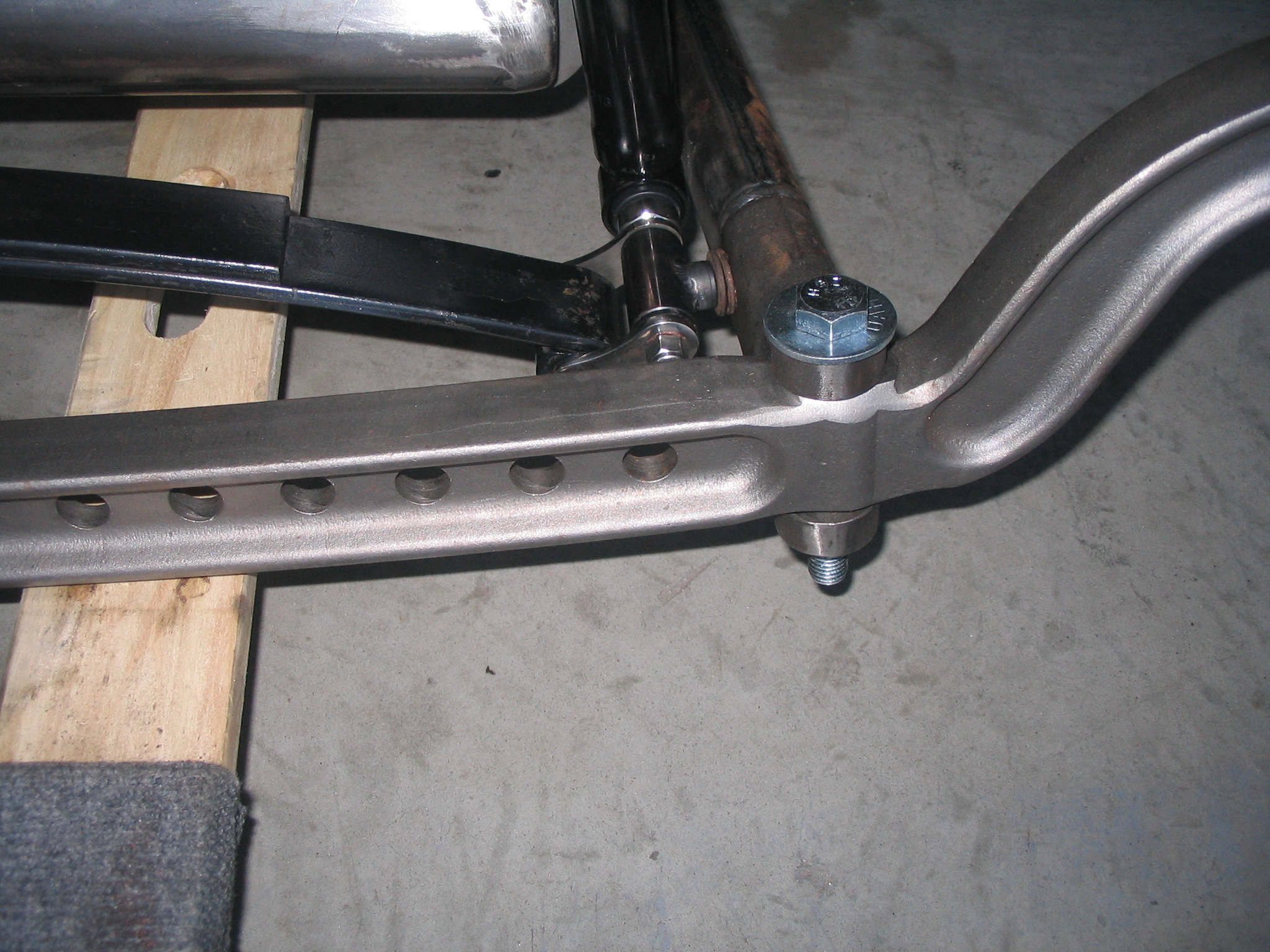

The spring showed up yesterday and I wasted no time checking for fit. All was good. It came with thin bushings, so I removed them and pressed in a couple bushings from my shackles. The fit was close, but way too tight. So, I simply drilled them out a little. VERY little. Here's the result.
Perfect fit.
