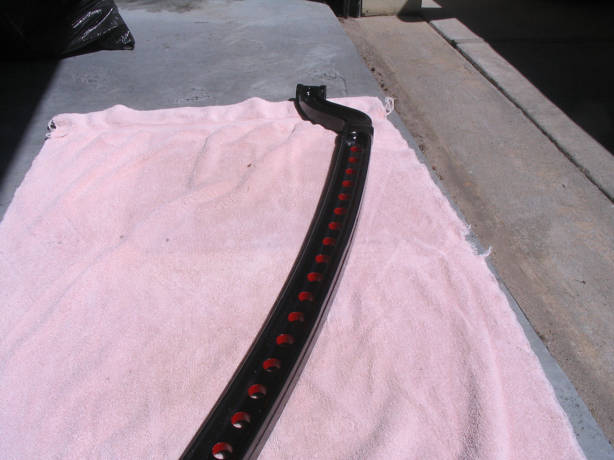

Looks good, no kidding about the back.... I've been doing fiberglass on the body, cowl, under dash, and floor. It's taking its toll on my back with all the bending over and installing and removing the body, rolling it over, etc. I have a fusion anyways, so it doesn't take too much stimulation, lol. I like the subtle effect of the red on black contrast. I look forward to seeing your project take shape.Yea, I like it a lot. Came out like I imagined it. After a few days for the black to set, I suspended the axle between two stools, on it's side. Then, I used the brush and painted the holes from underneath. I was bent over and had to take a break between every four or five holes flip it and do the next coai. I did this yesterday and my back is STILL killing me. LOL

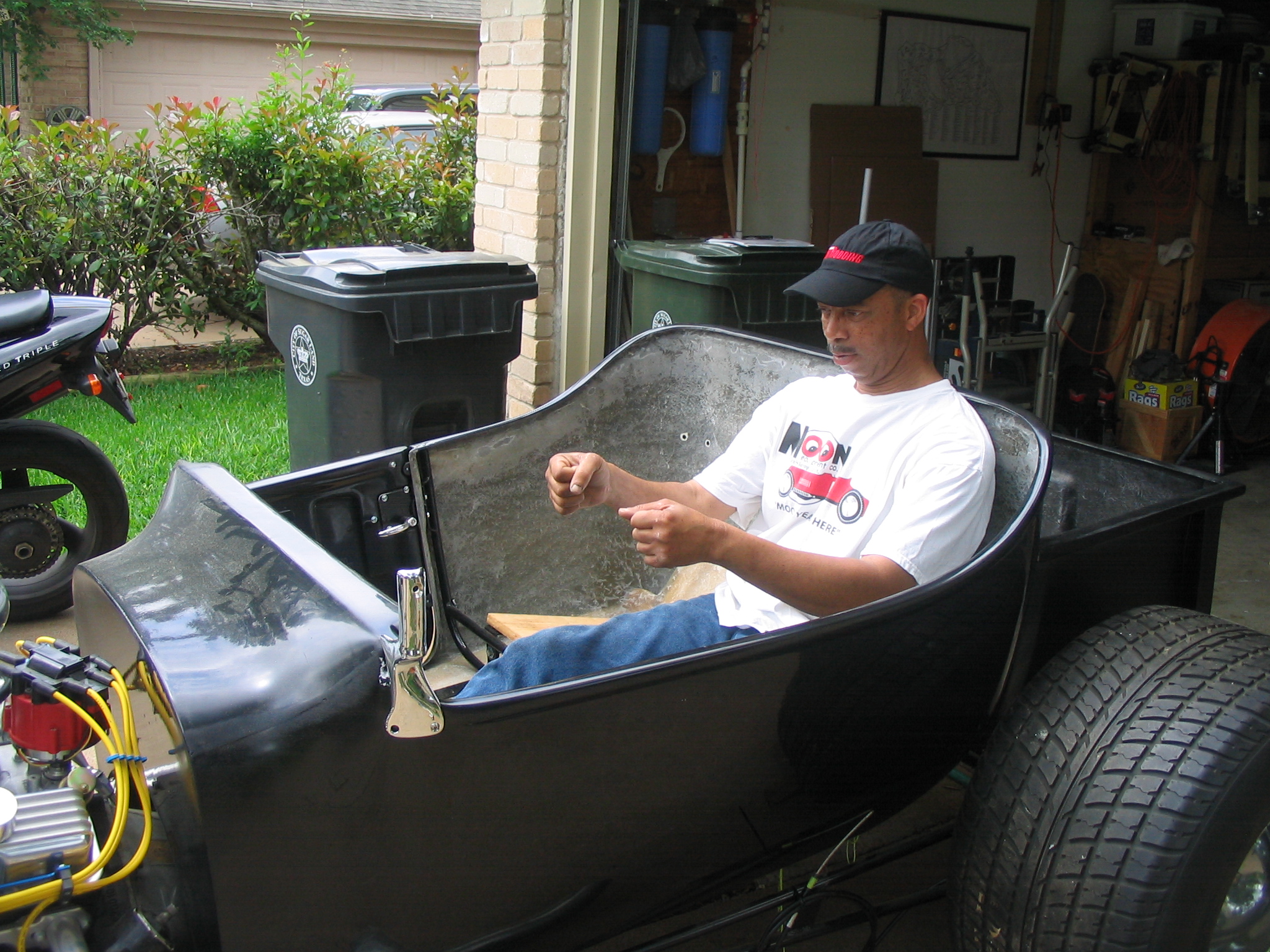

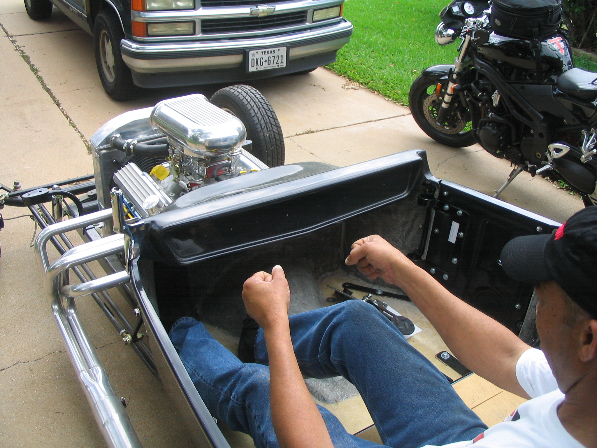

It's amazing how much difference a couple inches makes in these things as far as driver comfort goes. I really struggled with my standard with the controls and seat placement. I would have opted to stretch it, but there was too much to redesign based on the original design because everything was attached to the cross member, lift bars, etc... It wasn't worth it to me, but if I was starting a new project, I would not hesitate.So, this morning, I made my way to Pauls, to get some measurements from his CCR chassis, so I can adapt some of CCR's parts to RPM's chassis. I also wanted to see how I would fit. I was VERY pleased. As you can see in the pics, my legs are straight with a very slight bend at the knee to simulate my feet operating the brake and gas peddle. My arms are bent, but not in the final position I'll have in my build. I'll end up with my arms a little straighter to bring the steering wheel closer to the dash.
CCR's door brace also forms the front frame of a seat riser. It measured about 4 1/2" high. Which from previous experience, works out perfectly. Today, Paul and I had a board placed on the riser rail and sloping towards the back of the body. I'll probably raise the rear of my seat about 2". This will still leave me room for a small fuse box. But if there's not enough room, I'll make a swing down fuse panel and mount it under the dash. CCR's dash is 3" longer than a standard body, so there's a lot of room for that option. Here are pics from today.

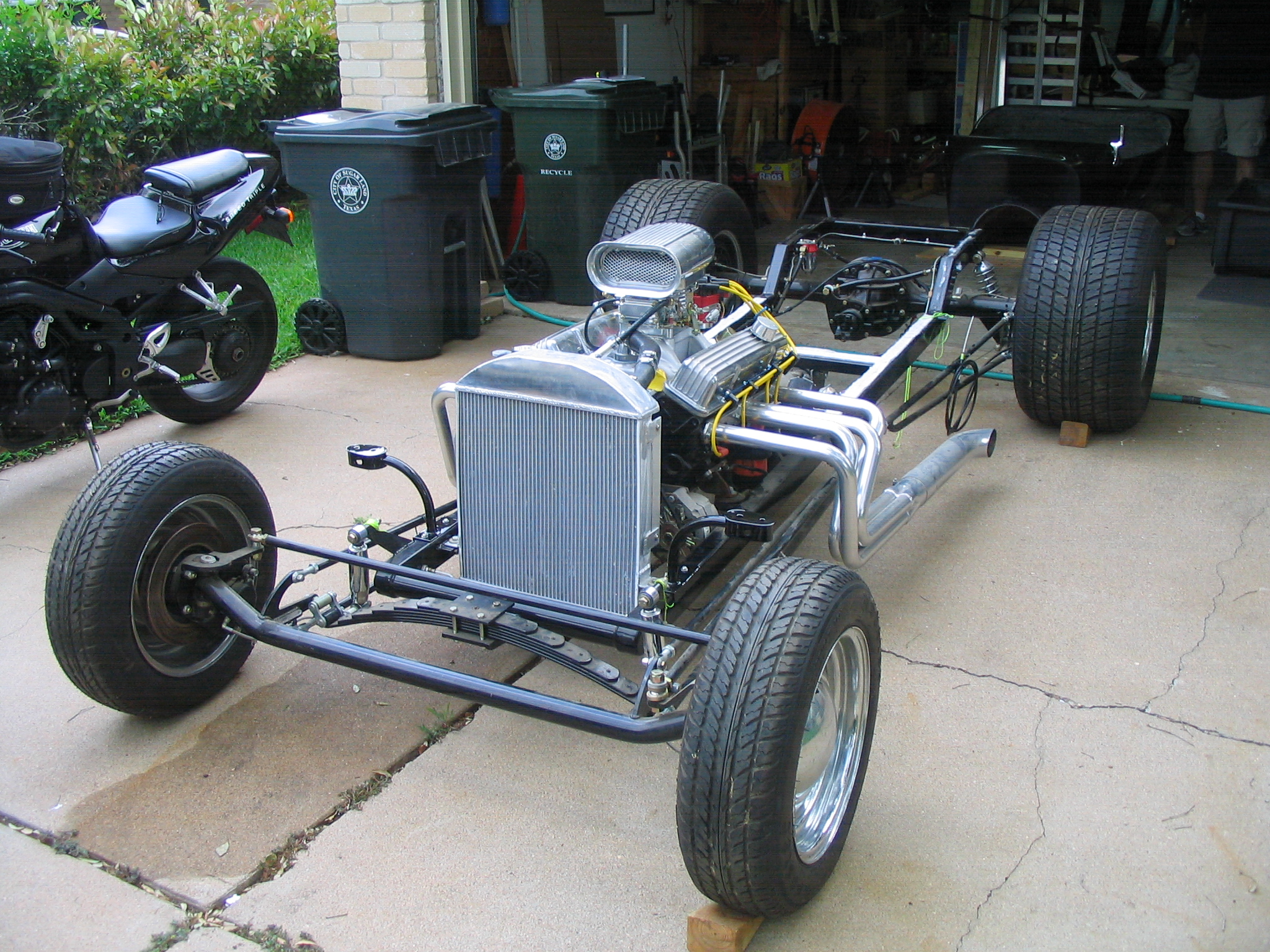

Here's Paul's Bucket. He's moving along at a nice, planned out pace. The slight modifications he made to CCR's plans are really neat, but I'll let him explain them. All in all, today was VERY educational and I got some answers to questions and figures that will help keep my build in the right direction. Thanks again, Paul, for a very pleasant morning. Check out the headlight stands he made!
