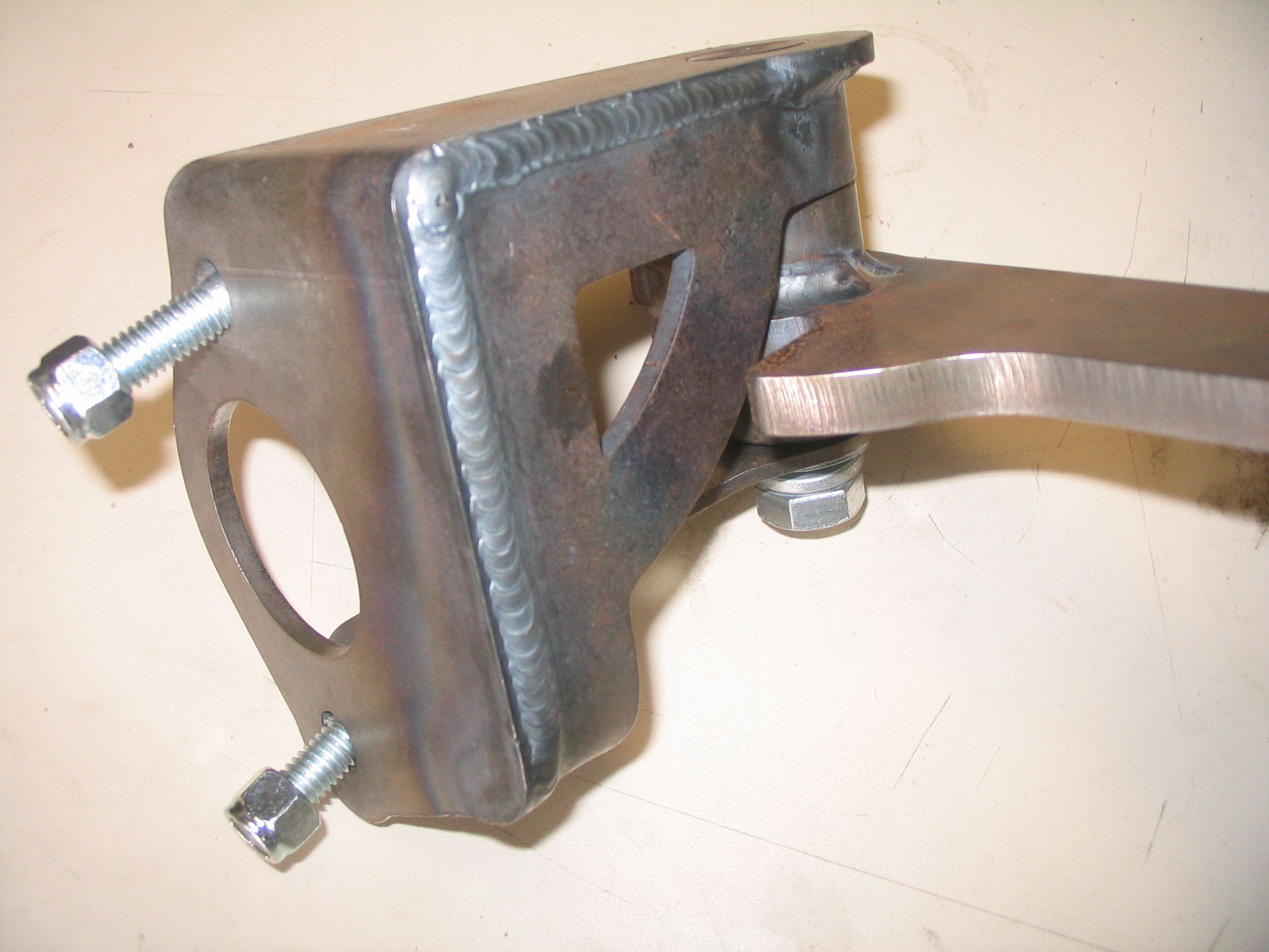

Brake bracket welds. Also, notice the pedal arm has that "stop" to prevent from moving back too far.

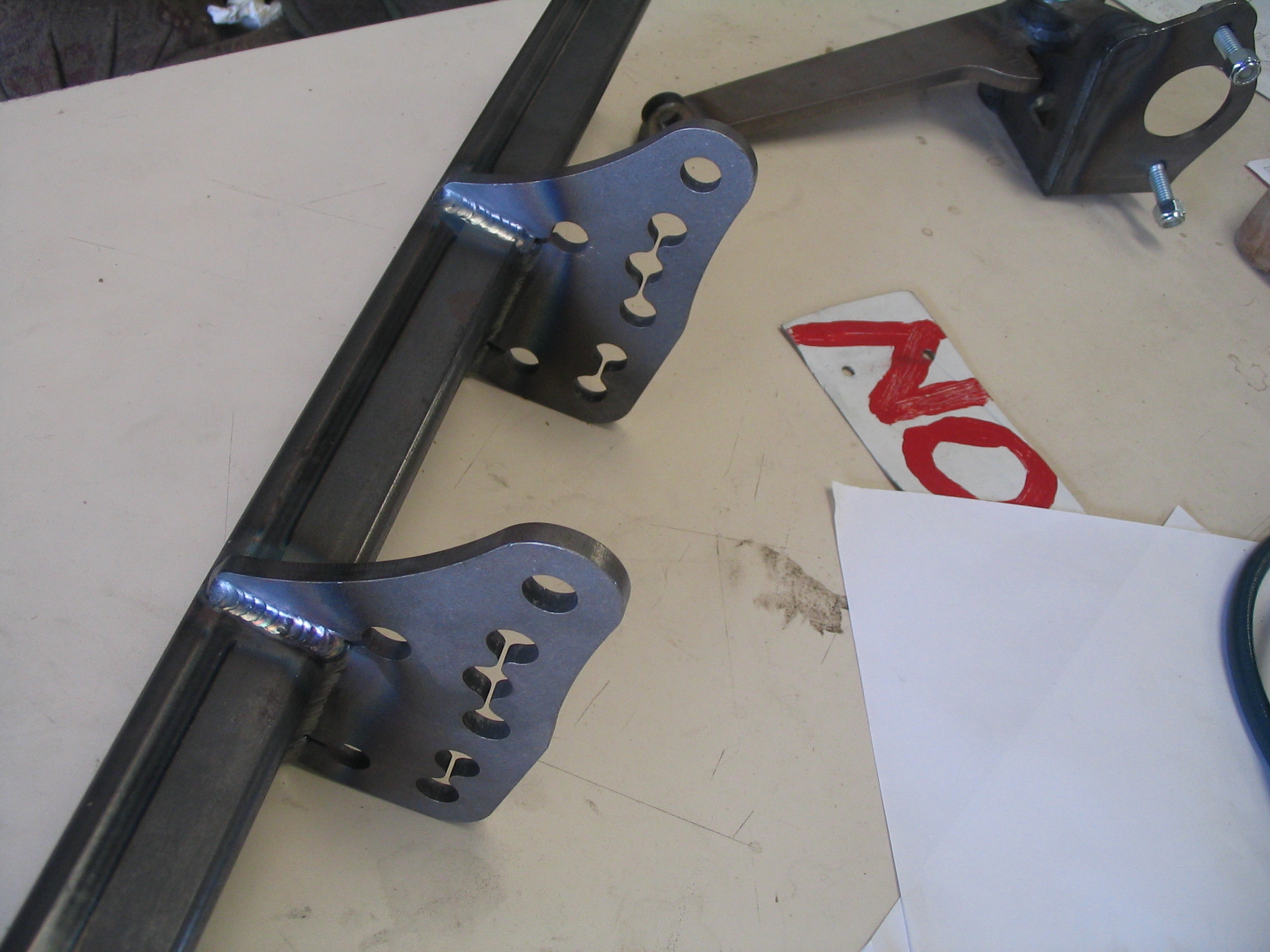

Cross member/trans mount.

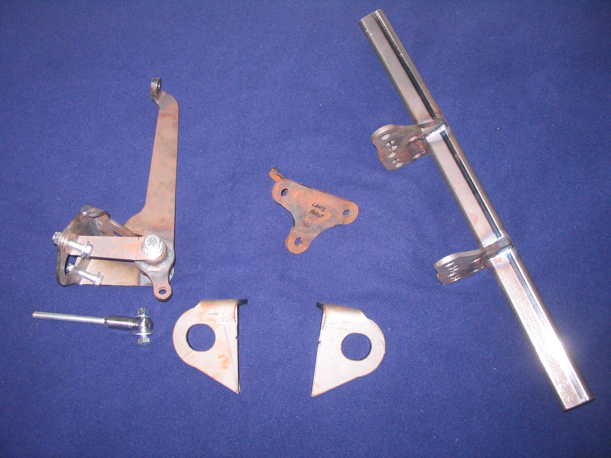

Parts porn.

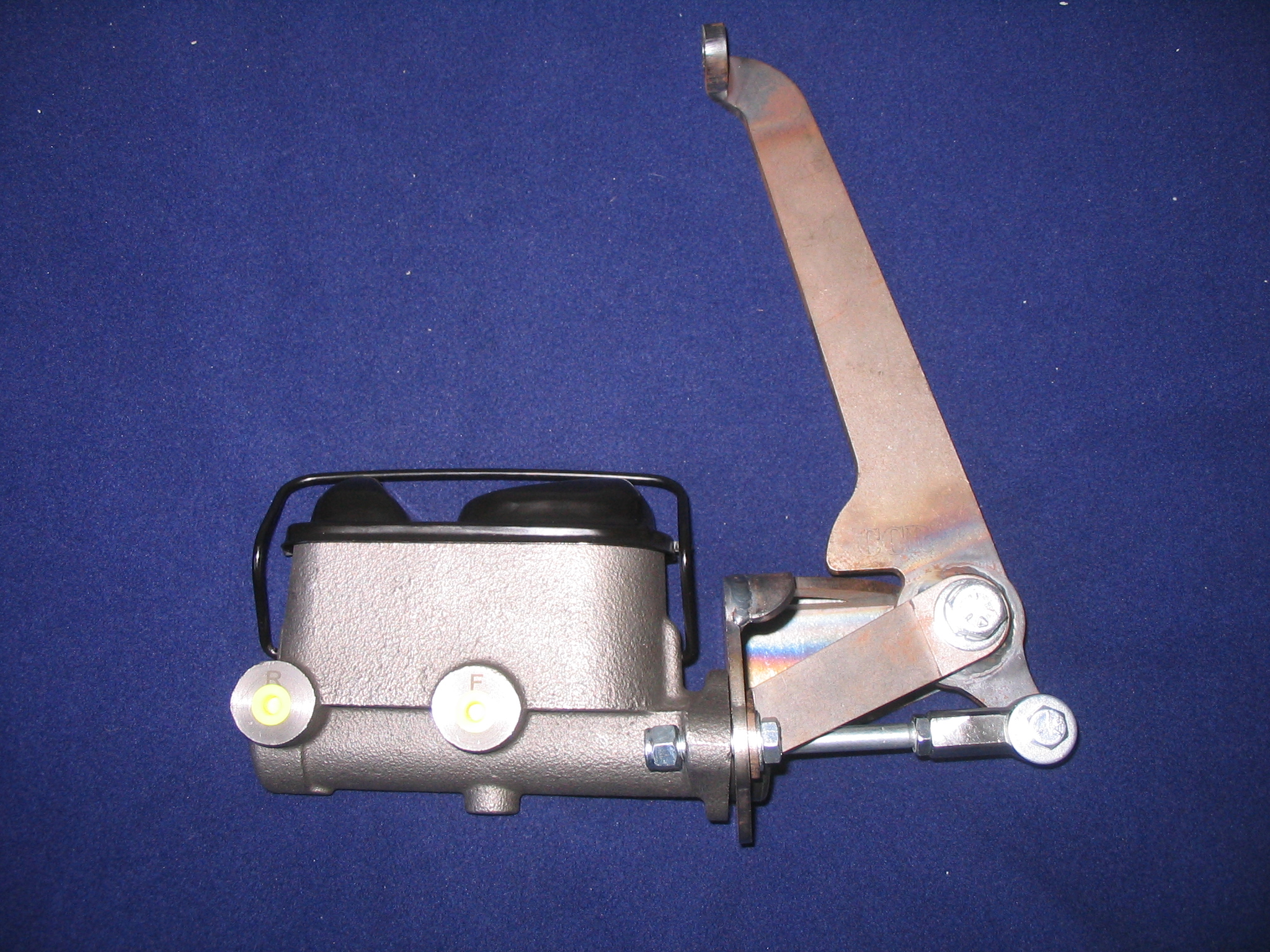

The master cylinder arrived today, so I mocked it up.
Looks like you should have plenty of leverage on the pedal. Same m/c as I am using.
It's always looked like a good set up, but I still shopped around. When I saw Paul's, the deal was sealed. The push rod that came with the CCR set up, is a lot better than the one that came with the master cylinder. That's the CCR push rod in the pic.

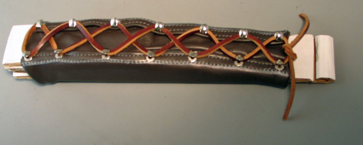

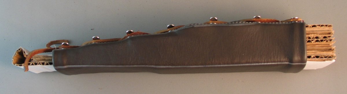

Okay...... back to my bucket stuff. I'm always researching and keeping an eye out for little bits that can be tossed into my mix. Well, a couple weeks ago, I discovered leaf spring wraps. Back in the day, wraps or tape, was used to keep the grease in between spring leaves. I was on the HAMB and found a source for these. These pics are of the wrap on a cardboard mock up. They've got a tongue on them and lace up, just like a boot.
Do I "need" them? Heck no. But they're cool and different.:D I'm ordering a pair for my front spring. In black, of course. I'm going to mount one on each side of my exposed front spring.
Now I know what happened to my pole climber boot tops. Those are pretty good looking covers. I think it beats the heat shrink that I have seen on some. Good find, Fred.
