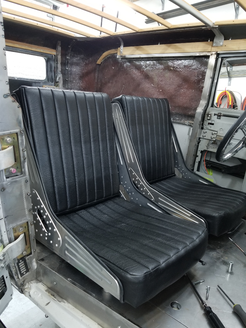

I just did a set with plywood bottoms, no webbing. Forget that, use webbing. That set is now out waiting for tomorrow's trash pick-up. Here's a picture of the Rotten Leonard ones that I just finished for my Model A. They have Mazda Miata bottom frames and foam on plywood backs. The backs will probably be changed to webbing or something else later, they are a little stiff but will do for the moment.

I just bought the 4 sides from Rotten Leonard and added my own seat bottoms and backs and then did my own upholstery so I don't know if you can modify his completed seats or not.409, I've seen the bottom of Leonard's seats and it appears it could be cut out and webbing added. Does it look like an option?
Fred, the "rake angle" of the back of the seat is there for proper comfort. An engineer once told me that the preferred angle should be about 22 degrees. My seat has the backrest at 25 degrees from vertical and the seat bottom at 15 degrees from horizontal. My wife, Nan, and I have spent many pleasurable miles in that seat with a great deal of comfort. Considering the we are both in our mid seventies and we both have arthritis I consider that a great recommendation for a proper seat build.
