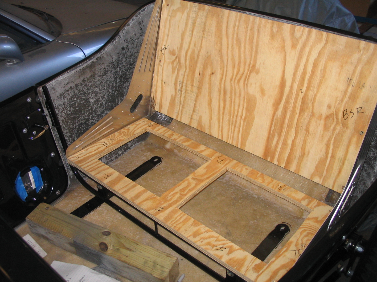

Hey Tfever, CCR has a DVDs with pictures of there T's in differant stages. There is some pictures of the interior and the wooden insert they use. May be of some help.
Hmm....... I'll look for it, thanks.

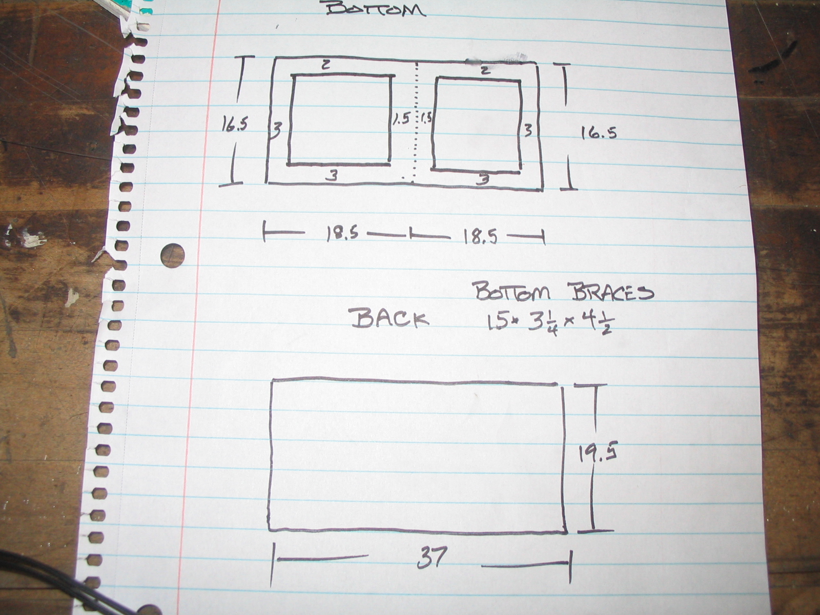

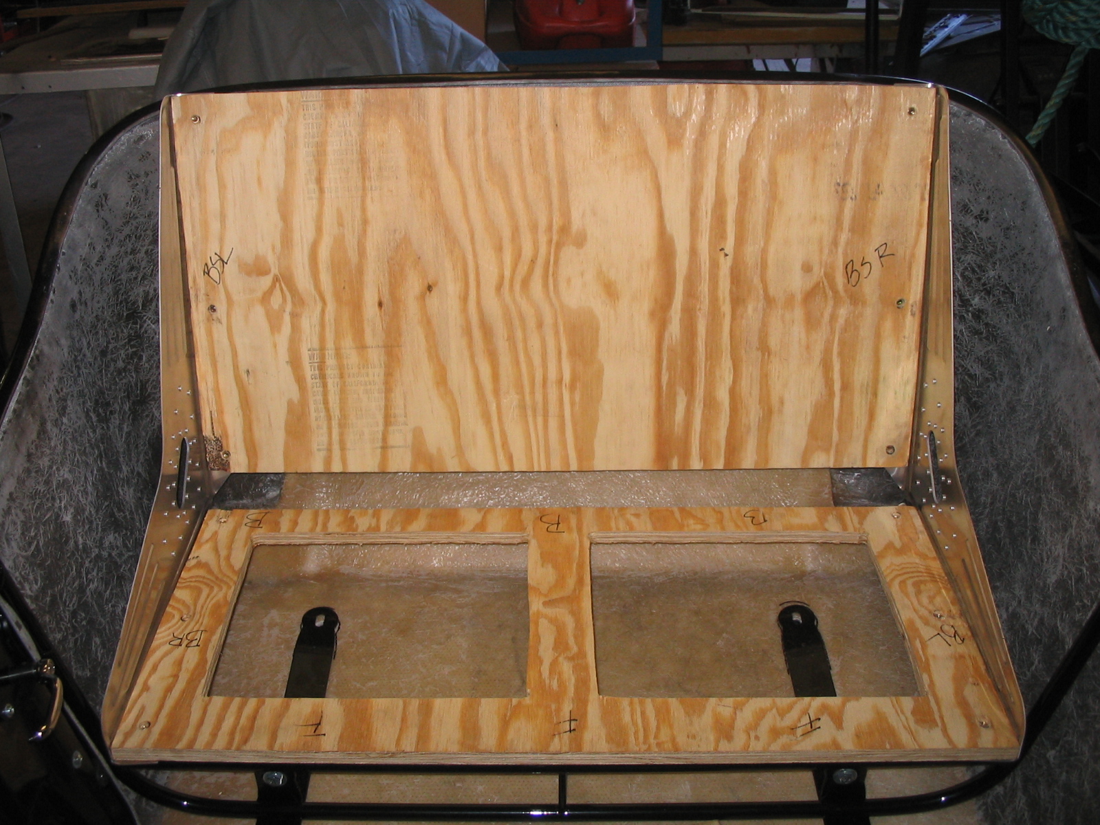

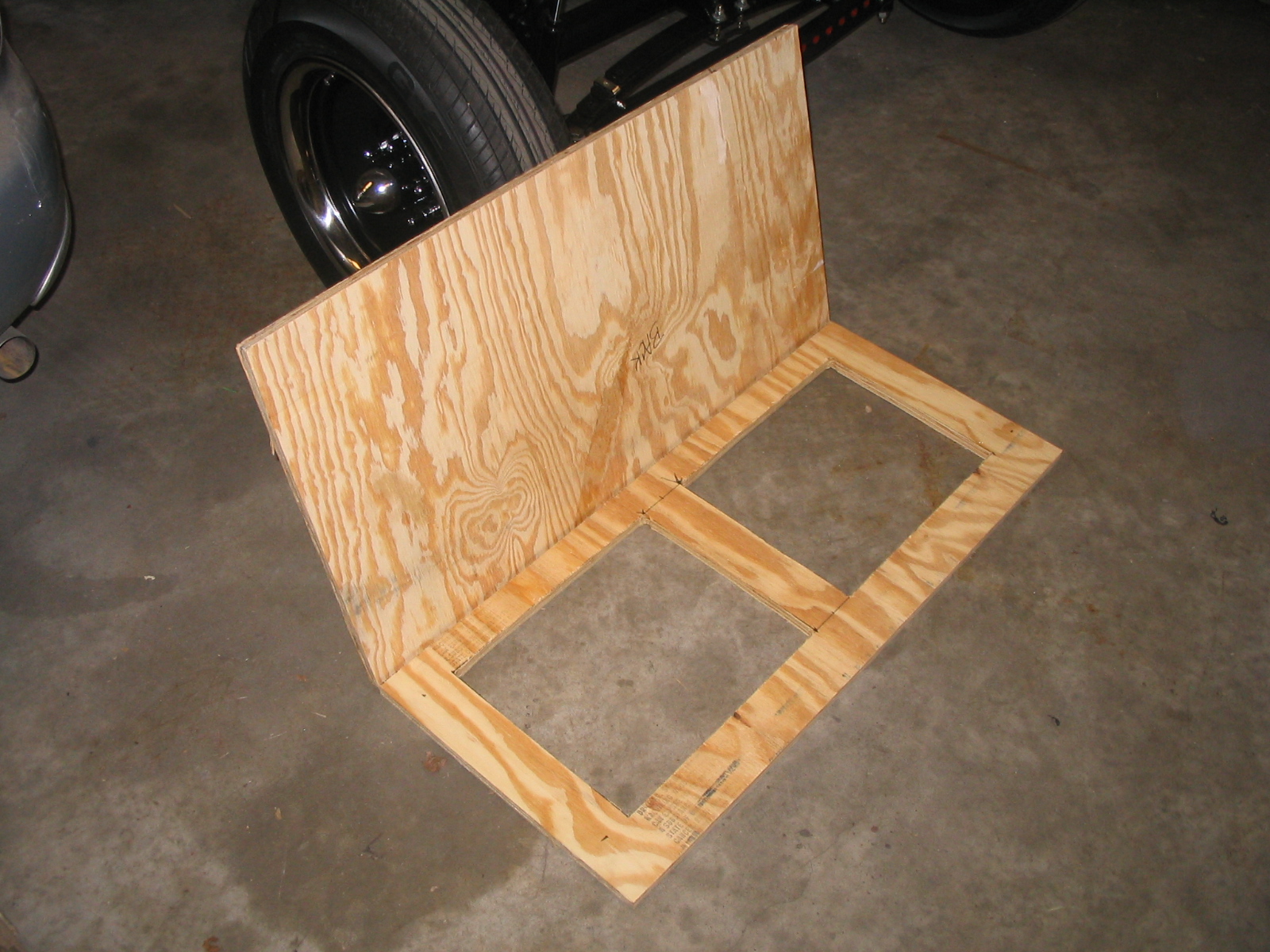

Sounds a lot like Frontline Freight.That's great, but I didn't have that option. Personally, I would have used UPS Freight. At least it would have tracked better than what these yo-yo's have. Oh well. Right now, I'm concentrating on my planned interior layout. There's no sense wasting energy on these assholes. But from now on, I'll request UPS and pay the difference, if there is one.
